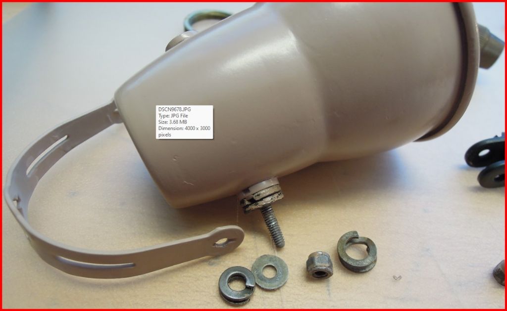

      I have many frustrations in life but one that comes up again and again is the time it takes to find just the right part on the web to help make the perfect repair.
      Todays 'waste of time' involves the search for some double coil spring washers for the lamp unit on my Meteor drill grinder.
      When I enter this term into google I get tons of irrelevant rubbish. I thought the way to be more specific was to put the key words in inverted commas. When I do this I still get tons of irrelevant rubbish including 'single coil' washers which I'm not interested in.
      So my question is: how should I refine my searches so that I can see only sellers / products that I require ?
      (Specifically I'm looking for a double coil spring washer with a bore of around 3mm. These don't look to be too popular (hence the mess on my grinder, probably) but I feel someone, somewhere, must have what I need.)
      Gerry

          Search for "Imperial Double Coil Spring Washers Thackery" on Ebay.

            These are the smallest I could find after a 5 min search:-
            ebay 9/64" Thackery Washer
            Not listed directly on BA Bolts Ltd website (that I could find) for some reason though.
            All I did to help refine the search, was to add M3 to the start of your "search term", but still had to sift through quite a bit of dross.
            Edit:- found the listing , but still does not include 9/64"

              You could try searching for 6BA ones
              https://www.ebay.co.uk/itm/324951181485
              I often search in Google, when I'm not sure of the exact description, but search on "Images" rather than "All"
              Obviously this then shows a series of photos, from which it's often possible to extract other useful search terms.
              e.g. a search for "Double Spring Washers", shows several photos including the word "Thackery", so you can then add that to the search box to narrow the field a bit; similarly you might even find the BS or DIN number.

                Hi, what you need to search for is double coil rectangular section spring washer Double coil spring

                      I have original imperial unused blackened Thackerys of 3/16" bore in my stock if they would help?.

                          I tried googling "types of spring washer" and found this site with a good selection:

                                    Update for Gerry …
                                    I have just tried a Google search for:
                                    spring washer, double coil
                                    [exactly as that ^^^, with no quotes or other tricks]
                                    Loads of results, many with pictures
                                    #641585
                                    William S
                                      @williams
                                      Type- 6ba ( 1/8” ) Double Coil steel spring washers x 10 in to eBay and a listing for what you require should appear
