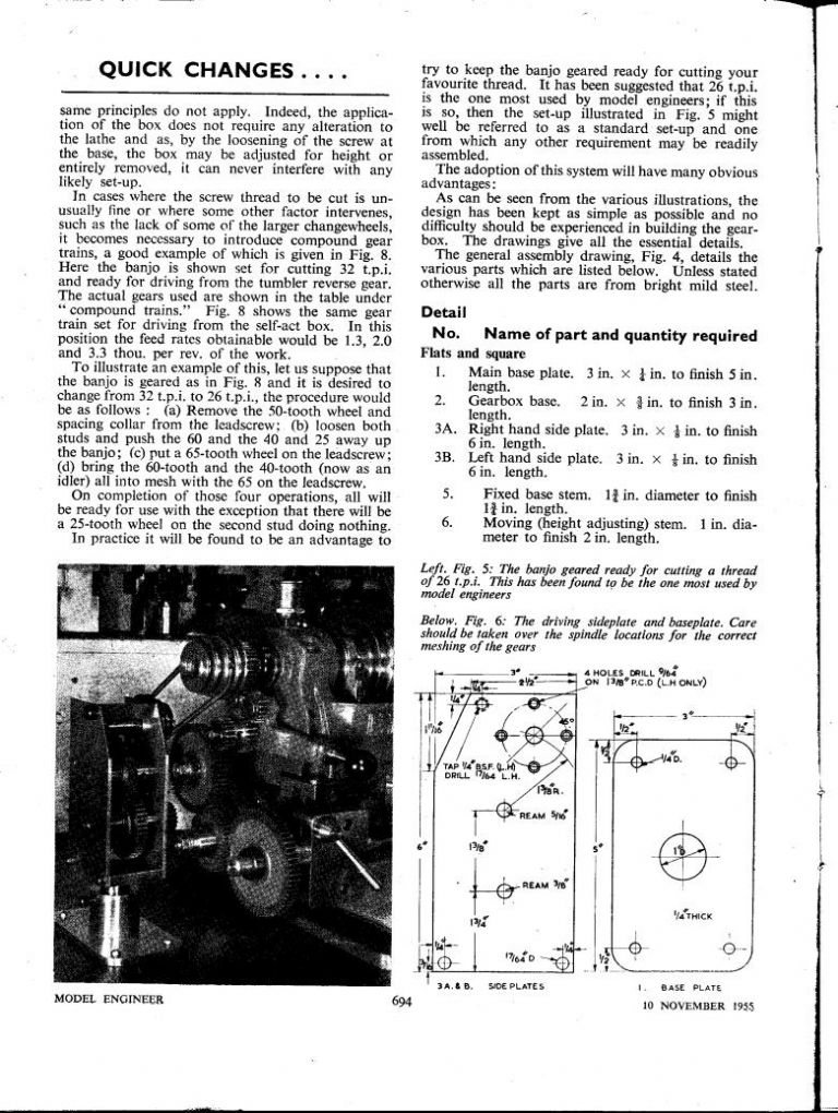

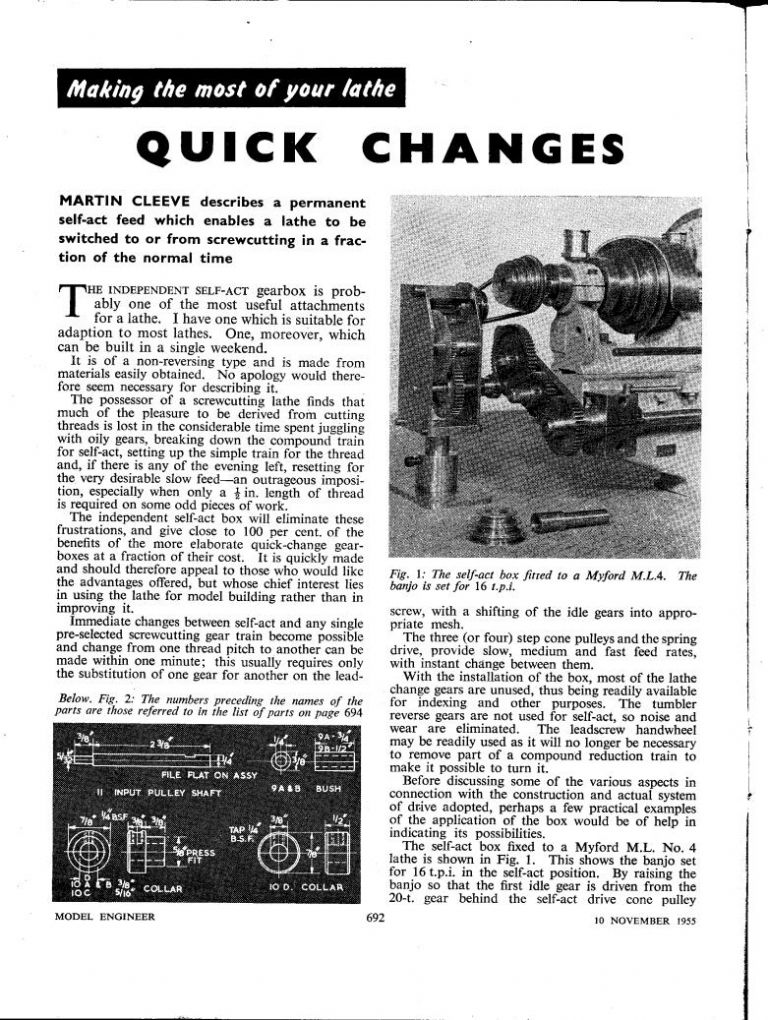

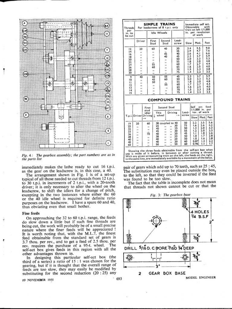

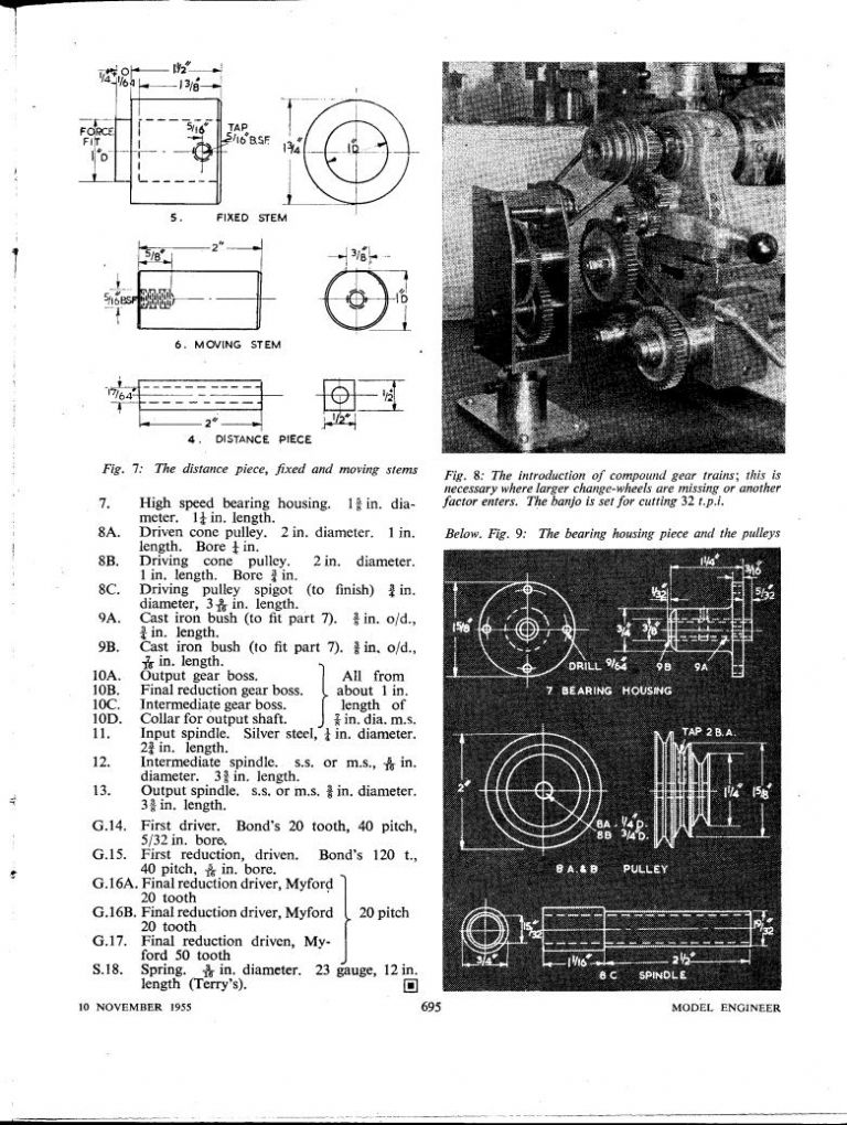

          Unfortunately this device was never written up in full. If anyone can scan and post better quality versions of pictures in the Martin Cleeve article, I'd be grateful.
          Better still, does anyone know the present location of his lathe?
          Finally Martin Cleeve's book 'Screwcutting in the Lathe' is available HERE

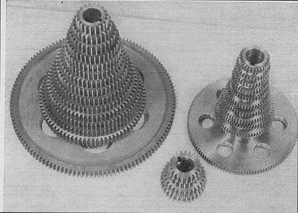

                There isn't a lot new in this engineering world except materials and electronics or a combination of both.
                The Hardinge system has been widely copied and used by other makers. Monarch and CVA had a very similar arrangement but did not publicised it preferring to call it the forward and reverse gear clutch but being inside the headstock and a single dog clutch it worked exactly the same way.
                Where the Hardinge and the Monarch systems were concerned as regards many later inferior copies is that they were inside the headstock, hardened and ground and lubricated making them a real work horse.

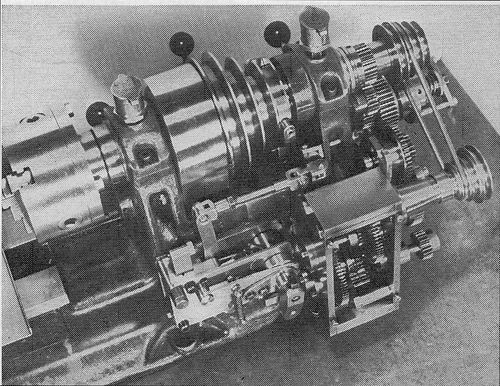

                    Does anyone know what the arrangement is / was on the back driven by the round belt from the spindle?
                    Second pic in Michaels post.
                    Also seen it asked here and also been asked before but what happened to this lathe ? Does any one know for sure ?

                      Posted by John Stevenson on 22/02/2015 22:34:29:
                      John,
                      Vague recollection of it being a Fine Feed arrangement … But not certain.

                      Now, does anyone have ME for 10-November-1955 question
                      Edited By Michael Gilligan on 22/02/2015 23:05:20

                          You have an email, Michael.
                          Edit – not the most elegant solution…
                          Edited By Neil Wyatt on 25/02/2015 08:29:51
                          #181089
                            Thanks, Neil … Much appreciated.
                            Agreed it's far from elegant … but I suspect that there's the germ of a good idea in there.
                            Replace the outboard gearbox with a bit of electrickery and a stepper motor ?

                                  John and Michael,
                                  To answer your question, in Cleeve's book WPS 3 'Screwcutting in the lathe' he describes the rear mounted drive using the round belt off the spindle as a permanently available self act gearing running at approximately 1/10 spindle speed.
                                  It is brought into engagement with any gear train assembled by lowering the quadrant onto the small pinion extreme bottom left in the last picture that Michael presented
