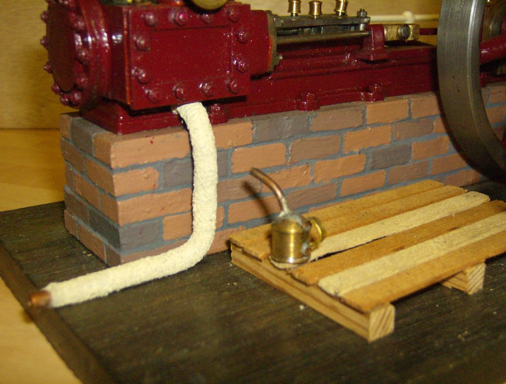

                At 1/12" I used string and a thick dose of white paint*. The end result my be a little fuzzy for some!
                *Look closely at the picture and it will be clear I don't understand the concept of thin paint…

                #131610
                jason udall
                  @jasonudall57142
                  Love the scale pallet
