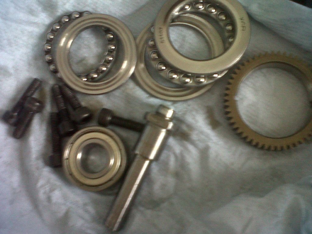

      Here are some gubbins i managed to get out of an old asda pressure washer, from around the motor and gearbox section..
      So, some decent M5 socket screws from the aluminium casing, a 10mm-ish steel shaft that could be turned again, a large ball race and some open face bearings and a steel gear, not quite sure what they could be useful for but anyone is welcome to post their findings too or any ideas with what to do with them.

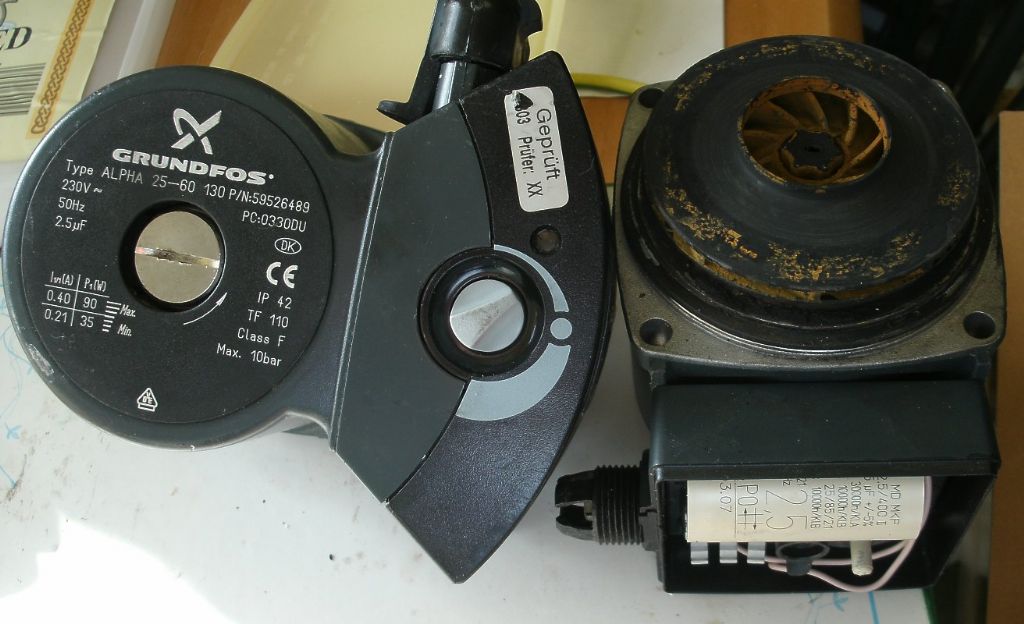

          I was just about to ask re a number of domestic heating pumps obtained from my favourite scrappy
          all are same maker though different in small details – though I can find the manufacturer's documents they don't state the spindle speed nor how to get the pump rotor off the shaft – has any one else found a use for these small c 90W motors ?

                  they are all 240V a/c motors with a 2.5uF start capacitor – 24Vdc would have been very convenient (tho did pick up a 12V window winder)
                  I’m away from my workshop so can’t check speed but my guess is nearer 600rpm than 6000! so somewhere there is probably a gear once I work out how to get the pump rotor off

                    Frances, if run dry these motors get very hot, much too hot to touch and if you put water through them in that state they will flash to steam.
                    You should be able to slide the whole rotor and impellor out of the housing but they can corrode but don't think you will find any gears, speed control is all electronic
                    make quite economical pond pumps

                      I’ve just been running one for maybe 15min – yes it get slightly warm but not hot at least as felt on outer case – 2 are switchable between 3 speeds – it seems by switching windings – they run v quiet when pump rotor is in vertical plane – when in horizontal there is some noise that might be gearing – are they not sealed from the pumped liquid ?

                            I'm sure that the bearings on the ch pumps are water lubricated which is why they are not sealed from the liquid. I doubt if they will last long being run dry. As Jason suggests, they can be used for pond pumps but are not self priming. I've never found them to last very long in that application though.

                              Hi Frances, your C/H pumps are not really much good for anything but circulating the water in a C/H system. As has been said, yes they need the water in the bearings for lubrication and the bearings a very likely to be ceramic. The coils and the electronics are totally sealed from the water, but the rotor and shaft continuously run in water and that's the reason for the big screwdriver plug on the back, so as to be able to remove any air inside to insure they are full of water. There are no gears inside, the impellor is fix directly onto the rotor shaft and they don't run very fast and if they pump very dirty water they will soon jam up and burn out, which is what happens to most of them in C/H systems without any anti-corrosion additive. They won't even pump a very high head of water either. Never tried them as coolant pumps, but if you do, you'll have to keep the coolant free from even the smallest size of swarf, especially ferrous metals.

                                Every year before I start my heating system I undo the plug and rotate the spindle and it does sometimes feel very gritty to turn. It all runs fine after that. They are not very powerful and only push the water at a low pressure. You might have to split the impeller boss to get it off.
