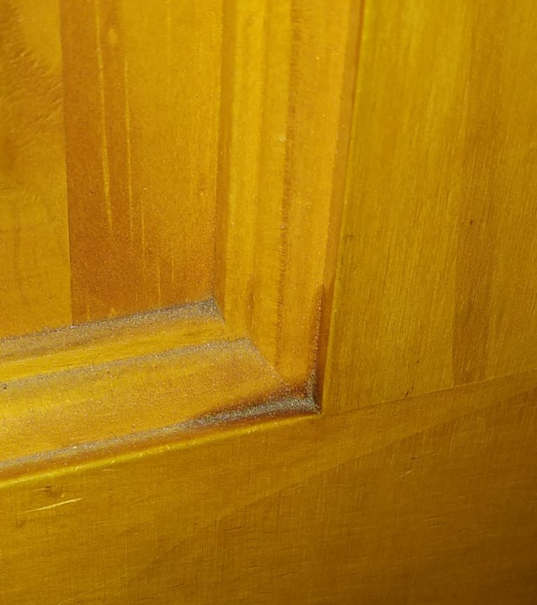

      This is a woodworking question, hopefully the tea room is the best place for it!
      What are the routing cutters called that round an edge and then create a mirror of that edge so the two parts fit together.
      The photo shows, I hope, what I want to do, get the routed (molded?) edge to run around an internal corner.

              John, I think you are looking for scribing cutters. The rails of a door might be scribed over the matching moulds on the stiles ( side uprights) which fit under the rail uninterrupted.

                The generic search term is 'stile and rail cutter'. As suggested, Trend's or CMT's catalogues will give you a good overview of what is available.

                      A "scribed moulding" is what you have there and as has been suggested you need a suitable cutter set. Several profiles are available, and depending on what you're doing after, a "raised panel cutter" may also be required for the centre panel.

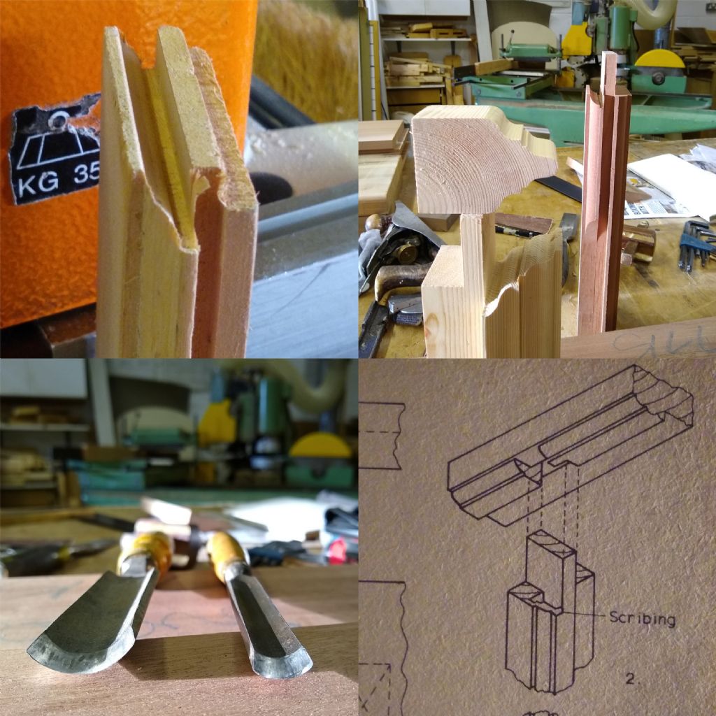

                                    Basically, scribe the tenon shoulder over the moulding, as others have said.
                                    Top Left shows the kind of joint produced with the scribe and mould cutters, as Jason linked to, which creates a stub tenon which fits into the panel groove. This relies on the glue holding the joint together, great for cupboard doors, no use for house doors. (This was done using Spindle Moulder Cutter Blocks).
                                    Top Right shows through scribed joints, the Sapele one was done on the Tenoning Machine in the background, the Softwood one by Bandsaw/Hand Tools.
                                    Bottom Left, the kind of gouges required to create scribes by hand, are the in-cannel type, i.e. inside bevel.
                                    Bottom Right, when scribing wide rails on Doors etc, if doing it by hand you only need to scribe ½ inch to 1 inch say, the remaining shoulder can be left square, and a section of moulding chiseled away on the stile, similar to the drawing, which is of a frame.
