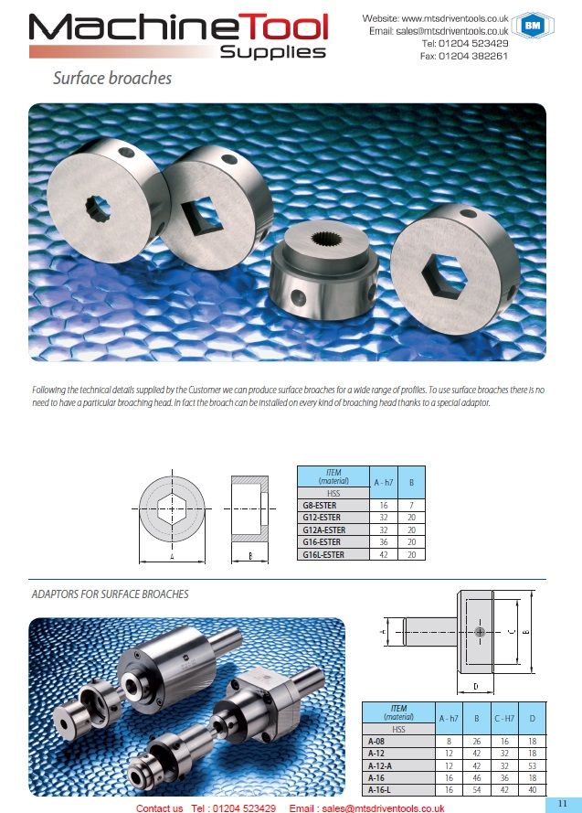

        My question is, does anyone use or have made a broaching tool for making an outer shape, like putting a hex on a part instead of trying to set up the mill and cut the flats required on the part?

                        I made a rotary broach some time ago for internal squares and hexagons and engraved the face to tool tip length on the body. This is the null point which is important. Outside rotary broaching is very rare, I had never heard of it before this forum. External shapes are usually produced by milling or with a fly press.

                          I, too made a rotary broaching tool after the style by Mke Cox although I used a redundant revolving centre as the basis. A few photos in this album. I made the broaching tools out of silver steel, hardened then finish ground using a Stevenson end mill sharpening ER fixture to obtain the angles (only because I had one). A Google for ready-made broaching tools got me to this UK-based supplier with the following page in their catalogue:
                          external broaches
                          So it appears that they are certainly available. I dread to think what the price is, though. It's one of those R-R type catalogues – "If you have to ask the price – you can't afford it".

                            I like Neil's idea with regard to the design of an external broach. I have a number of components to make that will have a 9mm AF hex, worth a try I think.
