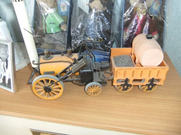

                            This one has never been run since I have owned it or when my late father had it as he got it directly from Hornby when he worked for the company.
                            I do have all of the bits to fire it as well as the instructions but no track. I may be tempted to fire it up one day. You can see the gas control at the rear of the boiler.
