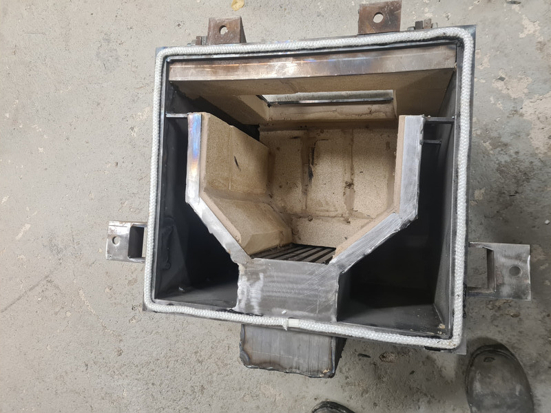

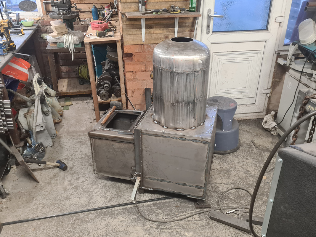

      A while back i had a go with one of them  cheapo chinese diesel heaters. Not much use to be honest and costly to run.
      So as i built stoves in the past i thought to build another and then came across these Rocket Mass Heaters. Much better on heat output and consumption on fuel. Being wood only a sit burns from the top and not below.
      Tis build is same but different as with all these heaters, they work in a similar way a sin ait fed from above into the combustion chamber and has a vortex tube to the heat exchanger.
      They burn smoke free and on a lot less wood than a normal wood stove due aswell as the wood burning it also burns off the gasses in the second burn.

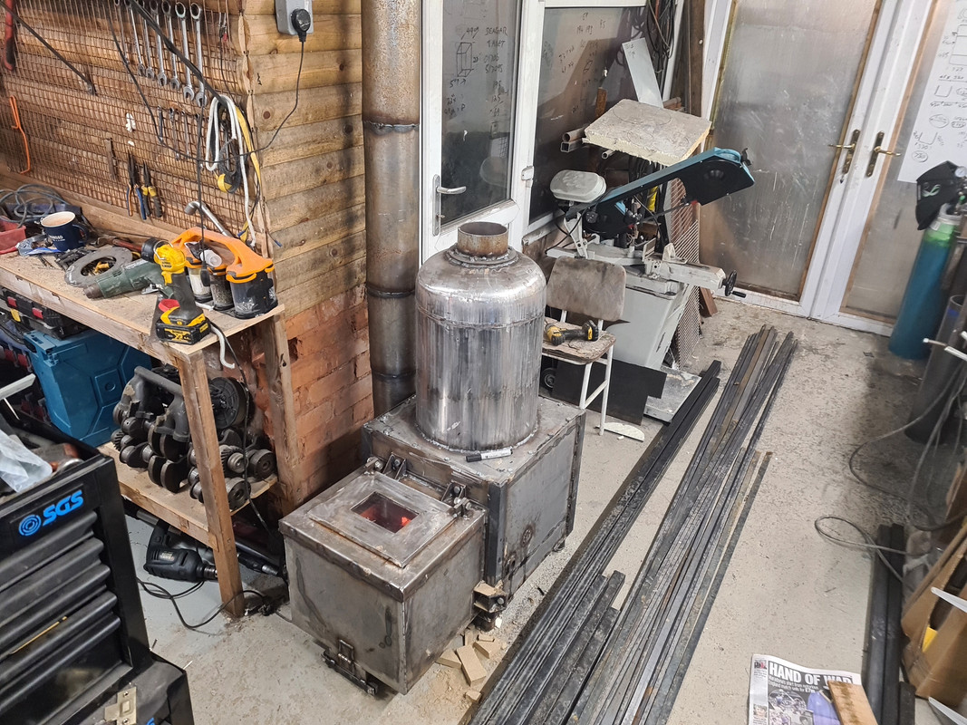

      My no means is this the best set up but works well and give off enough heat to warm 80 cubic meter workshop in well below freezing outside temps. part insulated workshop.
      i dont have a full build of how i did it but i hope you will get the idea.

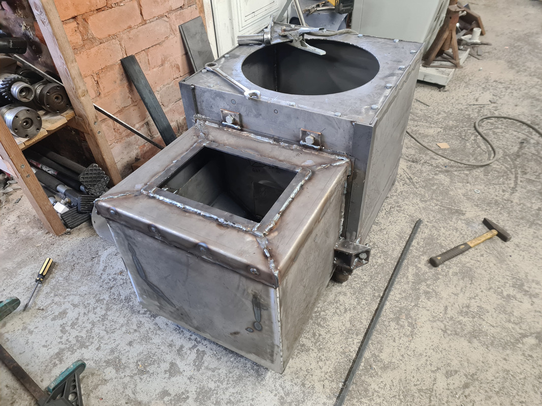

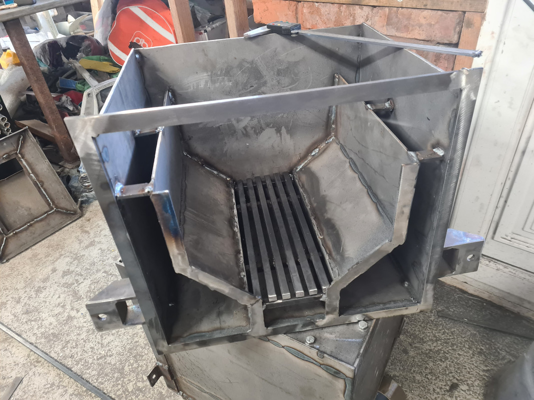

      roughly 50cm cube exchanger box with part of a 47kg propane cylinder on top. and a 40cm box burn box.
      5mm all around for both fire boxs
      heat exchanger box
      Main fire box
      I dont think tis is a great deal of differance but the combustion air is drawn from the back and below the main box. this is to pre heat the air. the as it enters the fire box it is drawn down as wood burns from above as coal is from below.

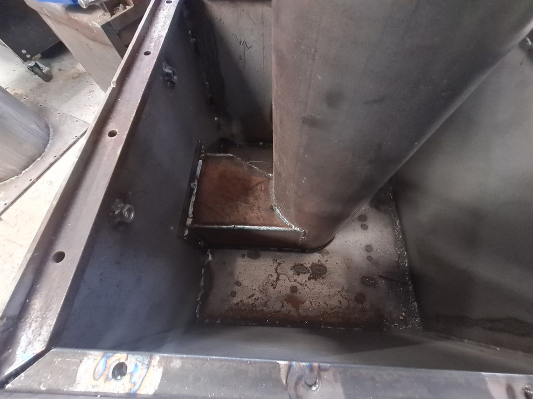

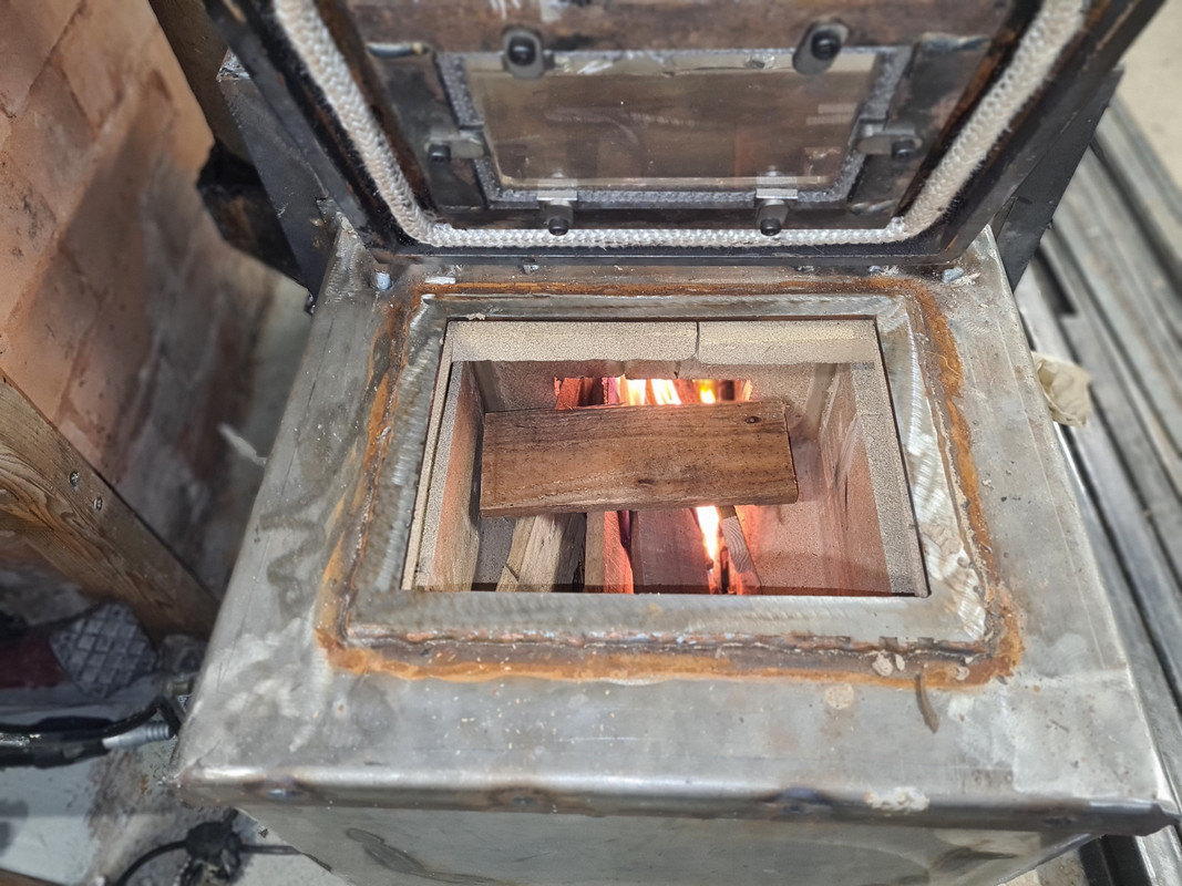

              Its best to build a riser tube from fire brick but after numerous failed attemps and it costing to much i used a length of mild steel tube. it has lasted well for two winters. but then it doesnt take as much temp as some of these heaters do. max temp i have had is 495 degC. as said its more than enough.
              The riser is connected to the fire box by the second burn corridor. this has a taper to create the vortex needed to give the second burn fed from the combustion inlet aswell.

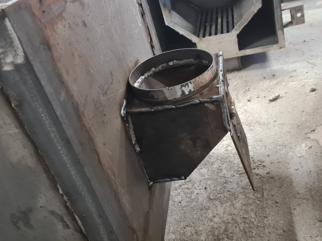

              rear of the combustion chamber is the flue exit. including a cleaning door.

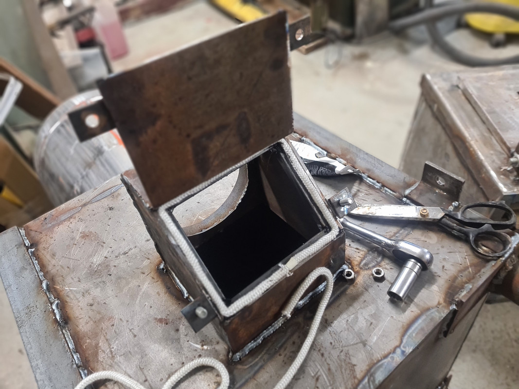

              with added fire rope to seal it.
              sealed and lined the fire box,
              also the door to the fire box
              completed and with either a viewing glass to see the vortex or a crucible pot, which i have yet to test. made it for lead and i am wondering if i can do some copper wit help of a blow torch and the exctractor i have to set up for fume extraction..

                not best vortex but that half burn

                  An interesting if not rather complexed design involving a great deal of work to squeeze the last ounce of heat energy from the fuel ! In terms of size rather too large for most small workshops, certainly my 12′ X 16′.  Your mention of melting lead, Yes it should be possible, MP 327c. but copper at MP of 1083c is very doubtful. In terms of colour it is yellow+. For casting you will need a pouring temp of approaching 1200c, almost white heat. Any steel in proximity of these sorts of heat will be plastic, having little strength. You have shown your skill in welding and fabrication, if you wish to try foundrywork build a proper furnace – it will be easier than this fire ! If you wish to discuss this matter PM me ! Noel.
