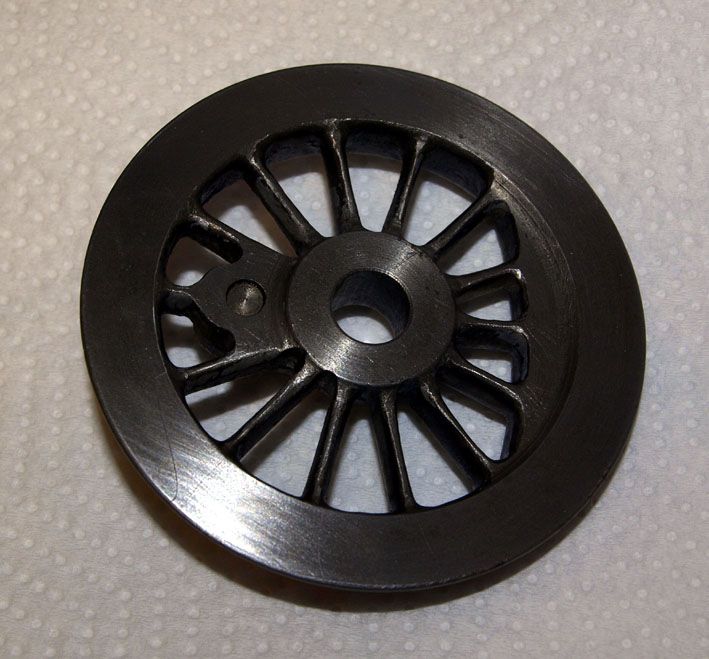

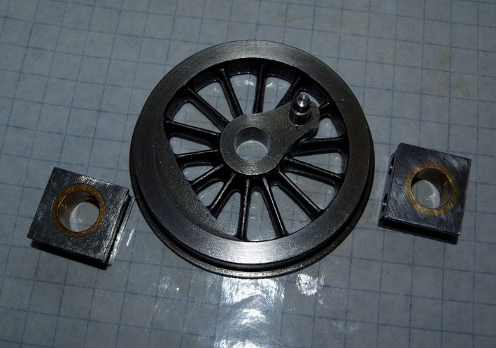

                  Some pictures – as promised. The frames have been very badly attacked by evil rust so I will need to start again. One of them will at least serve as a good drilling jig.
                  The wheels, axles and axle boxes have a little bit of surface rust that can be cleaned off.

                  Wheel
                  One of the wheels and a set of axle bxes made from BMS with brass bushes.
                  Rear of the wheel
                  Yep – I was sad enough to scoop out the back of each wheel and file the spokes to an oval cross section.
