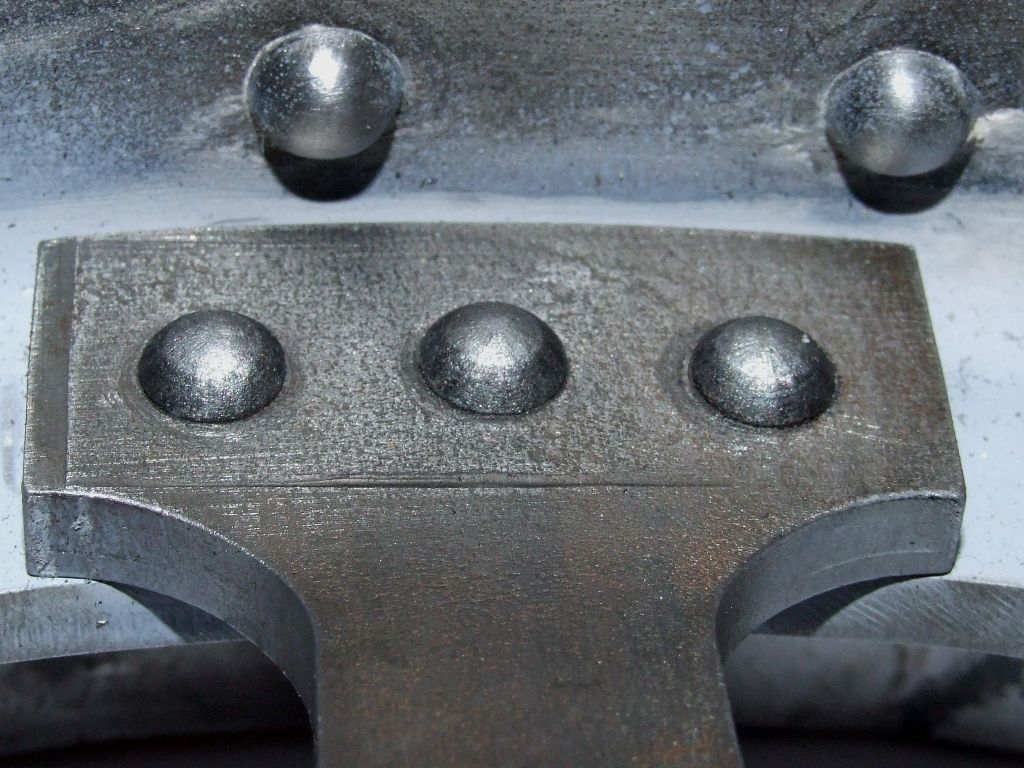

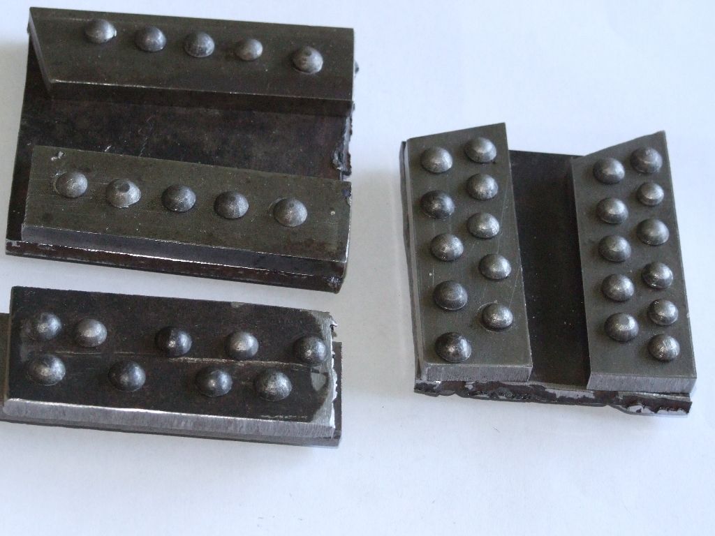

                  Don't sweat the numbers, it's only a starting point. The actual allowance is heavily dependent upon the rivet snap and the fit of the rivet in the hole. Before I riveted the wheels on my traction engines I formed a lot of practice rivets, varying the allowance to see what worked:
                  This was particularly useful as I was using home made snaps. For consistent heads it's best to aim for better than ±5thou on length. Since I had to shorten hundreds of rivets I made a top hat split sleeve and shortened the shanks in the repetition lathe which gave excellent consistency. It's better to be slightly under rather than over on length.
                  All rivets are 3/16" steel.
                  Andrew
                  Edit: Ooopsie, just noticed the OP was asking about countersunk holes. The theoretical answer is pretty simple maths, cylinders and truncated cones. But it's best to experiment. More is better than too little. There needs to be enough metal moved to the outer edge to completely seal the edge of the countersink. One won't get the formed rivet head perfectly flat, so best to get used to filing! Leaving the formed head proud will also ensure that filing removes all hammer marks.
