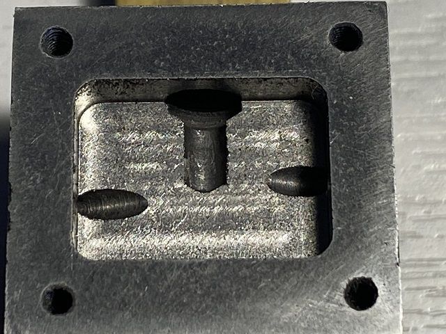

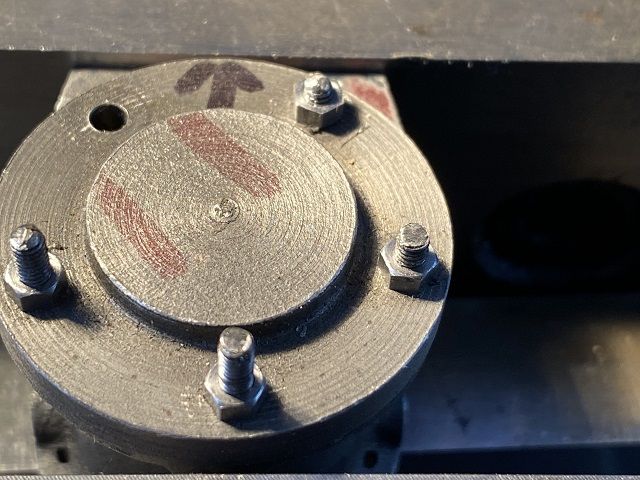

        Well I opted to mill out the poorly formed ports. In order to do this I needed to remove the studs the previous builder had fitted for the top and bottom covers in order to mount in the vice.
        The studs decided to fight back. Well one of them did. Five on the upper cover end came out easily. Four of the lower ones came out relatively easily. The last one fought back and said no way am I leaving this casting in one piece and promptly sheared flush wit the top of lower face. Bugger I thought.angry 2. I actually said something worse.
        I knew drilling it out would be fraught as it needed a 2mm tapping drill size and if this wandered being such a thin drill it would go down the casting in preference to the stud.

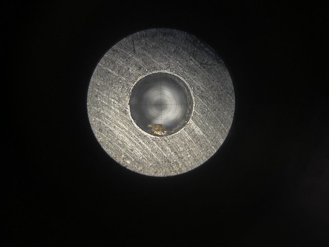

        I set it up in the vice and refitted and bolted the top cover down.
        This now gave me a fixed location. I then used my centering scope for the first time in anger to locate on the hole in the cover.
        Once located i remove the top cover and the studs. Fitted a 2mm slot mill and very gingerly raised the table to bring cutter and stud together. Ran at approx 1500rpm and worked my way through the stud. Once remnants cleared out was able to run 7BA tap back down the hole. That was quite a relief.

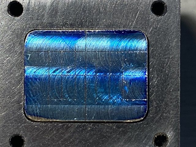

        Blued up the port face on the cylinder and lightly scribed a box around the area to be milled out. This was my sanity check to ensure I had my DRO settings correct. Clamped in vice and set level and set up a 3/16 slot mill.
        Initially put in four corner holes at 1/8" depth, then reduced the DOC to 1/16" and milled out first layer. Dropped down to the 1/8" point and took out another layer. I was hoping to get away with this but needed another 1/16". Looked good at this point so them went round the periphery with a full depth cut removing final/1/64" all round.
        Pleased with that now need to make the brass insert.
        I have never used JBWeld before so am not sure how much smaller I need to make the brass insert. I assume I need the JBWeld as thin as possible. Is it fairly thin as soon as it is mixed. I was think that when the brass insert is pushed into place to use, either flypress or arbor press to push it as fully home as possible.

          #524859
          Dr_GMJN
            @dr_gmjn

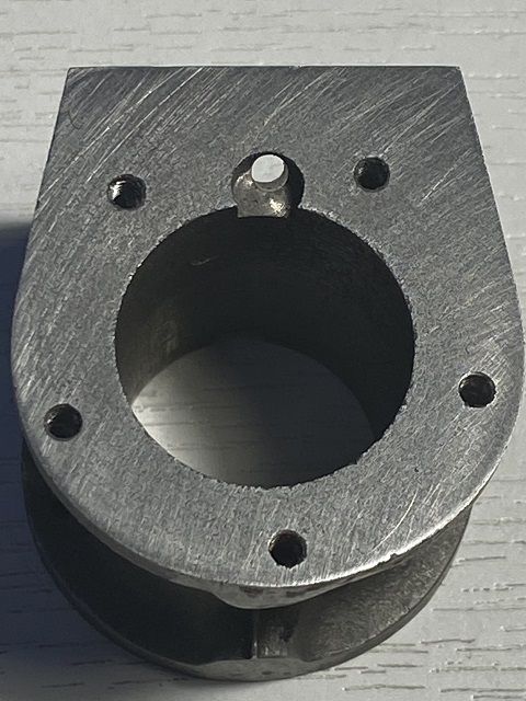

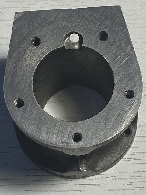

            I'm intrigued to see the port relief pockets in each end of the cylinder…
            I can't see how the drillings can be so far out of alignment and still be in the right place in the cylinder pockets.
            From the filed soleplate, it seems like the original builder might not have had the benefit of a milling machine?

              Colin Heseltine
                @colinheseltine48622
                Jason,
                Thanks for that. I will try and get that bit made tomorrow.
                Dr_GMJN,
                Your wish is my command.
                You will also spot that the 5 holes are not quite centered where they should be.
                It is what it is.
                Hopefully it will run a lots better and look a lot better when finished.
                Colin

                  Colin Heseltine
                    Br,
                    I had to use the better positioned holes for the mount to the standard otherwise the valve chest is even more out of alignment with the eccentric.
                    I don't want to end up remaking everything. Hopefully it wont look too bad by the time it has a coat of paint on it along with reversing gear..

                    Dr_GMJN
                      @dr_gmjn
                      I've not used JB Weld yet, but from what I've heard I wonder if it would be possible to fill the top cover holes and re-drill/tap?
                      Even without that, it doesn't look they're far off being suitable for re-drilling and almost missing the originals.
                      Depends on what you want at the end, but to me, that top PCD is one of the key things to get looking right, along with the alignment of the valve chest cover fixings.

                        Neil A
                          @neila
                          Funny you should mention the number of holes in the covers.
                          My 10V of mid 70's vintage has 4 holes in the bottom face of the cylinder to the standard and 6 holes in the top face for the cover. I've just checked the drawing to make sure.
                          The design seems to have changed a bit over the years.

                          Colin Heseltine
                            Dr_GMJN
                            I have just looked at that option. I would need to drill every single hole in the top face near enough 50% in cast iron and 50% in JBWeld. Not sure quite how well that would work out. I do not know whether the drill would wander between the two materials. I guess the other option would be do do like I did with the broken stud and use a 2mm slot drill rather than a 2mm ordinary drill. Maybe a 5/64" slot mill would be even better as it is only 6/10's of thou under 2mm. It also assumes I can fill the holes completely with JBWeld. Maybe instead of JBWeld it might be easier to loctite in short sections of 7BA stud and then use slot mill to produce the hole as with the JBWeld option.
                            Br.
                            The idea of six holes is a good one, but having drilled and tapped holes for drain cocks, these would be in the way of the holes in the 90 and 270 degree positions.
                            I will sleep on it.
                            Colin

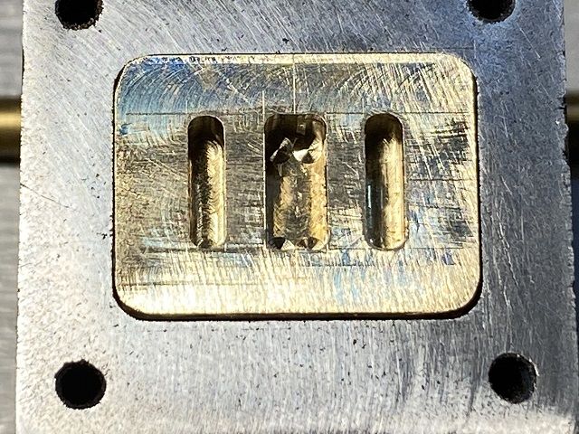

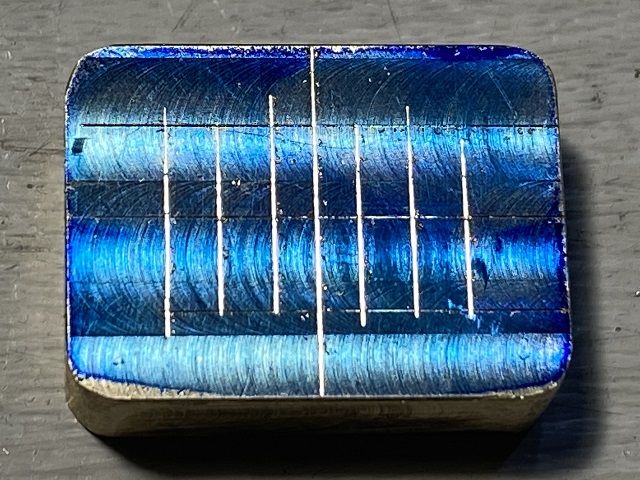

                                                    Cut and squared a block of brass up on the Cowells mill. Then for my own sanity blued it and scribed the port locations.
                                                    Having then files the corners ensured it fitted the location in the cylinder and sat flat on the bottom.
                                                    Yesterday evening I sat and wrote down all the DRO positions and moves I needed to produce the slots. To make it simple (for me) I worked from centre lines in both X and Y axes.

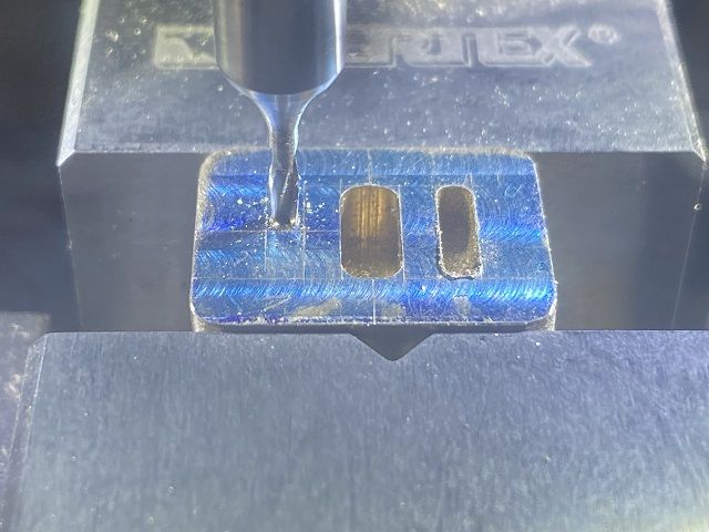

                                                    Used the Cowells mill to do the slots as exhaust port was going to use a 3/32" and inlet ports a 1/16" slot mill. There is a lot more feel on the tiny machine for the little slot mills. But even with this I still snapped a 1/16" as I was half way through the last port.
                                                    Once I had finished the two inlet ports I revisited the corners of the exhaust port with the 1/16" and plunged it down to tighten up the corners.
                                                    It deliberately sits proud of the cylinder port face as I will face it off when JBWeld has gone of and then lap it.
                                                    Whilst I had the 1/16" slot mill in the chuck I centred up the slide valve and opened the recess up to its correct dimensions.
                                                    Slowly but surely.
                                                    Tomorrows task is to JBWeld it into place and look at top cover.
