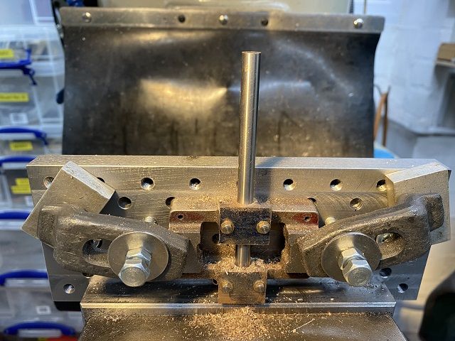

      Many moons ago I bought a built Stuart 10V on Ebay. When it arrived I had a quick look and due to work commitments it got put on one side. I have recently finished two of the Alyn Foundry engines and then saw Dr_GMJN's build of his Stuart 10V and this prompted me to take a look at the one bought a few years ago.
      I quickly found a few problems. The main bearing bolts on one side were loose, so I tightened them up. Bad move, engine locked up completely. Decided to strip it completely, repair any issues, add a few bits and paint it.
      The bearings were a major problem, they had been drilled completely out of alignment and needed 25 thou of shims underneath both the flanges on one of the bearings. Also found he had filed the base and the sole plate but not very squarely and the locations of the bolts for the main bearings were all over the place. Some things I would have to live with others would be fixed. New bearings extrusion ordered, along with valve chest cover, drain valves etc. along with small 7ba nuts. Also 5BA and 7BA taps and dies.
      Whilst waiting for the bits to arrive I started on the steam chest. The slots in the steam valve for the fixing nut were filed but not square and to depth. Also the nut was tapped at an angle. Bit of work with a 3mm slot mill in the Cowells Mill saw the looking a lot better a new nut was fabricated and tapped. The steam chest had also been fitted back to front and had an out of square piece of gauge plate for a cover. By now the ordered parts had arrived and so I machined up the new cover. Started this on the Cowells with a flycutter but it was so chilled around the edges I migrated to the big mill and used a carbide facemill.
      The cylinder and end covers appeared to have been made quite well and all I did with these was drill the cylinder for drain valves.
      In one of my other post you can see a fixture plate I made to use initially on this engine. I was able to clamp the soles plate down and facemill the bearing platforms and the standard mounts to get them all level.
      Then flipped the casing over and flattened the bottom. I used the same clamp but files the bar so that it would fit between the lower inside of the casting and and not be proud of the top of the base whilst being machined.

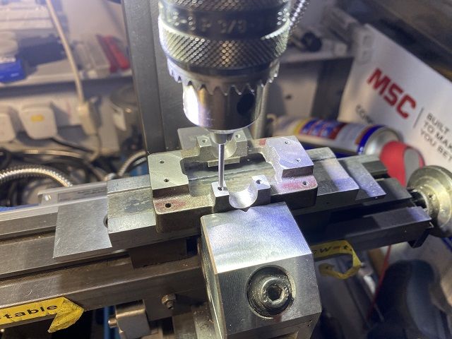

          I felt was going to have difficulty doing the bearings in the normal way by drilling/reaming or boring them in lathe and the turning the bosses down and then trying to fit them onto poorly aligned bolt /stud holes.
          I elected to fit them to the sole plate first, would rill/ream whilst fitted to the sole plate, then remove and turn bosses to length etc.

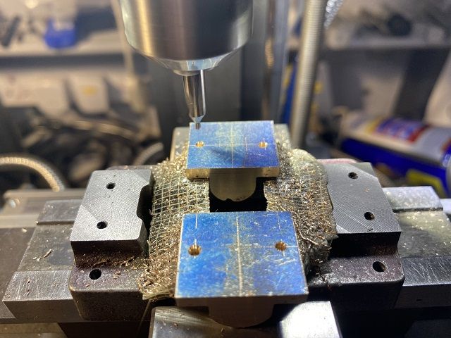

          I started by putting the sole plate in the vice and using the DRO on the Cowells to locate the co-ordinates of all four existing holes.
          When I had noted these down I fixed (use this word advisedly) the bearing in place with carpet double sided tape and spotted the holes with a centre drill.
          All appeared great so far. Removed the bearings and then used 1mm pilot drill to locate the bearings in vice to drill the holes to 7BA clearance.
          One worked perfectly, the rear bearing had moved and one hole was offset by around 1/2 its diameter in two directions.teeth
          I pondered this for a while. Do I get spare casting and start over or attempt repair. Opted for the repair. The 7BA clearance should be 2.55mm but I had done it at 2.5mm. I turned a short brass pin 2.52mm dia, Loctited the hole and used a punch to drive the pin into the hole then left on a radiator to go off for an hour. Reset the sole plate inthe vice and re-checked the co-ordinates of the holes. This time I was able to use one bolt to hole the bearing firmly in place whilst drilling the 1mm pilot hole. Removed when drilled and opened up to size.
          Both bearings now fit and are held down by bolts.

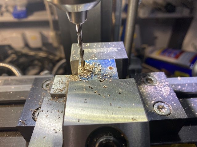

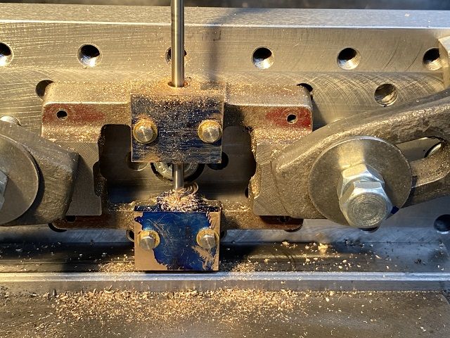

            Was going to use angle plate and mount the fixture to it, but realised did not need the angle plate, just had to but fixture plate on edge in vice. All was square so centred on the middle of the bearing and went through upper bearing with centre drill and then with 3mm drill followed by 6mm drill. At this point I stopped and fitted long center drill and checked was still on centre in lower bearing.
            All was okay so put 3mm and 6m drill through the lower bearing. Followed this with 9.8mm drill through both together. Followed this with 9/32" reamer. Then tried 9/32" drill blank. It fitted. smiley
            Removed the bearings and then made small mandrel to hold the bearing by the bore. Used the Cowells lathe and turned the bearings down to final dimensions.

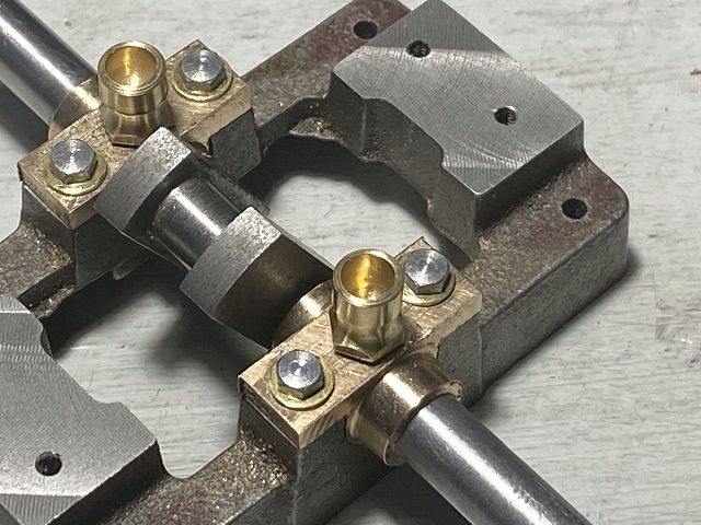

            Refitted bearings to the sole plate to drill for pair of oil cups. Where are the b….y cups. I had them two weeks ago. Searched high and low through workshop and office. No sign whatsoever. Just about to order some and then decided to make my own. Again used the Cowells lathe as can work in the office in the warm at eye height.
            When happy with a pair I drilled and tapped the holes in the bearings.

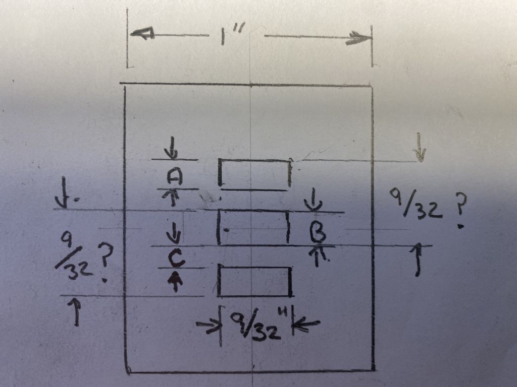

                              Does anyone have the exact port dimensions for a Stuart 10V or more particularly the depth. The ports on this one I am attempting to resurrect are not cast very well. especially the lh one in the picture above. I am not sure how they are would effect the running of the engine if they are left as is. Is it worth filling the left hand port with JB Weld and then re-machining to the correct size/location. The only dimension I can find anywhere on the plans is the width of 9/32". I assume because the slide valve is recess is 9/32" long then the distance between the outer edge of an inlet port and the outer edge of the exhaust port should also be 9/32".
                              The dimensions I would like to confirm are shown as A,B and C in the drawing below.
                              The engine turns over quite easily by hand. It does not appear to be tight anywhere. The piston is very free in the bore (maybe too free). BUT It needs a quite high PSI to get it to run.
                              Thanks,
                              Colin
                              Edited By Colin Heseltine on 03/02/2021 16:38:33

                                      Certainly not on page 22 Fig & cylinder in my book. But my eyes have finally found it on the drawing you sent. Having stared at it for some length of time.
                                      The exhaust port is only 3/32". The gap between the lower inlet and the exhaust varied from 1/32" to 1/16"
                                      The upper inlet is correct as regards distance from exhaust and its width.
                                      What would be recommendation to correct.? Preferably not scrap it.smiley
                                      Colin
                                      #524570
                                        One option would be to mill out a recess say 1/16" thick to just beyond the area that the steam chest covers and JBWeld in a plate that could be cut from brass. Mill the ports in it first rather than risk having to remove it if something goes wrong while machining in place.
                                        #524571

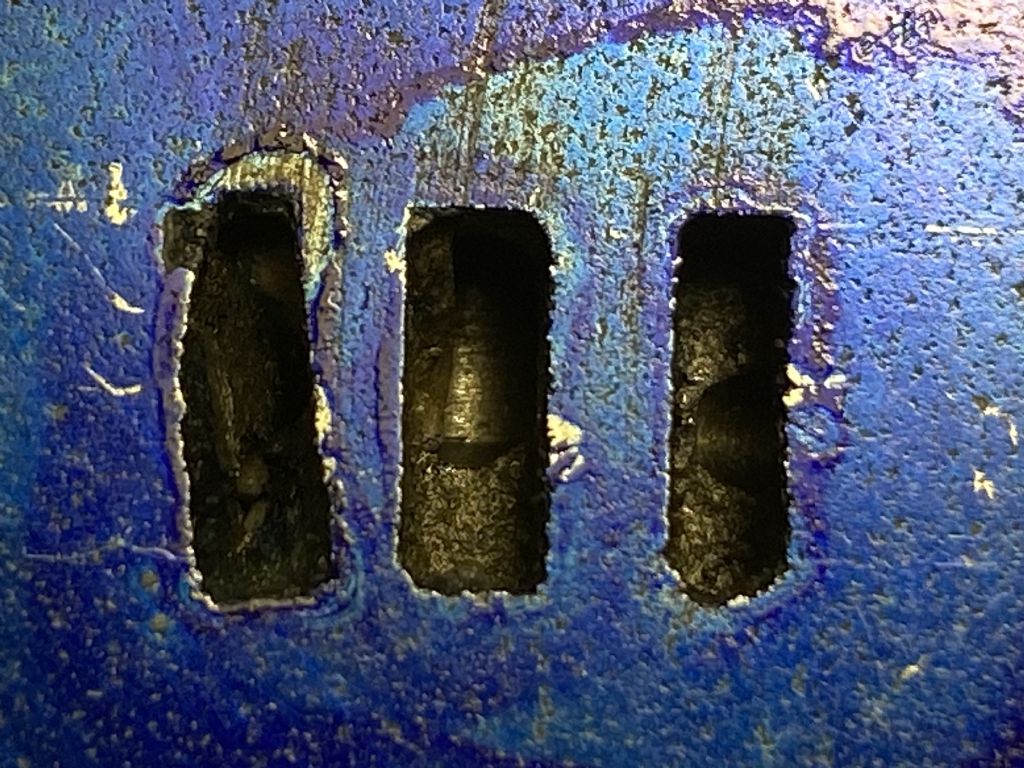

                                                  Having had a much closer look and spotting some "white stuff" in the miss-shaped port it looks as though there is a small blow-hole between the exhaust port and the miss-shaped inlet port or more likely when drilling the port through from the end of the cylinder it was drilled too far. It has possible had some filler put in somehow. Looks like it will definitely have to be the brass insert.
                                                  I think the insert will have to be at least 1/4" thick as it is now going to have to replace the port slots in their entirety.

                                                    Posted by JasonB on 03/02/2021 17:13:30:
                                                    What would be the issue with filling them with JB Weld?
                                                    Different wear rates when the slider moves over that area?
                                                    Could also stick a drill shank down the port holes before it set to avoid re-drilling them?
                                                    #524605
                                                      JBW would probably work OK too, just give the surfaces a once over with a small burr in the dremel to key them and also remove any traces of old oil. Then machine the ports again once set.
                                                      I doubt the JBW would wear down as most of the valve will be sitting on the surrounding cast iron
