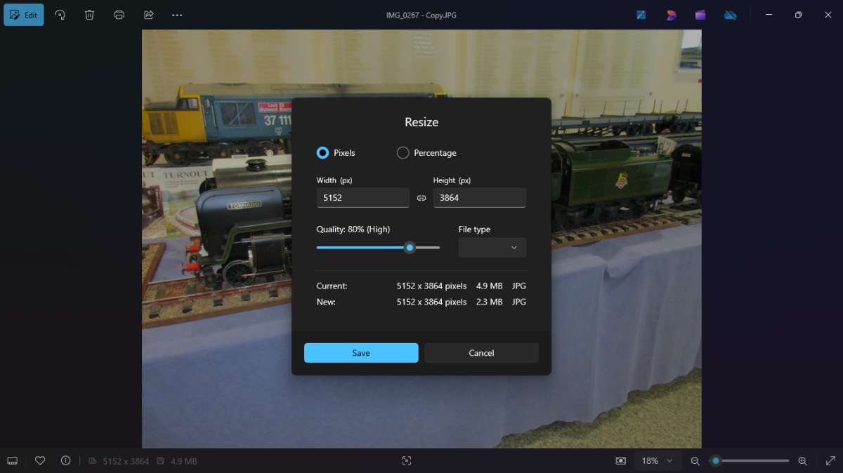

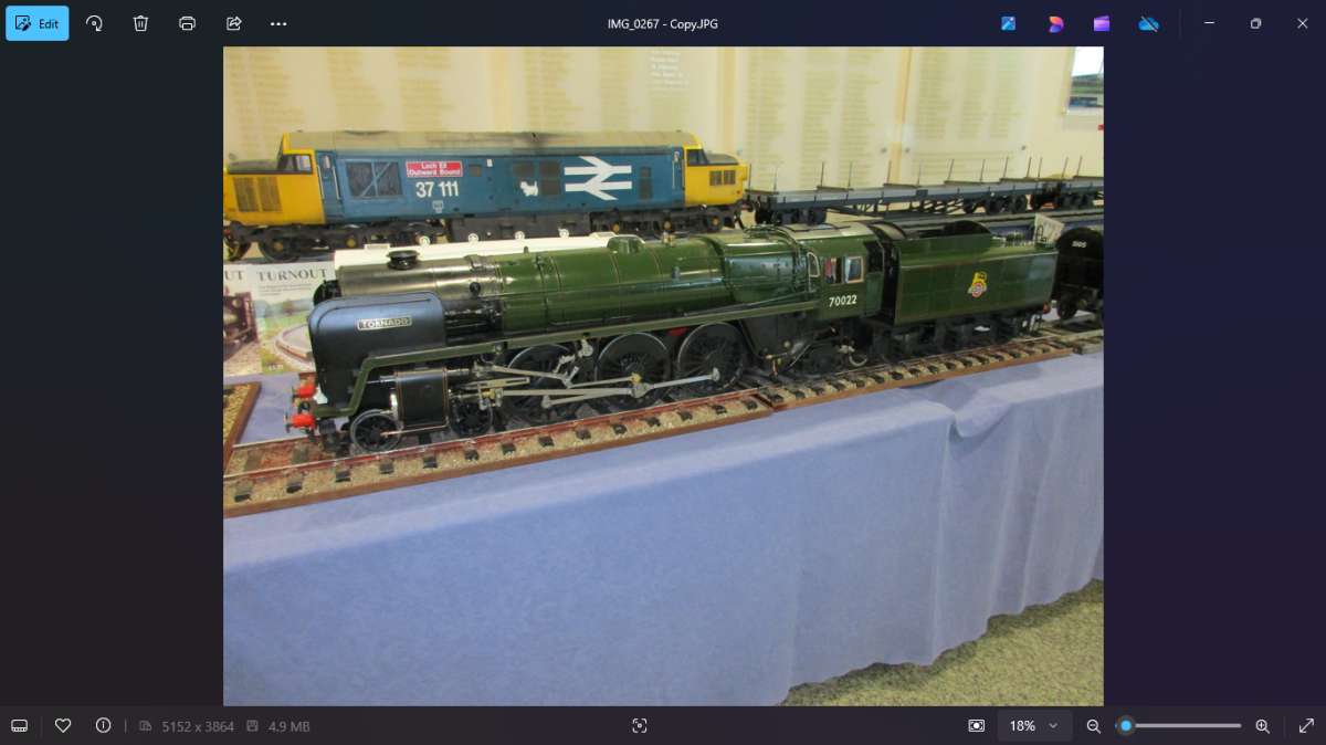

              Hi Duncan, my W11 allows me to resize photos, I just click on a photo and there are three dots at the top R/H side of the screen.
              Screenshot (1)
              Clicking on the three dots brings up a drop down menu, with the resize option, and clicking on that brings up the resize pane.
              Screenshot (2)
              However, I don’t think it is as good as the W10 one though, as I can’t see the option for making web size photos etc.
              Regards Nick.
