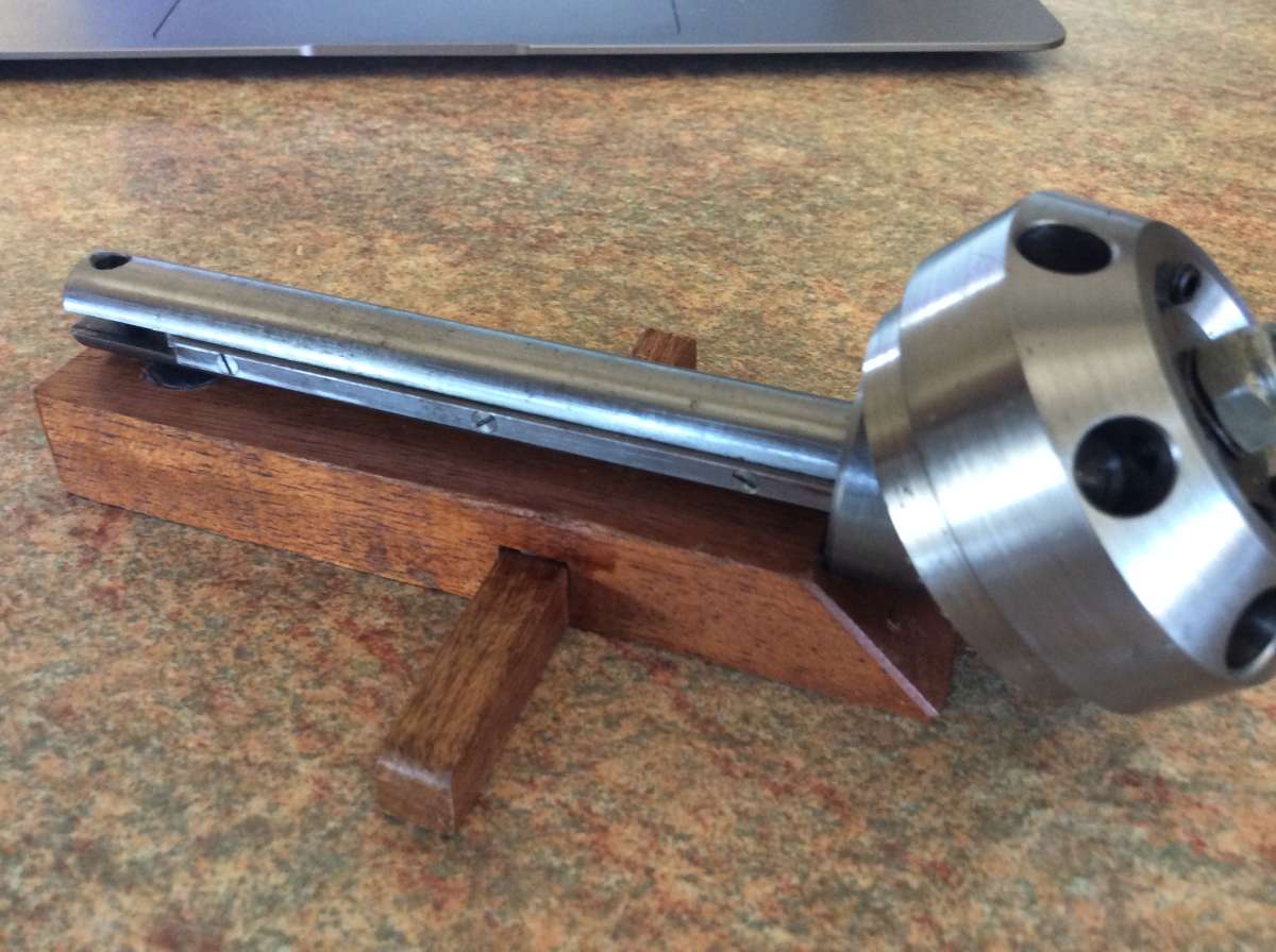

      I have a Taig tailstock drilling spindle that I wish to adapt to fit a Flexispeed. The spindle is 13mm OD and, is a plain shaft with a collar, a thread and a point at one end. I should like a slot 600mm long, 3mm wide and 1mm deep milling into it.
      Would anyone be willing to give a price to do this for me, please? I lack milling facilities.
      Thank you.

          Whoops. Pudgy fingers. 60mm long by 3mm wide by 1mm deep.

              For a job like this? and yes location would be good.IMG_3929

                Material? Hardened?
                #805221
                bernard towers
                  @bernardtowers37738
                  If its the one with a thread and 60deg cone on the end its hard as I have one in my hand and have tested it. Perhaps it might be better to make a new one from PGMS as in my previous post.

                      The spindle isn’t 13mm either. Its nominally 0.497″ or 12.624mm. As to why its such an awkward size – who knows. !/2″ would have been far nicer. 1/2″ ground bar will not go in.

                        If you are only looking at 3thou and 60mm long you could lap that in no time
                          Yes, it is one of those, although mine appears not to be hardened as it can be filled quite easily.
                          True and I can see how that could help, but I want a slot so that a locating screw can be put in there to stop the shaft from spinning.
                          Just to clarify, the length of the slot is 60mm, not 600mm.
                          I am in Aylesbury, but the part is small enough to post easily.
                          James
