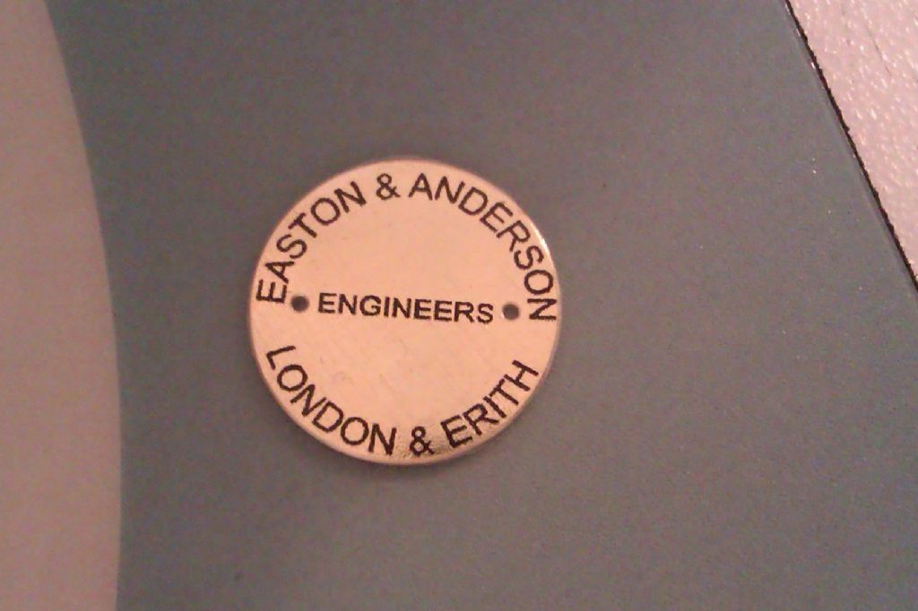

              The problem is the printer ink is not opaque enough to work on a dark surface, the clear film you buy to print on works fine on a light surface but the ones I printed in yellow and tried to lay onto red were all but invisible. Black onto brass works OK, this is 3/4" dia
              The one I linked to above bonds the pigment to a white base coat which is opaque and blocks out the colour below
