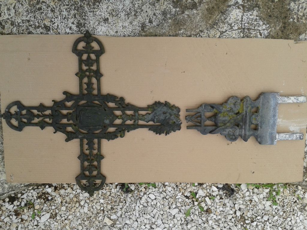

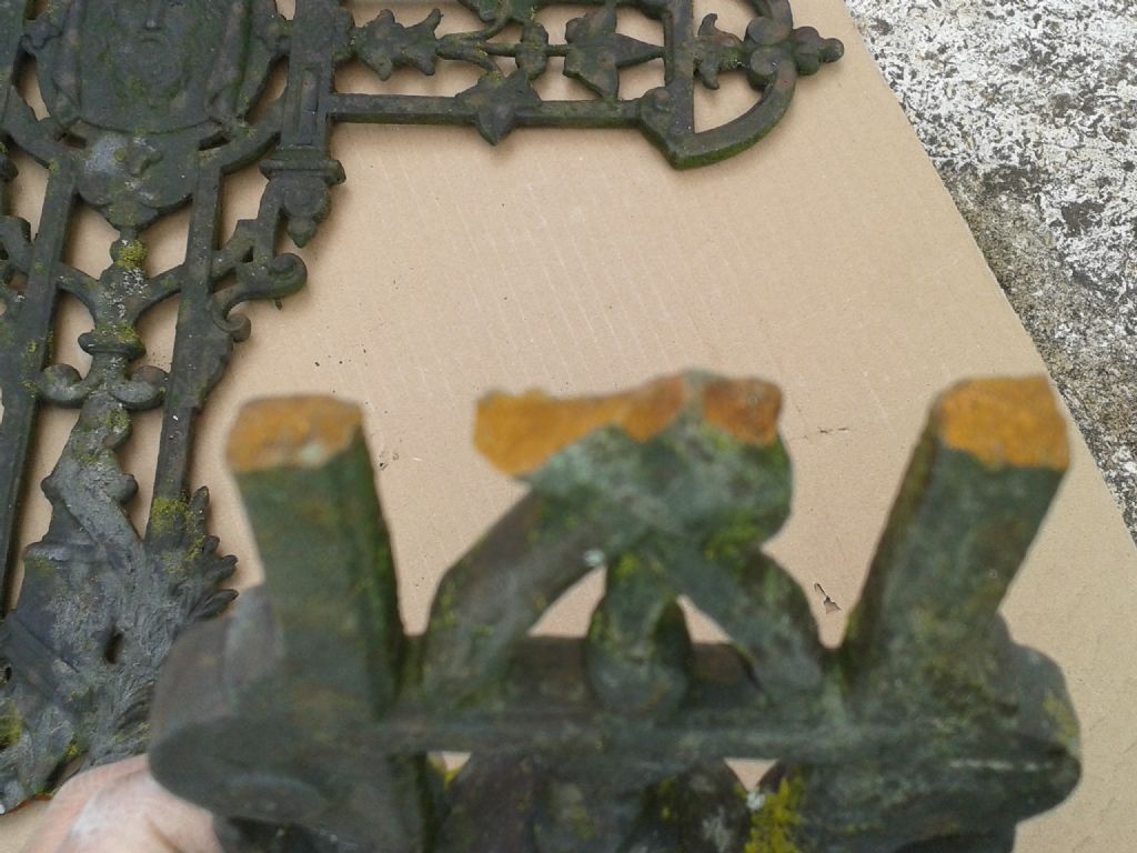

                          Old thread, but worth viewing.
                          Today's job is to mend the village cross which the footie lads bust !! Its cast iron and about 1 Cm thick. I have silver solder, sifbronze and Stainless Steel MIG with Argon or CO2 shield gas. Also propane torch and Oxy Acetylene. What do the team think would be best.
                          BobH
                          Oops, forgot to add the photos.
                          Edited By Speedy Builder5 on 19/06/2016 11:59:18

                              Hi Speedy
                              Gee they picked the wrong place to break It. Any weakness and it will break again.
                              I notice the pattern has 2 straight lines running almost top to bottom. Would it be possible to place 2 say 12mm, (or whatever size fits) square stainless steel backers behind the object lined up with the pattern, at the very bottom they may have to have a kink in them to go behind the legs, and they may need to be bent and relieved with an angle grinder to follow the line of the back surface. Finally the piece could be wired the same way lead light windows attached to the stiffener bars are. if the back of the piece and the supporting bars were sandblasted you should be able to use epoxy to attach it to the backers. one coat to glue it then epoxy putty to fill in the gaps and blend it in, then plenty of paint applied by brush for texture.
                              Many years ago I made a traditional Victorian style iron fence for our house out of 3/4" steel bar, a local foundry cast 300 steel spears for it. They had a small cast recess in the base to fit over the bars, the recess was a bit small I had to turn down all the bars for a loose fit, the cast hole varied. the spears were chilled and very hard, too hard to bore out.
                              I used nickel iron rods to attach the spears. The spears were preheated in a domestic oven to about 500F before welding. I made a jig to hold the bar and spear in alignment and allow the work to turn as I welded turning them at the same time with the other hand. I ran a couple of heavy passes. The bars were not preheated by the time the second pass was going the bars were very hot. I used plenty of current for good penetration. With so many to do there was no time to fuss around.
                              The welds were dressed to a nice fillet with a bench grinder with the wheel edge dressed round to create a nice fillet.
                              Over the more than 20 years only 2 of the welds cracked. easily fixed with epoxy. the rest have held firm.
                              The story above is a success story….
                              It would be tempting to try nickel Iron rods on the cast Iron cross however with such a small section to work on the chances of success are diminished. If the piece is historically important and part of a building failure is not an option. Back supports are less invasive. The basic rule of restoration is that no further damage is done, and Ideally that the process can be reversed. If it falls again it may not just break into 2 pieces. cast iron can shatter.

                                      just to give an idea of size, the overall height is about 700mm and width 70mm. The "square" uprights are 10 x 10 mm. I think that drilling and pegging would weaken an already small section. I have seen on the net that if you use S/s filler wire, the nickel in the wire alloys with the carbon of the cast Iron in a similar way as the Nickel Iron rods would work. I also think that additional stiffeners would be a good idea. If I get good results I think our Mayor may find me some more to mend (as I don't charge for village repairs).
                                      BobH

                                          You can weld that quite easily using oxy/acetylene and cast iron filler material .you will need a flux to float off any carbon in the casting.

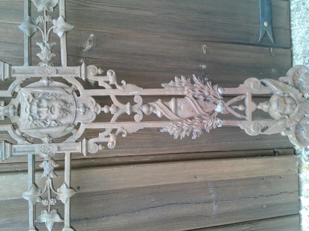

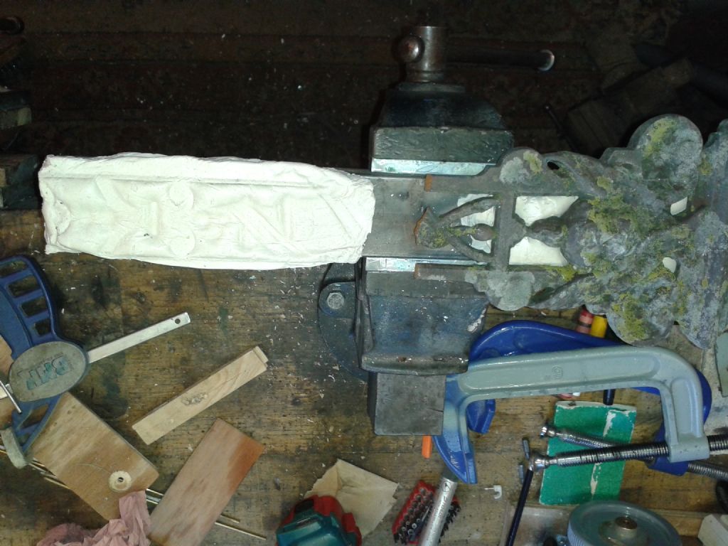

                                                Speedy Builder5
                                                  @speedybuilder5
                                                  Just an update on the village cross.
                                                  In the end I decided to use MIG with Stainless Steel wire / Argon gas.
                                                  To support the joint, I mounted a piece of box section in the vice to support the weld area. To make sure the two halves were correctly supported, I put two big dollops of plaster of paris onto the box section, put some cling film on top of the plaster and then placed the broken cross on top of that , adjusting the cross to get the two broken sections aligned correctly. (Nb: I left the joint area free from support as the plaster would more than likely cause problems)
                                                  I then cut a "V" preparation at the cracked joint , removed the cling film and clamped the two halves onto their plaster supports.
                                                  Heated the general area with a propane torch then wire brushed the area whilst still hot. Then used the MIG starting in the centre and then the two outside fragile legs. It took about 3 runs of 0.8mm wire to fill the joint. Again after welding, I cooled the area gently using a diminishing propane flame and finally left in the hot sun. Some gentle tapping of the joint with a small hammer annoyed the neighbours for 10 minutes! I didn't dress the weld very much – didn't see the need to.
                                                  Just need to paint it and put it back onto its stone plinth.
                                                  Plaster support sitting on the box section
                                                  Finished joint.
                                                  BobH
