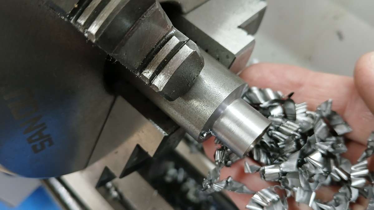

                                  This comes back to my question of “what is the job?”
                                  If anyone is going to be regularly turning Stainless at those sort of diameters and wants it in a hurry then they should be looking at a bigger machine. Trying to push a mini lathe to do a job faster than it is really intended for is why you read the reports of smoked motors and boards. They are for light work and the occasional larger diameter item where with the right methods you can remove metal at a resonable rate and not overload the machine.
                                  This is a 5mm depth of (10mm off diameter) from 30mm mild steel on the only slightly largerAmadeal AMAB210E (8 x 20) lathe

                                          I would say anyone who is regularly parting off 70mm stainless on a mini-lathe has the wrong tool for the job.
                                          Don’t have a need to turn much stainless over 12mm myself and even if I was working with it in  those larger diameters even with my 280 size lathe would band saw it off rather than part. I doubt many a Myford owner would relish the job either. But I’m happy to work 250mm cast iron and 200mm steel though.

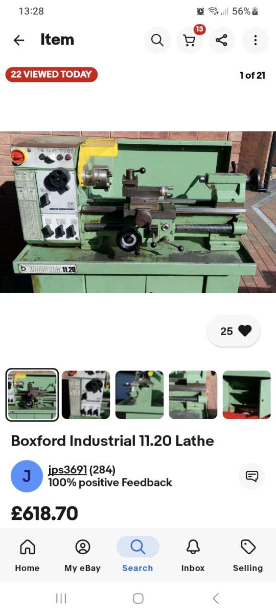

                                                There is a cracking boxford X10 on ebay now for £600 , it’s the 10.20 industrial so  full screw cutting capability & small enough for most workshops & it will outperform ANY mini/import lathe, its very clean. Will take T1 or T63 tool post so 20mm tools will fit ,Why anyone would buy a mini lathe when you can get one of these is mind boggling, (maybe because they take advice off other mini lathe owners) if you want advise ask a real machinest & they will tell you the truth, they have not affiliated with advertisers so wont give a biased answer,  I’ve owned the 10,20 & its easy to move, it can be taken off its base if needed & bench mounted. Parts are easy to come by as there are thousands out there & most are lightly used as they are made for colleges & schools, it will last you a life time unlike a mini lathe, you won’t go wrong with one of these & you won’t need upgrades 😆 like you do on a mini lathe. ( never understood why anyone would buy a lathe after seeing thousends of posts asking for upgrades just to make to do the job it’s supposed to do in the 1st place, it will go on a trailer in one piece or split it in two. Or do what I do & get it shipped for £100 and pallet line move it in to position for you with there electric pallet truck, Get it going with a £40 VFD

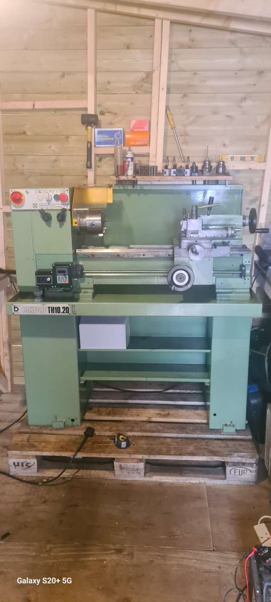

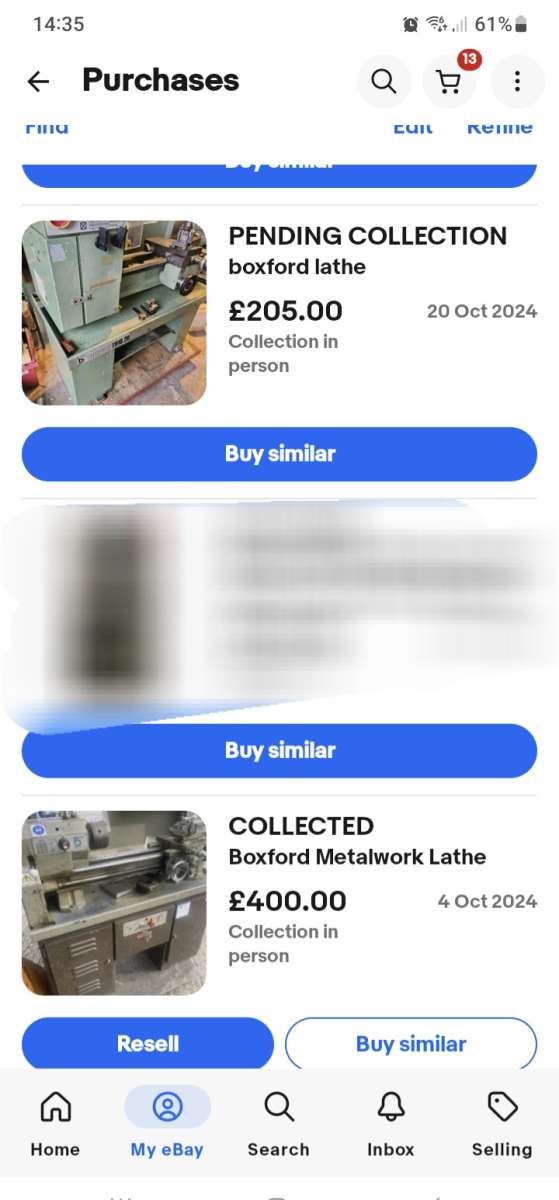

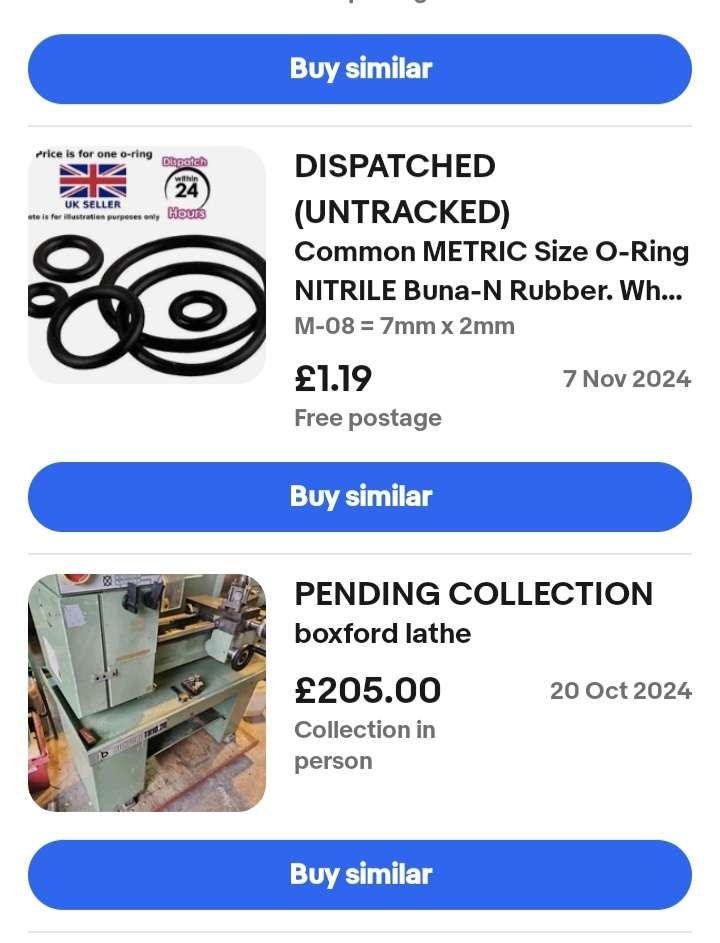

                                                  No such thing as luck ot luck, i been buying machinery the last few years all the time without going to view it , when interested in a M/C that i cannot view in person i ask the correct questions & ask for a video of it running through all the gears ETC . If it has backlash then make a new nut but if you have a DRO it its not a issue anyway.
                                                  Here is a X10 the 10.20TH I purchased for £205, ok the paint was faded no big deal. Everything else was fine came with T51 QCTP & holders, i installed a powerfeed & it was great, 100x better than any mini lathe , paid £205 & £90 shipping  Screenshot_20260327_135607_eBay

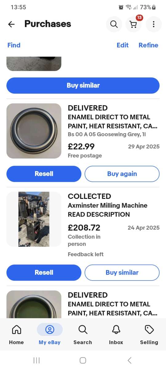

                                                  another axmiinster mill purchased for £200, why because one of the DRO scales was not working. £90 shipping, I sold it for £800
                                                  Screenshot_20260327_135551_eBay

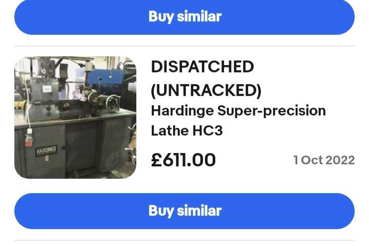

                                                  A hardinge super precision lathe athe purchased for £600. Shipped for £120 sold it for £1200, unbelievable lathe, I only sold it when I picked up a 2004 boxford 330iS
                                                  Screenshot_20260327_143634_eBay
                                                  Boxford 330IS purchased for £700 shipped £120 this is a £3000-£4000 lathe
                                                  Boxford BUD purchased for £400 shipped £110  sold for £800
                                                  Screenshot_20260327_143531_eBay

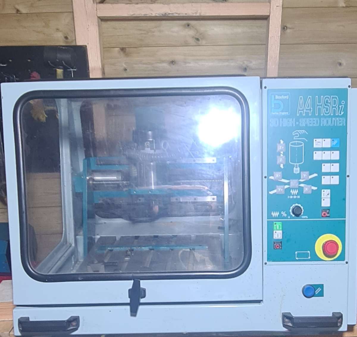

                                                  Boxford CNC router purchased for £300 & shipped for £70 (needed a new drive £45) now worth £1300 I kept this
                                                  20260327_144639
                                                  Belt grinder (the ones used for knifes like they use on forged in fire , payed £90 retail £600-£900 I kept this
                                                  60W Co2 laser purchased for £260 shipped on a pallet £117 I kept this
                                                  Ajax AJT200 mill ( heavier duty version of a bridgport mill but with a 3hp motor, instead of the bridgports 1hp motor, i purchased for £300 shipped for free as it was a local auction but i could get id dropped off for free if i was williing to wait untill they sold the other M/C thry had so they could move it all at once.( kept this & sold my bridgport)
                                                  Bridgport J head £350  I payed £90 to have it delivered, I used a local guy who had a mini crane on his small truck , it had the capacity to lift 1.2T , sold it for £800 when I got the AJT200.
                                                  Thats is just a few I’ve bought without viewing when we downsized I lost my workshop & didn’t have one for 5 years untill the new home had a loglap workshop so I set about getting the machinery I wanted & if I see a good deal I buy it & sell the old one.
                                                  its not luck at alk & anyone can do it.
                                                  I look for items that except offers,
                                                  I Look for items being sold where the owner is deceased & the family are selling it this happens all the time & thry just want rid of it most of the time.
                                                  I look for items that are ending during on a week in working hours 8-5pm as most people are at work so less biddders online
                                                  I could go on & on, I have not been lucky at all , I.ask the correct questions & ask for videos & I make it clear that if I find any other issues the seller forgot to mention then the item will be returned & they will be liable to the return.
                                                  While the older Boxford lathes are great & are a real lathe compared to a mini or import I would rathe recommend the X10 series because they are the most recent offerings most under 20 years old ( you can tell by the colour) & as I said most of these come out of education facilities so have light use & are well maintained. Most hobbiest start off with a min lathe only to then sell it & upgrade because of the endless problems they have expirenced using it, just look at the sheer amount of posts put online about ” mini lathe problems” “mini lathe upgrade” thousends of posts & videos online, that speaks for itself & should ring alarm bells to anyone wanting to buy one, far better to future proof your work space & buy a lathe that’s going to turn all the materials & diameters you will come across over its lifetime from 300mm disks, 4 inch bars of stainless steel or hard turning, while you may never use materials that big you just might every so oftern & being able to use 20mm tools is great , so new mini lathe buyers should ask themselfs do you really want to spends additional money & months of frustration to waist your time & money on a mini lathe ? Mini lathe owners always say I wish I upgraded sooner its like night & day, As i said, there are far better alternatives to one, Buy a used industrial lathe & it will save you a whole lot of the problems down the line. Just keep a eye out & one will come along.
