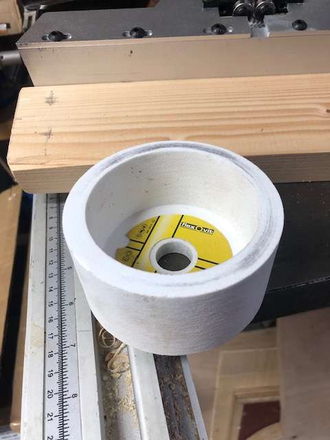

      I bought a cup wheel to mount on a bench grinder for use with a drill grinding jig (a Reliance). However the wheel is unbalanced enough to cause a lot of vibration of the grinder and leaves chatter marks when I try to use it on a drill.  I dressed the face of the grinding wheel with a diamond dressing block but that didn’t make any difference. Is there a simple way to balance this I type of grinding wheel?
      Cup Wheel

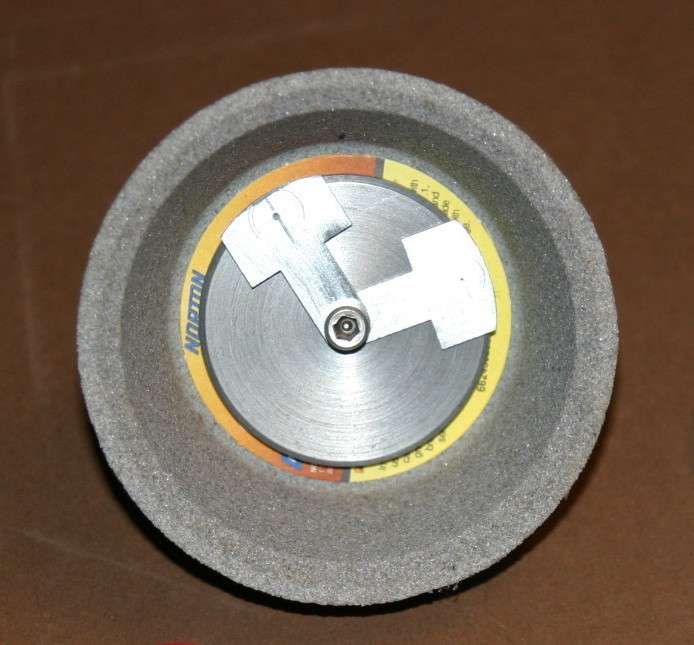

          This is how I balance the wheels on my Quorn T&C grinder.  I do the balancing with an electronic accelerometer, but can be done by trial and error, just takes longer ( or make a jig to statically balance it). The one in the picture was particularly bad.
          Balance Weights

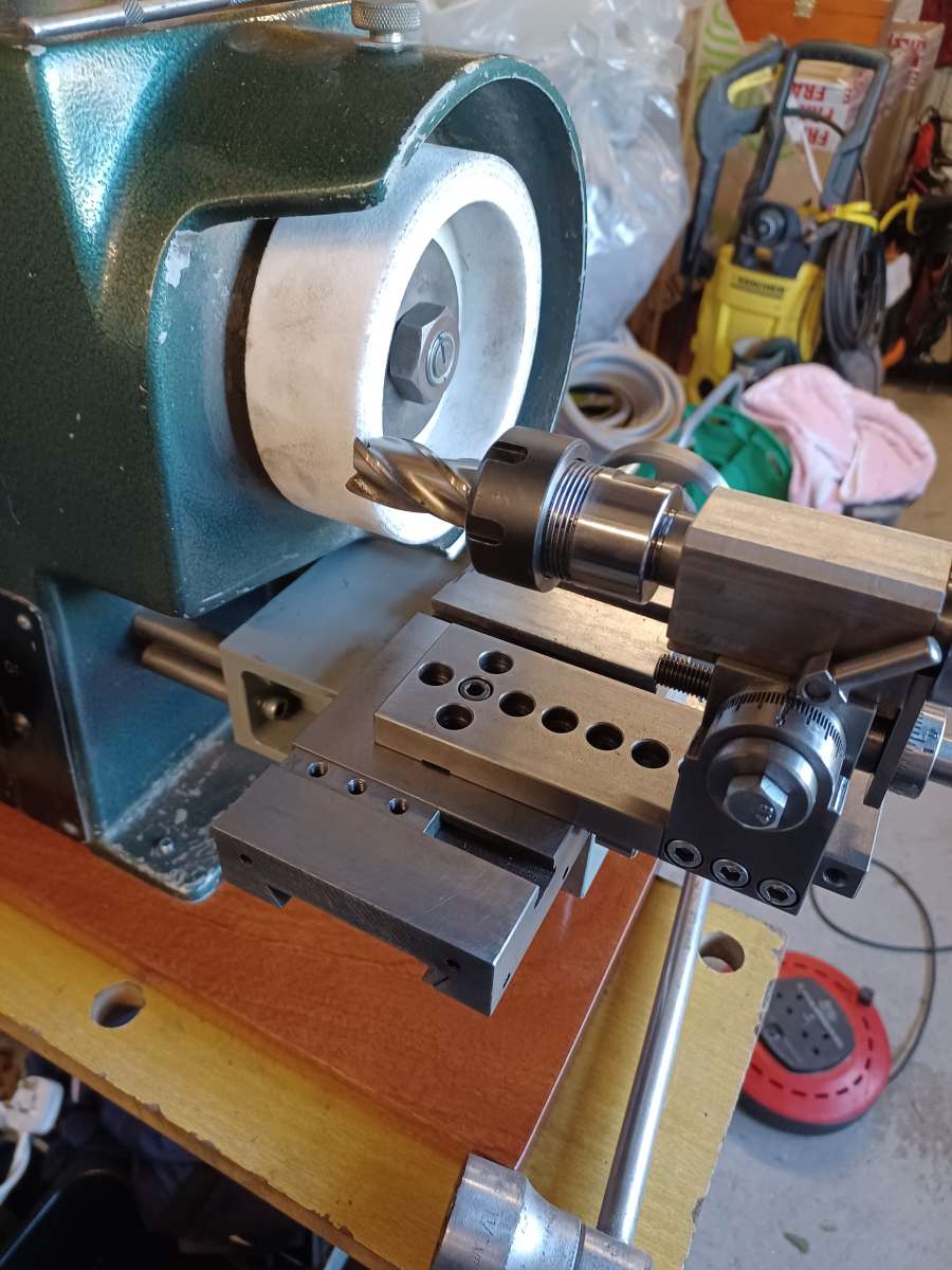

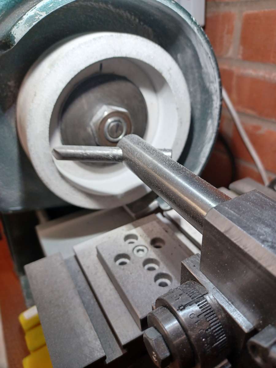

                          David George 1
                            @davidgeorge1
                            When I install a grinding wheel, having tested it for damage and it rings when tapped with a soft mallet, especially for the first time. I have a mark on the spindle flange and mark the grinding wheel with a marker pen so that if it is removed it can be replaced in the same orientation radially position. I check for play between the bore of the grinding wheel and the spindle and also ensure the card washers are not damaged, the correct diameter and in place. The wheel if very loose I would discard and either send it back or destroy with a hammer the same as if it doesn’t sound right  when ring tested. I tighten the wheel whatever type till tight but not over tight. Replace any guards and tool supports as necessary. Next spin the wheel by hand and look out for concentricity or fouling on guard or tool support. Then switch on the power for a short time checking for major problems like being out of balance or catching or fowling anything. If reasonably ok switch on again and allow it to settle down spinning. I would then dress the face of the wheel which would normally get rid of any vibrations caused by out of true to the spindle bore and run with little vibration. If the wheel is a flat cup wheel I dress the outside diameter of the w heel to run true with the bore and then the face of the wheel as well. If there is any major run out of the inside of the cup I have dressed that as well with a diamond tip tool. If you have to change the wheel always check for damage and ring with a small soft mallet and re align the mark on the wheel with the mark on the spindle flange. I regularly change from a thin 6mm thick wheel to a flat cup wheel to a tapered cup wheel then to a diamond wheel on my tool grinder.
                            20250222_114550
                            20250708_153143
                            David

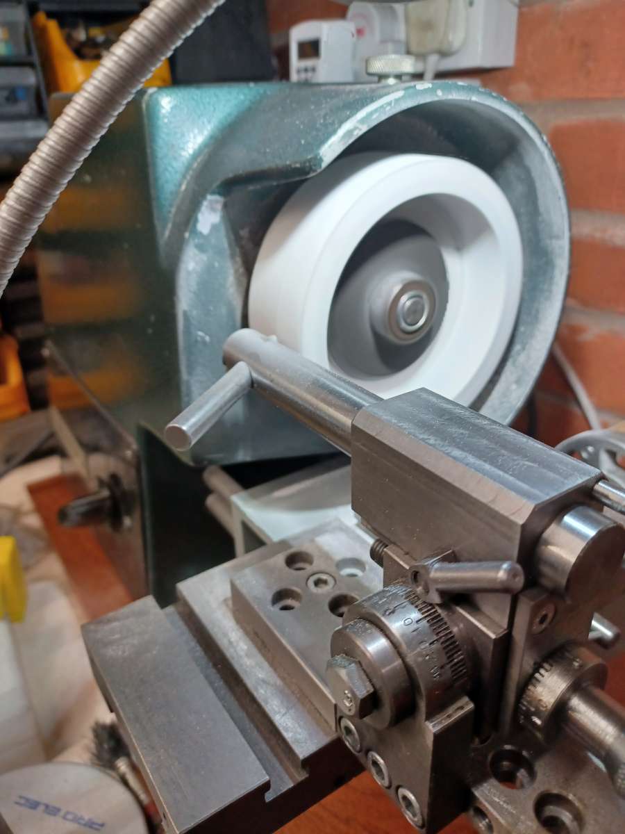

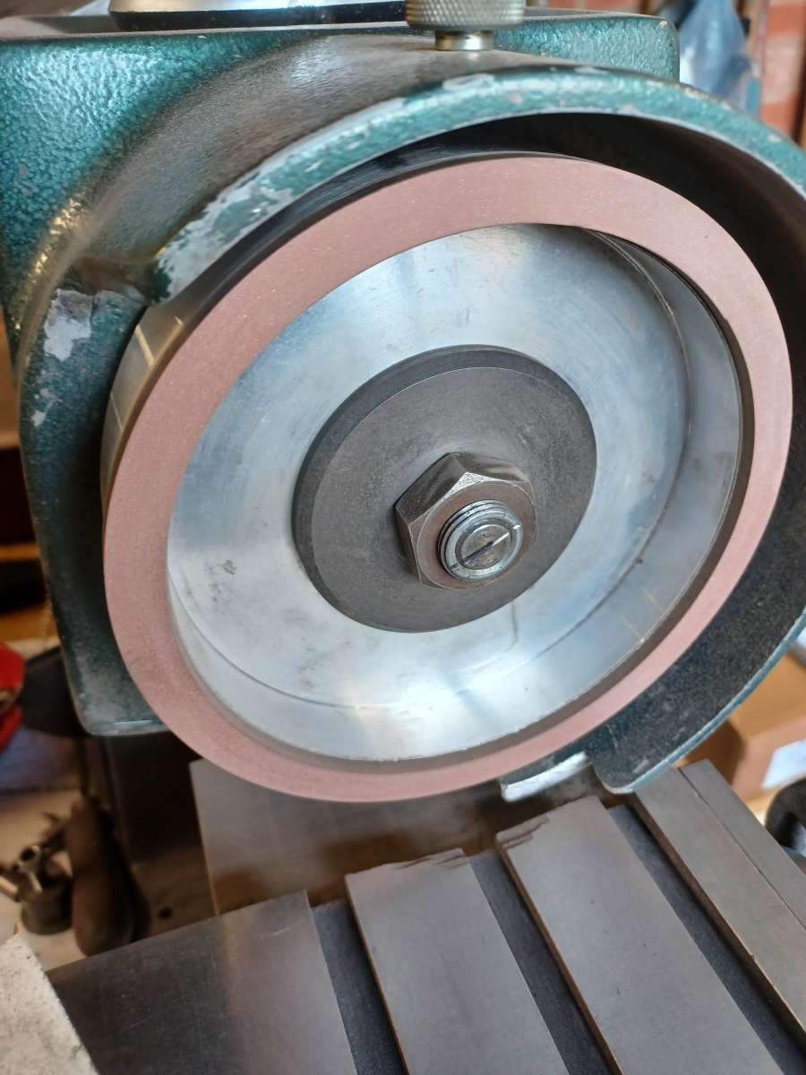

                                  David George 1
                                    @davidgeorge1
                                    This is my dressing attachment for dressing cup wheels.
                                    20250803_105119
                                    20250803_110547
                                    I have  chisel edge diamond which will go into corners and wind it in and out with my cutter tool holder slide.

                                      David, thanks for the additional photos, I can see clearly what you are doing. Would you still need to use balance weights or does the truing process, as described, generally achieve acceptable running? I suppose the rear of the wheel would be tricky to dress?
                                      #810585
                                      David George 1
                                        @davidgeorge1
                                        Hi Chris  very rarely is the outside of the wheel runs out and the sindle flange is solid to the spindle and flat so the wheel also runns flat to the flange and so doesn’t need dressing. the most runout is the inner diameter of the wheel and once dressed there is no need to use balance weights once it has been dressed. I mark the wheel and there is a mark on the flange to match so replacement in same diametrcal position.
