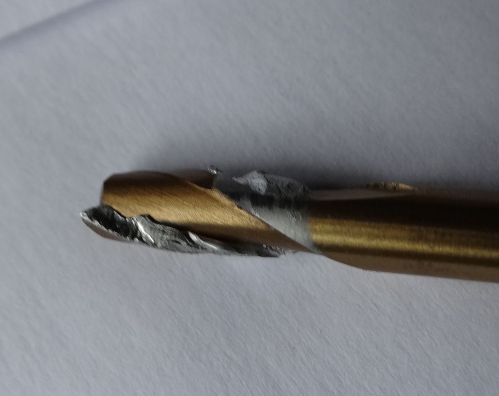

      Last week I was cutting a 6mm deep slot in Aluminium to make a window for an optical sensor.
      Not really having the time, I rushed the job, ignored the mill's complaints, and ended up with aluminium stuck firmly in the cutter and blocking the flutes. (Not convinced it has a practical application, but I learned it's possible to soften Aluminium sufficient to make a horrible slot with only the frictional heat generated by a blocked cutter!)
      Some of the aluminium unpeeled when attacked with a pick, but most was stuck solid.
      I tried removing it chemically.
      Aluminium resists acids, but reacts with alkalis. An hours immersion in a hot concentrated solution of Washing Soda (Sodium Carbonate) made very little impression. I switched to Caustic Soda (Sodium Hydroxide), which is much more aggressive. Roughly half the Aluminium dissolved over 90 minutes and most of the remainder was loosened enough to come off manually.

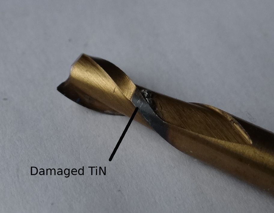

      Success except the reaction also seems to have attacked the gold Titanium Nitride film used to improve the underlying High Speed Steel.
      Does anyone have any comments on the method; is the TiN compromised or just stained?
      Mostly though, does anyone know of a better way to remove aluminium stuck to a cutter? (Yes I know I the best way to avoid the problem is to let the cutter do the work and lubricate, but I guess a fair number of us get caught occasionally. Some Ali alloys are more likely to do this than others.)

                    "No apparent reaction occurs between either TiN or ZrN and aqueous NaOH" according to **LINK**

                      My guess is that the TiN was removed by rubbing with hot aluminium during the original cutting process. I think it is significant that the affected section starts where the clearance grinding on the OD of the tool stops – and the object of a clearance angle is to reduce rubbing.
                      Perhaps if the cutting had been restricted to the section with clearance the problem would not have happened, or been so bad.

                        Sodium Hydroxide solution (Caustic soda) is the best to get rid of Al deposits. Does not react with TiN, if in Doubt place undamaged TiN coated item in it.

                            Thanks guys, that all makes good sense, especially:
                            • Use a bigger hammer and pick!
                            • Caustic soda is OK on TiN
                            • Damage caused by rubbing, not chemical action
                            • Don't use coated cutters
                            It hadn't occurred to me that the coating might cause trouble. Jason is absolutely right to highlight it: following his clue I soon found this advice on the web . It includes: 'The Physical Vapor Deposition (PVD) coating application process on TiN, TiCN, TiAIN, and AlTiN tools makes them unsuitable for an aluminum application. The PVD coating process creates two modes for aluminum to bond to the tool—the surface roughness and the chemical reactivity between the aluminum and the tool coating. '
