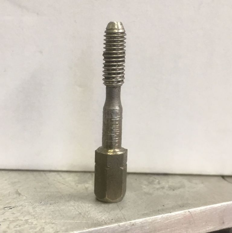

      I'm just thinking ahead statrted to put my 3" Burrell gearing back togather only to find one of the sprockets as a grub screw stuck in it and the allen hex is rounded ! It looks as if it's 2BA with a 5/64 allen key at this point I have given it a good dose of penetrating oil hoping come tomorrow it will screw out if not would welcome suggestions as to how to remove it my first thought is some heat,

          You may be lucky but my guess is, it will be easier to drill right through it and use an ' Easyout '.

              I agree with Brian about 'EasyOuts' – they can expand the bolt and make things worse.
              My preferred method is to use a left-hand drill. It will centre well enough in your socket grub screw and, eventually, bite and wind out the screw.
              I believe there are a few videos on YouTube.
              As well as the simple left-hand twist drill, you can get a screw remover that has the same shaped tip.

                One method I've sometimes used with success is to batter in a Torx bit – it needs to be a tiny bit bigger than the hex socket, but not so much it swells the screw and binds it more tightly. The action of battering it in helps to loosen the grub screw, and then hopefully there's enough grip to unscrew it.

                        The last time I was stuck like this I drilled out the centre of the grub with a carbide drill and the resulting "cylinder" with the threads came out easily with a tight fitting screwdriver.

                              I've had luck in the past using a sliver of very thin feeler gauge down the side of the allen key. Put the sliver in first against one of the flats (or nearly flat if it is really rounded out) then tap the key in along side. It takes up enough room to allow the key some purchase. Good luck.

                                  Before drilling or doing anything drastic you could try inserting a suitable pin punch into the hex hole and give it wrap with a hammer – don’t belt it to death just a sharp wrap , this can relieve the pressure on the grub screw.. I have also drilled most of the way through and used a piece of steel rod that has been turned down to fit into the hole and held it in place with high strength retaining fluid ( loctite) , let it dry for a day and give the rod a twist with a pair of vise grips .

                                    Hi, the danger of drilling a hole through a hex grub screws and then basing something in, is that they are prone to split. A split grub screw is just about impossible to unscrew because whatever you use in the hole will just open it out and wedge it into the hole. XD 351 idea of drilling and Loctite (or equivalent) a rod or a sacrificial hex key is a good approach, providing you don't get any of it in the threads.

                                      Sometimes a dab of coarse valve grinding paste on allen key is enough to make it grip. Grinding off the worn end of the key helps too.
                                      Otherwise a left hand drill bit is my go-to solution. Drill close to the thread root diameter and the shell usually spins out before drilling  is complete.

                                                Turned down torx bit plus a bit of heat smiley
