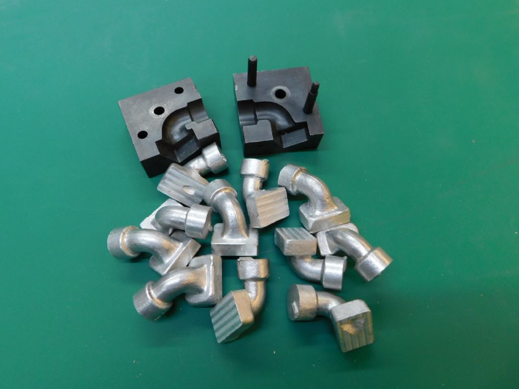

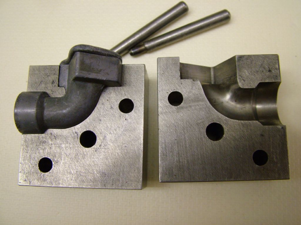

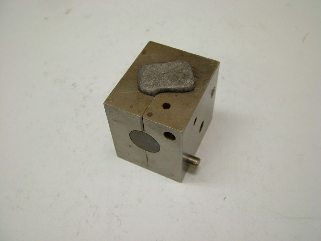

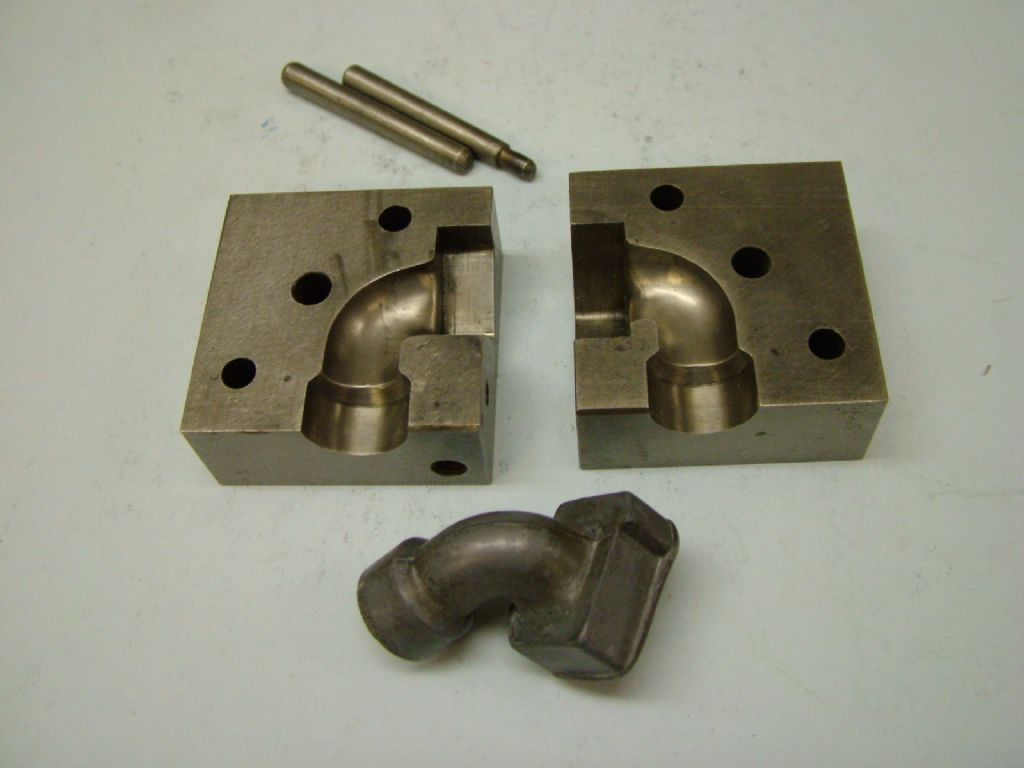

                When I was making parts for the Bentley rotary engine there was a need to cast the manifold elbows in aluminium.
                I made a mould from two pieces of EN1a steel located by taper dowels and machined each side separately to tight tolerances to ensure alignment
                I proved the mould by using lead and smoking the surfaces with a candle
                Though I carried out the above fairly early on in the making it was not used 'in anger' for many years until I loaned it to someone who was also building the same engine.
                He not only successfully cast sufficient elbows for himself from it but enough for my project too
                As you can see the mould was quite heat stressed but unaffected by the twenty plus parts.

                      As Tug has shown, a steel mold will work ! BUT the time spent making the mold and also the fact that it should have been cored, therefore the extra time in boring out the casting. Sand molding would have been quicker and easier and since using 3D printing one could make a double pattern or even more off one gating system and save even more time. Noel.
