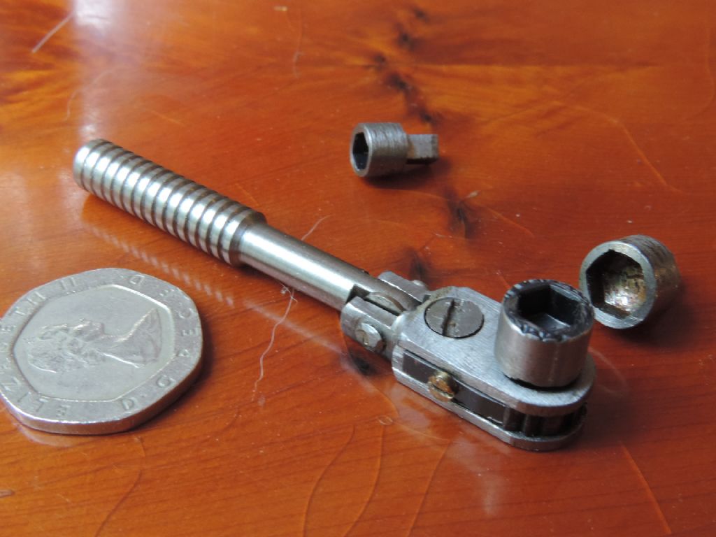

                            This is how I do it:
                            Flycutter insert is made from silver steel to match the desired profile. The slight undercut required on the tooth form is achieved by setting the flycutter tip just below centre height with the ratchet direction as shown in the photo.
                            Russell
