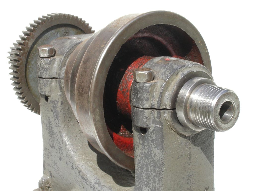

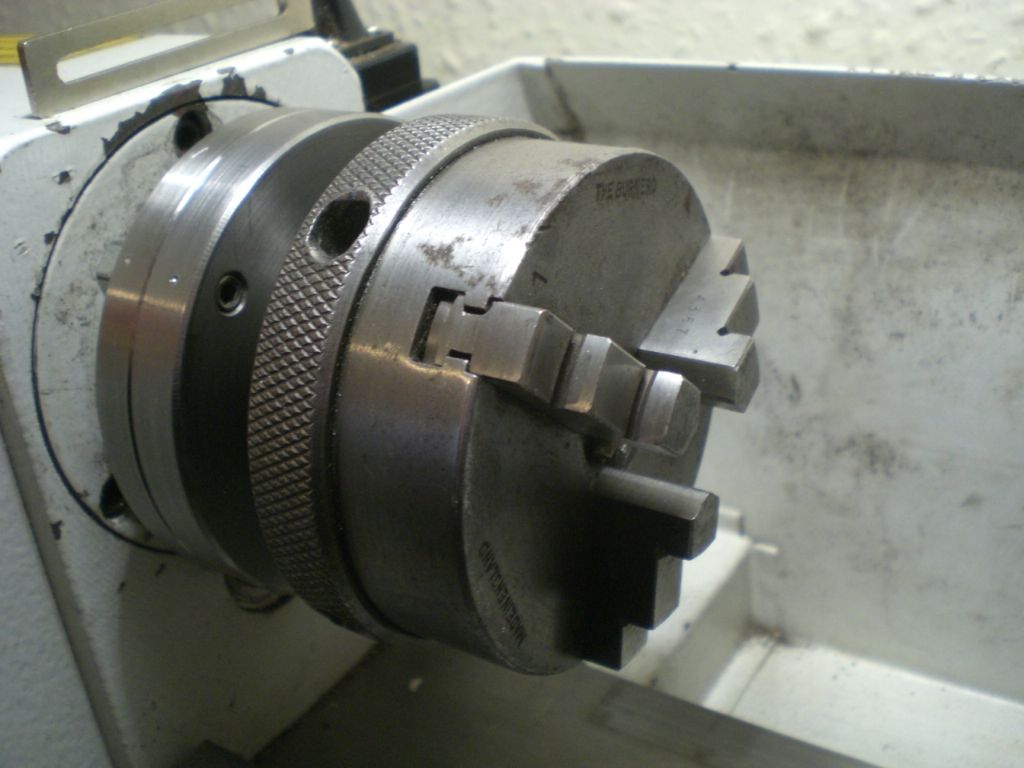

                    Hi Jack, I've made chuck backplates for my father's old RandA B lathe using a 1" UNF tap, and they fit without any problem. I've also made a chuck backplate to fit my mini lathe, to mount the chucks from his lathe, to use on my mini lathe. When offering up a 1" UNF tap to the spindle thread from a RandA lathe, the thread angle is the same.
                    Just be sure you don't use a 1" NF, as they are 14 TPI.
                    Regards Nick.

                                    Hi Jack & Mike, yes there is a register, and a plain portion of 1"diameter, just behind the thread on the spindle, see photos below.
                                    Regards Nick.

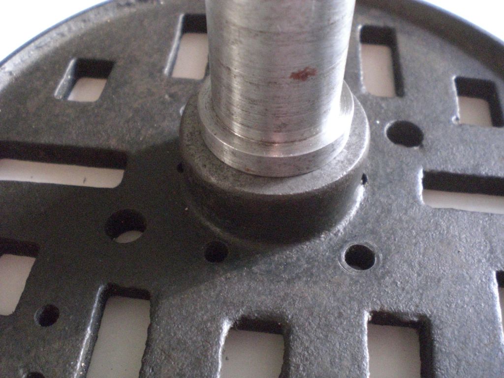

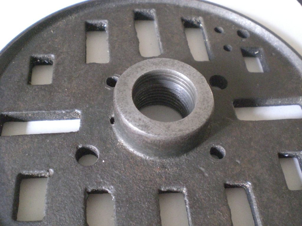

                                      Hi Jack, two photos of the back of my RandA faceplate, first one shows the thread with a plain section at the start, which fits snugly on the plain portion of the spindle. The second one shows how it fits to up the spindle nose register.
                                      The small round holes dotted about, are probably where my father drilled it for attaching work to it.
                                      Regards Nick.
