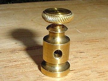

        I’m making some ‘telegraph’ pattern binding posts for a spark coil.  Old style terminals had a straight knurl on the terminal head that was radiused for good looks and ease of use.  How is this done?  Do I use a normal flat-straight knurl and round with a form tool or are there radiused knurls available – about 3mm radius say.
        My current knurl kit does not have enough ‘bite’ to leave sufficient knurl depth for the post-knurl form tool idea to be viable.

          I would knurl after the post is machined to shape
          when made in large quantity I expect shaped wheels would have been used
          but if your post is like my picture a straight wheel would work ( with more square corners)
          I expect more  experienced fourm members will point us in the right direction

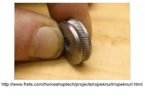

            Hi Roger ,
            after a quick web search I think I’ve found what your looking for at
            see picture of diy knurl tool

                Thanks to John and Michael.  In the end I bought a clamp type knurling tool and modified the toolpost to a 1/2 inch round.  Mounted in my spherical attachment (MEW design).  Rounded the sides of my terminal screws then knurled.  Results are pretty good tho not exhibition quality – but this was a one-off.
                If I wanted a really good job on a tighter radiusI might try John’s technique – but for average terminals I reckon the first technique can be persuaded to work OK.
