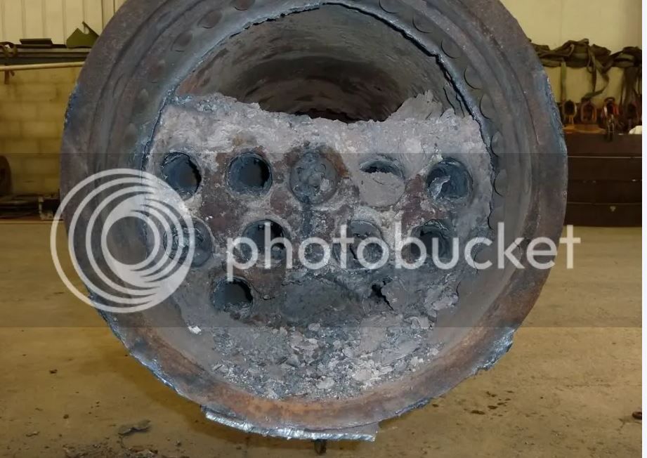

      Hello everybody I have a few questions about boiler washouts and seals. My first question is how some early and isolated railways performed boiler washouts without having proper boiler washout equipment or water treatment? Things like high-pressure hoses to remove any sediment buildup in the boilers. Another question is if any marine vessels like tugboats would also require routine boiler washouts like steam locomotives. My third, fourth, and fifth questions pertain to the seals on mud-hole doors and cylinders. I understand that with routine boiler washouts, the seals on mud-hole doors would need to be replaced. But would early steam locomotives have seals on mud-hole doors and cylinders? Or would they simply have nothing at all? Would isolated railways that couldn't be supplied with new seals, simply refit mud-hole doors with the same seal previously fitted? I'm sorry if these are silly questions my main passion is steam, and I often ask too much.

              Depends on how early! The early builders had to sort out a lot of problems and develop new materials and methods as they went.
              Early boilers were low pressure, and they leaked! Cow-dung is often mentioned as a gasket sealant, mixed with horse hair, with leather or paper padding etc. This sort of gasket may not last long, but they're cheap and easy to replace even in primitive circumstances.
              Blowing down uses the pressure of the boiler itself to remove gunk, not necessarily doing a good job, and of course wasting a lot of coal. Had to be done very frequently at sea because marine boilers ran on salt water. The boiling point of salt water rises as it gets more salty, to the point the fire damages the boiler plates. Marine boilers had to be blown down much more often than land-based boilers.
              At first no-one paid much attention to water purity, and this persisted on mainline rail because it was cheaper to fix boilers than to treat water. Pretty crude compared with marine steam, where water quality and treatments got attention. Running a marine engine for few months at sea with no easy access to fresh-water, coupled with a pressing need for fuel economy and high reliability meant better technology was introduced earlier. A locomotive breaking down between Paddington and Swindon is a tiny dirt cheap problem compared with a steamship breaking down between Perth and Suez. So ships usually had high-pressure pumps, condensers, water treatment, multi-stage and superheat before the railways. Easier to do on a ship because they have the space, even for a well-equipped workshop.
              On land, the need for high-pressure steam soon asserted itself, and this led to the demise of cow-dung, in favour of factory made seals, and the need for clean water, and furnaces designed to burn cheap coal. High-pressure led to huge numbers of boiler explosions, so these too went up-market.
              Road and rail locomotives remained something of a special case, because weight and size limitations restricted what could be done. Boiler inspections relied on men poking burning paraffin rags and mirrors through mud-holes well into the 20th century.
              Not sure when high-pressure water was first used to clean boilers on the railways. Maybe early, though it's not mentioned in any of my books. An ordinary water tower requires something like a 25psi feed, and steam force pumps existed long before railway locomotives. Whether they were used or not on locomotives I don't know. My impression is they may have relied on a mix of high-pressure blow downs and/or rinsing out at ordinary water pressures.
              The story is complicated by wide variations between different railways. Some were forward looking, properly equipped, and well-run, whilst others were sloppy in the extreme. The Wikipedia account of the 1876 accident near Radstock speaks volumes about the dreadful state of the Somerset and Dorset Railway at the time!

                            And having advanced the technology enough to make salt-free water for ship's boilers, it was a constant battle to keep salt out. The usual problem was leaky condenser tubes: condensers used sea water as coolant, and keeping the tube joints tight was difficult. A tiny leak would spray salt-water into the vacuum chamber and contaminate the feed water, undoing all the good done by the evaporators. It was tested regularly with Silver Nitrate, which goes cloudy if a tiny amount of Chloride is present. Judging by the way Captains reacted to condenser problems, they were serious trouble, and I suppose a steel boiler with even slightly salty water in it would rust like crazy.
                            Early low-pressure marine boilers were made of wrought-iron, which resists salt much better than steel, but it's not an ideal boiler material for several reasons. Shipowners disliked it because wrought-iron is heavy, and every ton wasted on boilers is a ton less cargo the ship can carry profitably!

                                  Yes, seagoing vessels are much like power stations and industrial boiler plants, they run on some kind of distilled or reverse-osmosis purified/demineralised water to make up for any condensed steam that is lost each cycle. But water treatment is still needed to some extent. Not so much because of solid sediments but because of pH balance, sulfites, condensate corrosiion inhibitors and other factors. There can be quite a bit of contamination comes back with the condensate into the hot well, from leaky condenser tubes as discussed, or corroded pipework etc.
                                  My grandfather went to sea on a Grimsby trawler as a lad and he told me they went out for a couple of weeks at a time, running on pure seawater, then when they got back to port, the boilers were opened up and the salt scraped out.
                                  Some industrial boilers I worked on needed a good scraping/water blasting internally once a year, even with good water treatment. It was the apprentice's job to crawl inside the top drum of the water tube boiler and run a high pressure water hose down and back each of hundreds of 2" diameter water tubes and blast the scale out. Mostly it was a thin layer about 1mm or less thick of a hard glass like scale. Some old 1923 vintage fire-tube hospital boilers I worked on in America, we had to crawl in through the manhole once a year and clean the tubes with chipping hammers and wire brushes. They had no evaporators or RO unit, just mains water filtered and treated, so they were pretty horrible inside. Still in use up into the 21st century!
                                  Manhole doors (sorry, person access covers) and handhole and mud doors I think would have always had gaskets of some sort. If no new gaskets were available, the old ones could possibly be reused, or you made your own by laying asbestos packing rope in there carefully, with the ends spliced together. Or cut gaskets out of flat sheets of thick asbestos-laced jointing paper. Good old Bell's Asbestos jointing. It's a wonder any of us survived. (Some didn't.)
