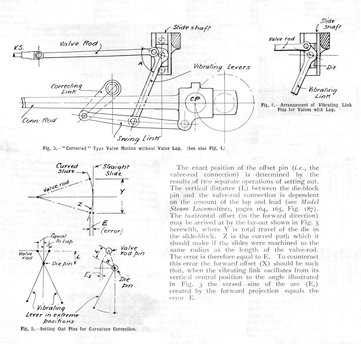

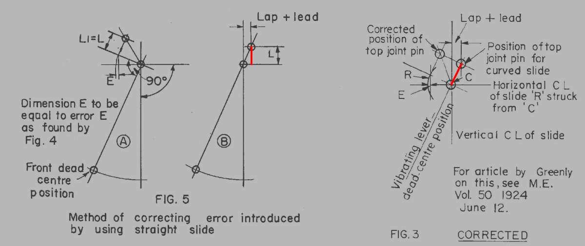

      I have two drawings from K.N.Harris setting out how to correct error
      introduced by using straight slide.
      Both of them based on Greenly and mostly identical,
      but for one dimension (that I have highlighted in red)
      as far as I can see in one (from article about JMG) – “L” appears to be vertical, when vibrating lever is at FDC…
      in another (from article about Radial gears) – it appears to be in line with vibrating lever…
      which one is correct?
      please (and why?)
      K.N.Harris_confusion

                            #781658
                            Chris Kaminski
                              @chriskaminski64716
                              Managed to dig out the original article by H.Greenly,
                              and can see now which of the two drawings by K.N.Harris got lost in “translation”.
                              also, original article by Greenly has instructions/explanation missing from Harris.
                              Computer is not the answer to everything 🙂 (if you don’t understand what you are trying to do)
                              I have seen in my working life too many CAD jockeys
                              who thought that being able to use computer makes them into designers…
                              For anybody interested (although I doubt there are many/any out there)
                              here is the extracted bits of original article:
                              Greenly_correction_instructions_result
