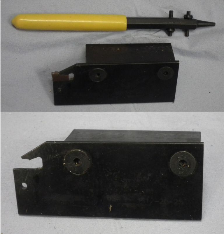

      Bob Unitt 1
        @bobunitt1
        I have an early Greenwood 'Q-cut' Mk 2 parting-off tool. Now Greenwood is gone, I need to find an alternative source for the inserts. Can anyone point me in the right direction, please ?

            The insert is a Sandvic QD-NF-0250-0002-CM 1125. Pop that into google for suppliers though finding singles may be a problem.

              Posted by Oldiron on 04/01/2023 17:45:45:
              Hi Bob, This post may help.
              Be aware that there were two versions of the tool produced. The post to which you refer relates to the Mark I version and the insert code mentioned there (151.2 etc.) only fits that version.
              This thread is about the Mark II version, taking a different insert code, the one mentioned by JasonB.

                        Posted by DC31k on 04/01/2023 18:48:28:

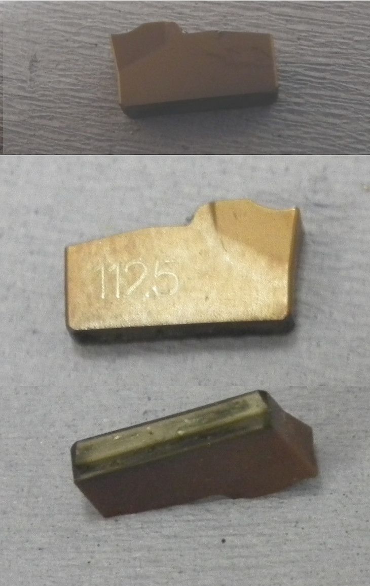

                        I thought that in the Mk 1 the insert was retained by a screw ? Anyway, a picture being worth a thousand words, here is the Q-cut in question :-
                        Q-cut parting tool and inserting device
                        Q-cut insert

                              @dc31k
                              Posted by JasonB on 05/01/2023 18:55:16:
                              That's the one the code I posted fits, same 1125 on the insert as at the end of the code
                              I believe the 1125 is only the carbide grade. That insert will not fit the one in his picture.
                              The one pictured is not what I would call a Mark 2 version. The insert for the one pictured is the 151.2 code, similar to the one here:
                              https://www.zoro.co.uk/shop/cutting-tools/parting-inserts/n151-2-250-5e-insert-grade-1145/p/ZT1006152P
                              It is the newer version that takes the QD NF insert, pictured here:
                              https://www.sandvik.coromant.com/en-us/product-details?c=QD-NF-0250-0002-CM%20%201125

                                Bob Unitt 1
                                  @bobunitt1
                                  Posted by DC31k on 05/01/2023 19:17:56:
                                  Ouch, £160 for a minimum of 10 surprise Does anyone know of a source of single inserts ?
                                  Incidentally – the tool is 2-7/8" long, and the insert 3/8" long.
