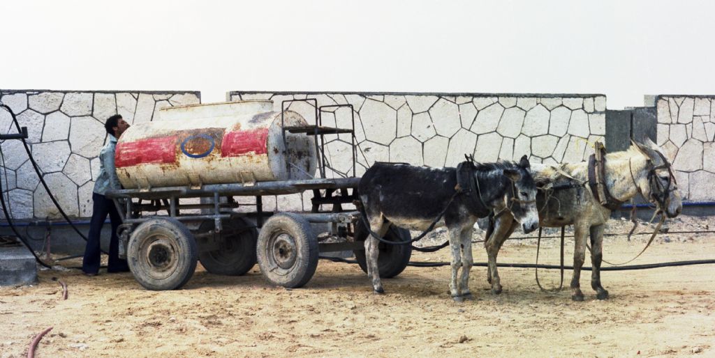

      Here is a challange for the engineers!
      Two friends run a charity for disabled children in Tanzania
      and the hospital/accommodation is on top of a hill. Currently
      water is collected using a tractor and something resembling
      a water bowser (cart with barrel).
      Down in a valley is the water supply, a well, about 3km
      distance and 500m below.
      How can a regular (no matter how small) supply be arranged
      where:
      1. fuel is very expensive
      2. solar energy is almost unlimited in daylight hours
      3. security from theft of the solar panels will be an issue
         and possibly for the pump also
      4. in the valley winds are light
      Storage is easy since there are tanks for retaining water in
      the wet season. The supply of water becomes an issue in the
      dry season.
      I considered Pulsometer pumps since they have no moving
      parts but require a steam supply, (I think). Also solar
      powered pumps at intervals if enough energy is available.
      Any bright ideas?
