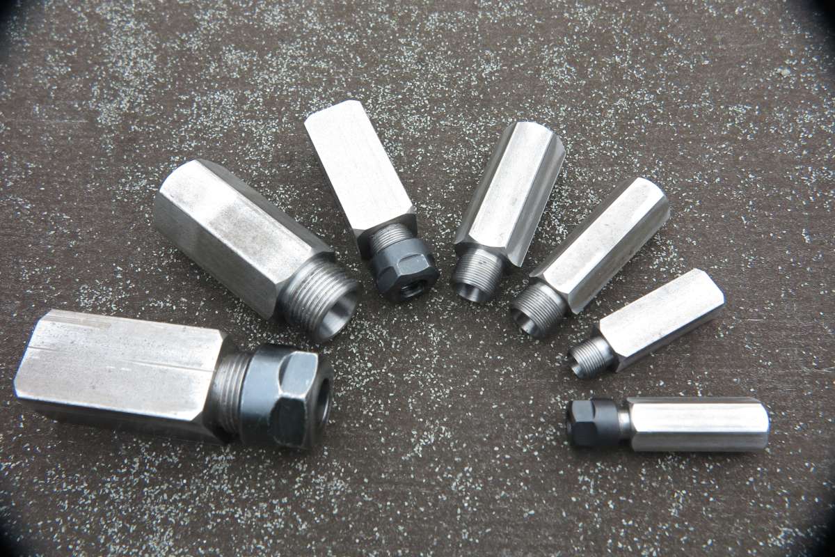

          Now blocks for MT2 and ER16 would be nice to have…
          #843557
          bernard towers
            @bernardtowers37738
            Did some. a while back but have only used one they are ER8/11 and 16IMG_8041
