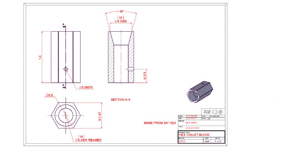

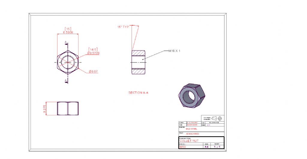

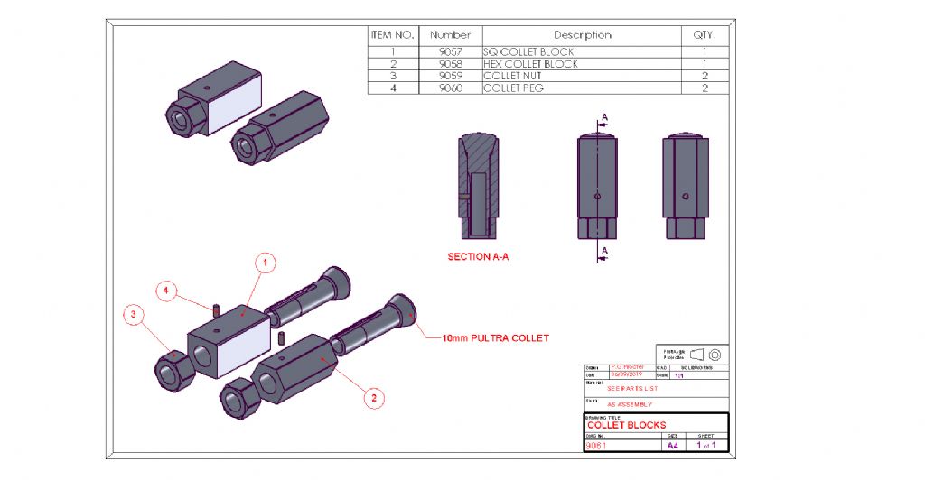

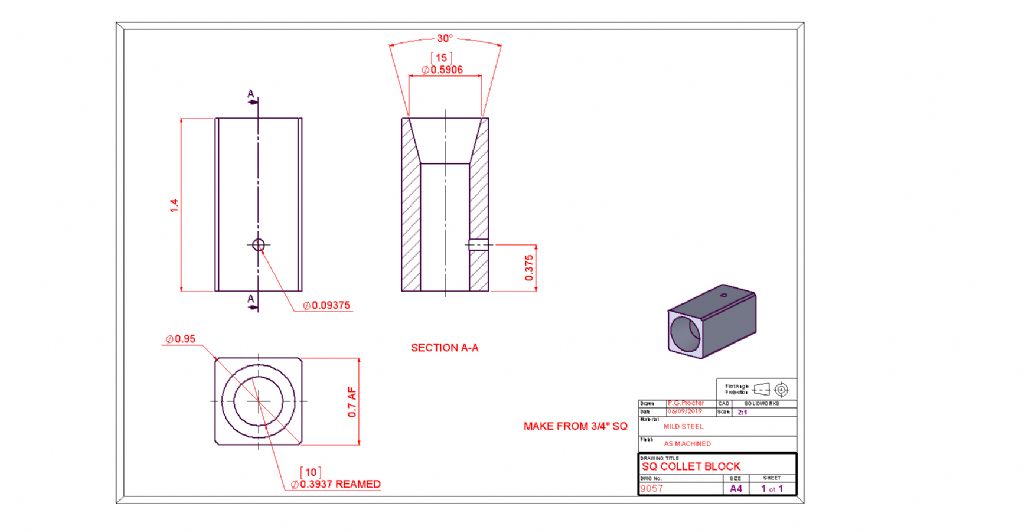

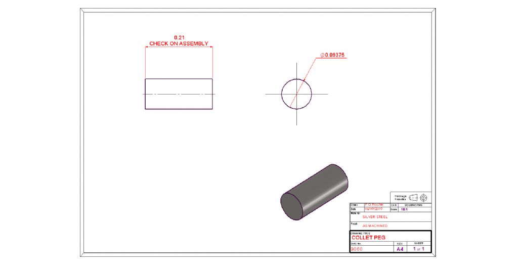

                  #427754
                  Phil P
                    @philp
                    OK, if anyone is remotely interested, here are my Solidworks drawings in JPG format.
                    Just bear in mind that I have not actually made them yet, so they may possibly change.
                    The plan is to bore the 10mm collet hole and taper in the square and hexagon raw materials, then use a mandrel to hold them in the dividing head to finish the flats to size on the milling machine.
                    Phil

                        The one thing I'm always wary of with the 5C blocks is that when you use them vertically they are stood on the end of the collet as it and the nut stick out the end, not a problem with ER blocks.
                        I wonder if this could be avoided if the block were made a little longer and a recess cut for a "nut" that could be tightened with a two pinned spanner so nothing stuck out the back. Possibly make a second larger flanged nut too for when you want that to act as a stop as discussed previously in Michael's linked thread.
                        #427764
                        Phil P
                          @philp
                          Jason
                          Fair comment.
                          I have made the nut so it is machined on both sides and also so that the collet cannot poke out of the end for that very reason. I did wonder about a recessed nut, but thought it over complicated the design.
                          Phil

                            Posted by JasonB on 06/09/2019 11:25:04:
                            [my emboldening]
                            Jason: If you scroll down Phil's recently linked page: **LINK**
                            http://www.wefalck.eu/mm/tools/attachments/attachments.html
                            … to 'Upright Collet Holder'
                            You will see that's exactly what was done [albeit on a much smaller scale than 5C]

                              Hi Phil
                              I have some Pultra 10 collets so I am interested in making the collet blocks'
                              The problem I have is getting the correct size taps to make the nuts for the collet.
                              Could you give me the Tap size and where could I get the Taps from.

                                Be careful here. Pultra 10mm collets are not the same as Pultra10 collets, which are probably 8mm collets.
                                #572518
                                  If you are making the same as Phil's then the thread size is on the drawing . M10 x 1 which is quite common as it is a spark plug thread
                                  The 8mm collets have a thread 0.268" dia x 40tpi, I think I have seen this size tap somewhere as several collets use the thread. Shouldalso be able to single point them on the lathe with a small tool.

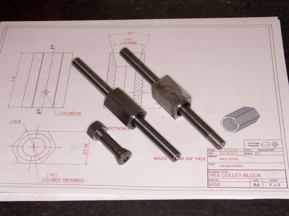

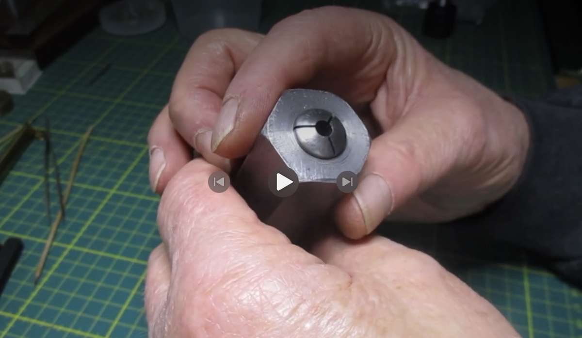

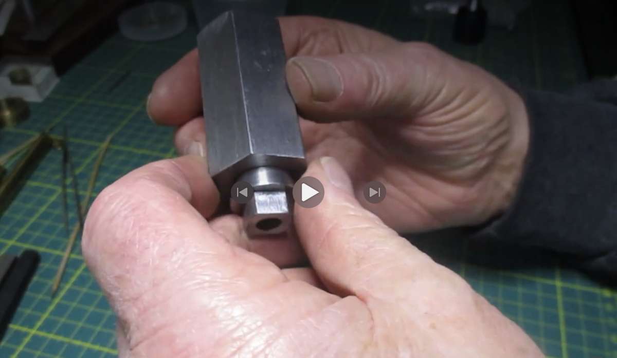

                                      Phil P
                                        @philp
                                        Sorry for the late reply, I have only just seen this.
                                        I did make the collet blocks and have found them very useful.
                                        Workshop 002 10-11-19Workshop 002 05-11-19
                                        #843215
                                        Dell
                                          @dell
                                          I just made the Hexagon one because I can use it for square as well i used it today.so the pictures are screen shots.IMG_4826IMG_4827
                                          #843225

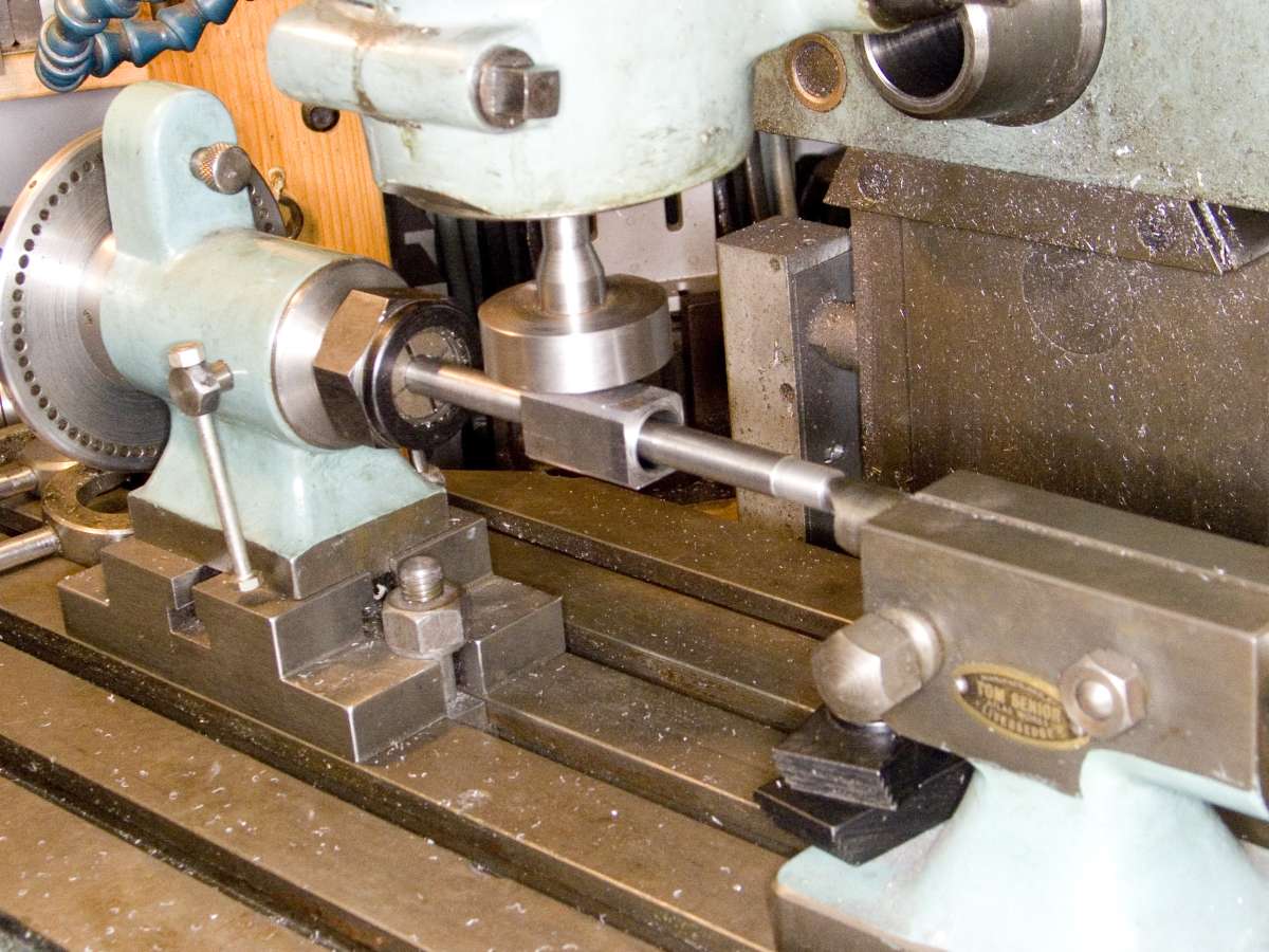

                                          Bazyle
                                            @bazyle
                                            Is the block just jammed onto a taper mandrel for the flycutting?
                                            #843237

                                              Phil P
                                                @philp
                                                Pultra collets are not the same as a BCA (I have both) Pultra are 10mm diameter, BCA are 11mm diameter and much longer, they are like hens teeth to find as well.
                                                I loctited the collet blocks to parallel shafts for the flycutting operation.
                                                Another thing that might not be obvious, the nut to draw the collet into the block was machined to be truly parallel on the two faces and deep enough so that the collet does not protrude right through. This means that the collet block can be used vertically in the machine vice sitting nice and square on the nut’s outer face.
