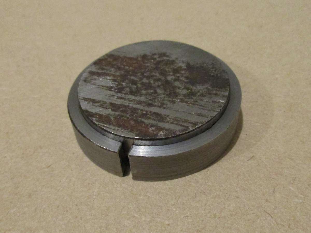

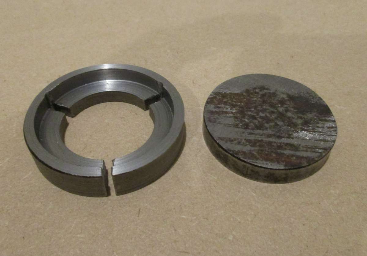

              Hi, another way is to make a split bush as shown below.
              001
              Just face off a suitable size piece bar and drill a large hole that is smaller than the piece you are working on, then cut a slice off, and hold it in your external chuck jaws with the side you faced off, flat against the jaws, and then cut the recess to fit the diameter of the piece you need to finish, making sure you undercut the inside corner slightly, so your piece sits flat into the back of the recess. Then cut the slots with a hacksaw, holding it in a vice with protective jaws, so you don’t damage the machined faces. You then mount the bush in your external jaw chuck, with the slots in-between the jaws, and holding the piece you wish to face off, and making sure it’s pushed back flat with your tailstock, while tightening the jaws.
              002
              Regards Nick.

                  As shown in the split ring photo if you are going to mount a ring on a spigot there must be clearance in the corner of the spigot or a chamfer on the ring. Otherwise your part does not sit true. I suggest remaking the shoulder on the spigot and undercutting the spigot slightly at the internal corner to ensure the (probably) sharp corner of the ring is not sitting up on a radius. This is also important when using soft jaws.

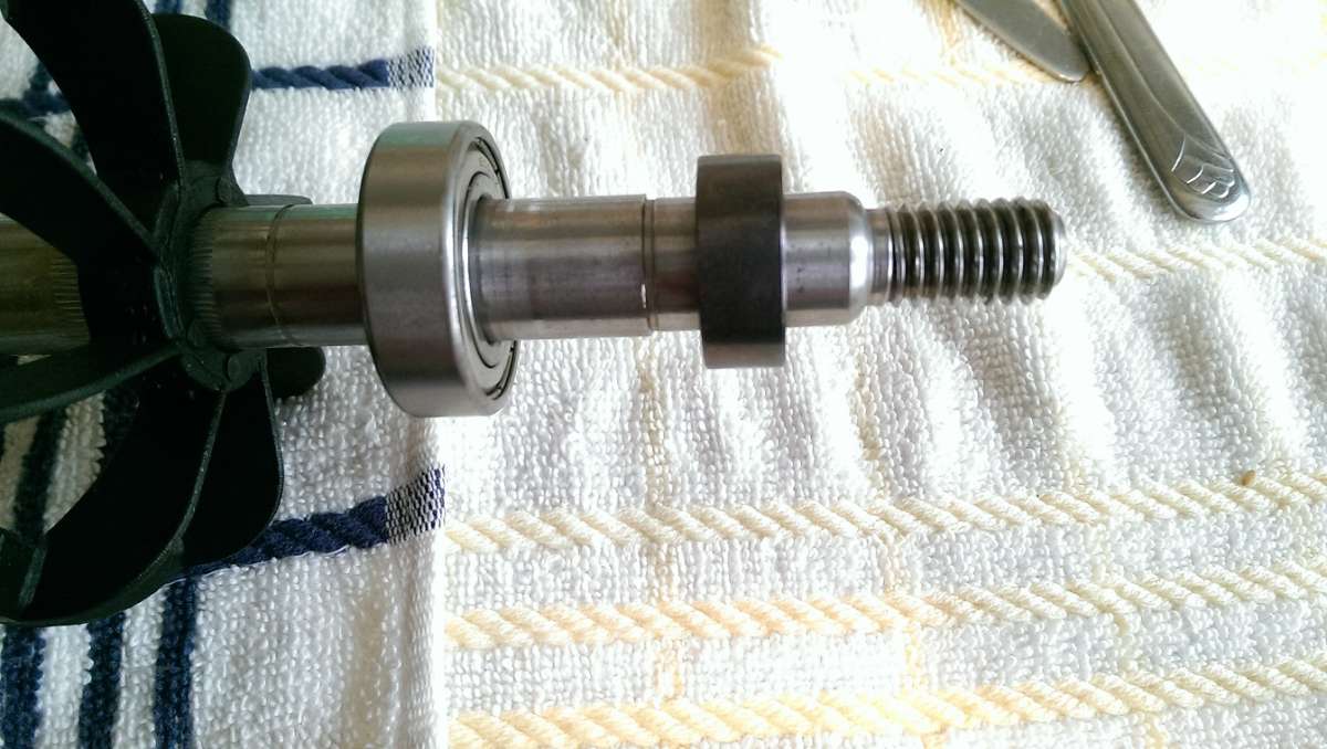

                                              My apologies if I’ve been less than clear.
                                              The bush sits on the grinder spindle to provide a larger surface for the flange that presses against the wheel.  The factory “lip” on my grinder spindle is unbelievably small, only 20 thou in height.
                                              Attached is a picture of the first bush that I made, not fully installed.  I will heat shrink it into position to avoid galling and I don’t want to use adhesive.  It will sit almost entirely on the larger diameter to the right of the bearing, with about 1/16″ sitting on the smaller diameter.  The wheel flange then presses against this larger face.  Then the wheel, outer flange, and nut are fitted.  I’m literally following Harold Hall’s book, except for dimensions and I won’t be using adhesive.
                                              It’s the outer face that needs to be square to the bores.  The inner face doesn’t matter, except if necessary for chucking to machine the outer face.  The entire spindle is quite long and doesn’t fit on my mini-lathe, although I’ll have a try with the fixed steady rest.  The spindle ends are not center drilled for mounting between lathe centers.
