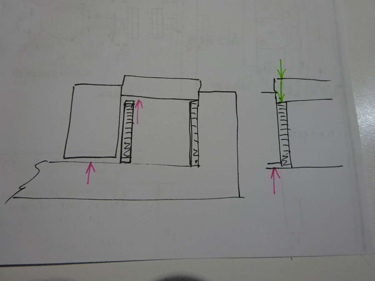

      Tapping forces the part that was raised by the jaw lift back down onto the parallel, not to do with dirt or burrs
      Pink on the left shows the jaw and work have lifted when tightened. Tap the work down Green arrow and that pushes it back onto the parallel closing the gap caused as it raised.
      The “Bounce” mentioned a few posts above is caused by the jaw being pushed down by the hammer at the same time the work is pushed down and then it bounces back up lifting the work with it. The paper trick allows the work some slippage against the jaw so when hit it reduces the chances of the jaw also moving down and then bouncing back up.
      As you say if you don’t suffer lift not much point in tapping down. I do it on the K4, you can see from my table above why I do it as work can lift 5 thou at the moving jaw
      DSC04741

          Like Ian I do wonder how the process of tapping down actually works. Jasons explanation ad drawings are excellent but the various forces involved just don’t feel right to me. Probably a failure of imagination on my part. I know it does something because the shift is “measurable” in so far as a parallel becomes tight after tapping when it was moveable, not loose but stiffly shiftable, before. I frequently find that one side of a parallel becomes tight before the other two. Dunno how much movement is needed to make up the difference between just loose enough to move with a moderate push and proper tight though. Can’t be much.
          What I really don’t understand is that the vice jaws need to be pretty tight before tapping down works and, for me at least, the tighter the jaw the lighter the tap needed. Bonking too hard at final tightening makes the parallel loose again. I generally use one of the 32 mm ( 1/14″) nylon head Thor dead blow hammers with a very light grip. Basically flicking the handle in a partially opened fist rather than holding it. Which seems to work well. Even if I haven’t got a clue why.

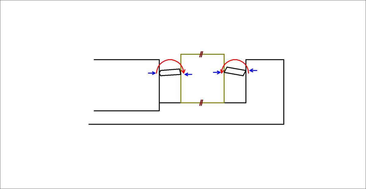

            Taping down works if you do it right (even if you don’t understand the mechanism). But to get work surfaces parallel I was taught to use ‘pull-downs’. These are strips of steel flat with beveled edges, and they are used as shown in the diagram. Admittedly, it is tricky to get the right amount of tilt so that they hold with friction against the vice jaw and the job. When set properly the clamping is actually quite secure even though it looks iffy.  I find that using just one at the moving jaw is normally sufficient and does not require five hands. I prefer the type on the left.
            Pull-down illustration

                It is certainly more of  a problem with thin work being held at the top of the jaws. Charles’ pull downs would unlikely work with just 1/16 “of material in the jaws.
                I would say it goes up as there is nothing to restrain it in that direction, can’t go down as base of vice restrains the jaw and parallel restrains the work.
                Simple example is to place your hands palms down on a table. touch the ends of your middle fingers together and then apply a bit more pressure and your fingers will bend backwards and go up where they meet
                The K4 does not have any gibs and is not a dovetail design, flat base and plates that fit under it to hold the jaw down.

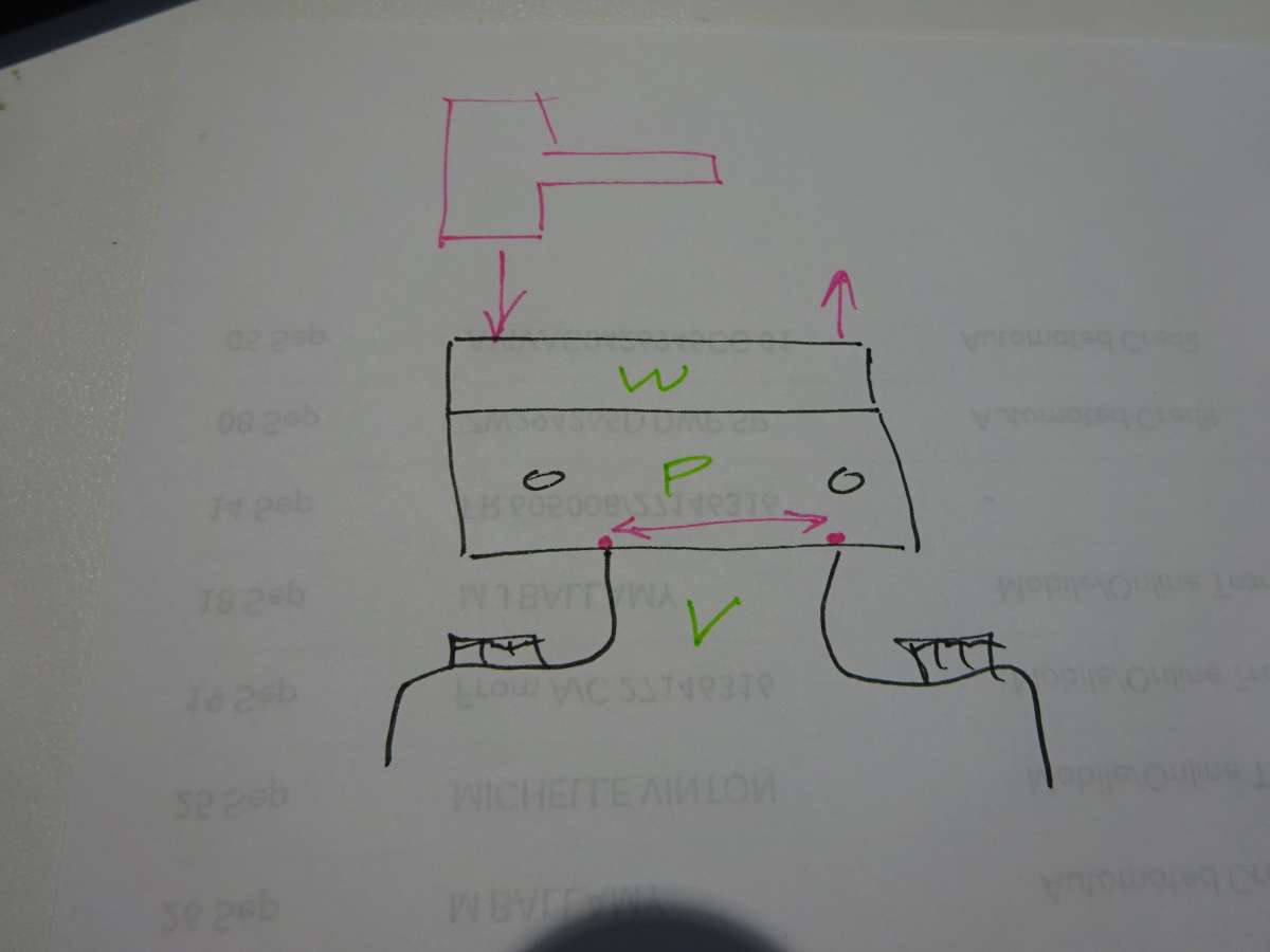

                      Greensands problem is that his parallels only sit on the narrow base. If he tries to seat something down by tapping it then the ends which are unsupported may go down too far and as they do they lift the opposite end. If just hit in the middle a thin part is lilely to remain up at the ends even if down on the parallels in the middle.
                      DSC04742

                          Since the base of the vice is narrow, tapping down at the ends will cause the work to rock. the obvious thing is only to tap down over the base of the vice, to prevent rocking.
                          As said, the risk is that thin material may seat in the middle where it has been tapped down, leaving the ends high.
                          Maybe the solution here would be to check with a parallel, and the tap down, lightly at the ends, before rechceking that the middle section has not rocked and tilted.
                          If this is the case, increasing accuracy may well be an iterative process of tapping down in the middle, checking, tapping down at the ends, checking and repeating until an acceptable degree of accurate levelling is achieved.
                          If you want a high degree of accurate levelling, there  is no short cut, just care with repeated checks and corrective action.
