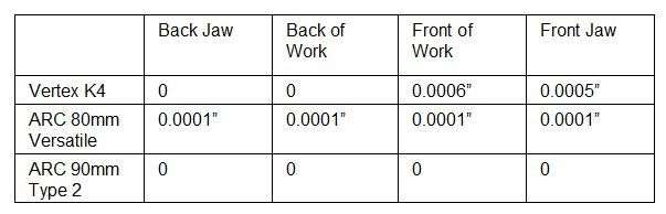

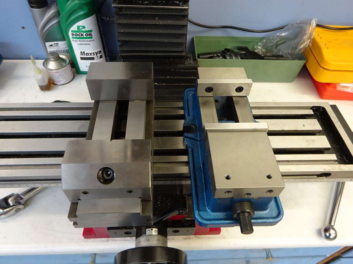

                                  It is based on having two type 2 vices. They seldom get used only coming out for the odd job where they offer something over the two Versatile and one K4 such as the 90mm wide ones taller jaw height which can be useful when gripping a large dia that may have it’s mid point above the top of the other vices jaws.
                                  I posted this some time ago, comparing jaw lift
                                  vice lift
                                  The Versatile is also lower than the Type 2 so a bit more head room to play with. You can also see that the base width is larger on the versatile than the type 2, though I think the type 3 is full width?
                                  DSC02247

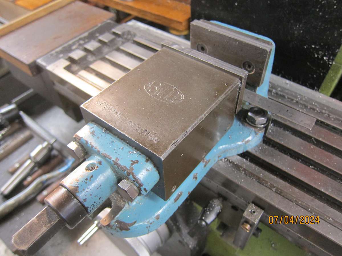

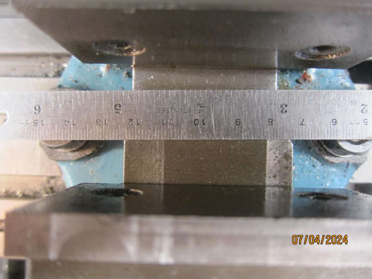

                                            The ARC versatile 5″, 125mm which I bought has had the rear flange cut off to give a bit more Y movement on the mills. When I bought it, I might have gone for the better SG iron ones, but the smaller didn’t open far enough and the larger was really too big to fit comfortably on the mill bed, which is the largest bed fitted on a round column mill with 500mm X axis movement.

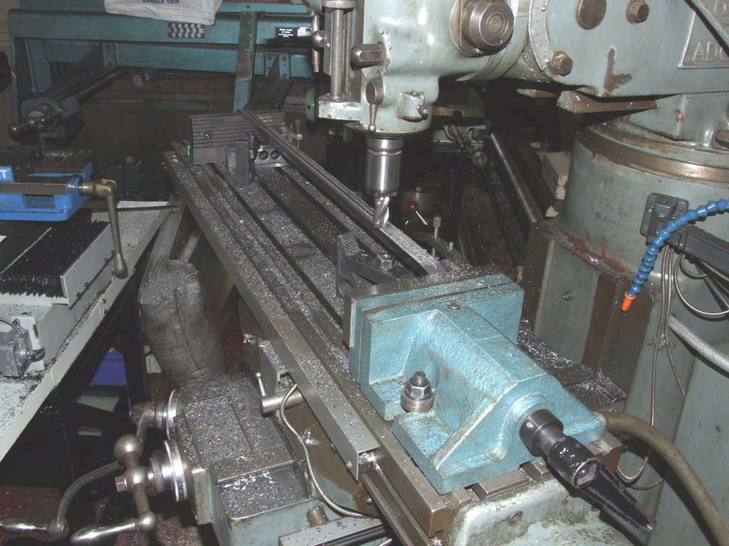

                                                #724768
                                                Anonymous
                                                  On bernard towers Said:
                                                  If you are really concerned about max jaw opening how about a two piece?, your parts would mostly be on the table as well (more headroom).
                                                  Like this, on a 48″ table:
                                                  Machining Pattern Bar Chamfer ME
                                                  I have a machine vice that looks identical to that posted by the OP except that it is not marked Abwood. I never use it now so if anyone is interested let me know. Jaw width is a tad over 6″, so for the larger milling machine.
                                                  Andrew
