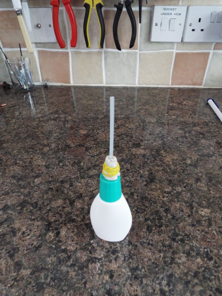

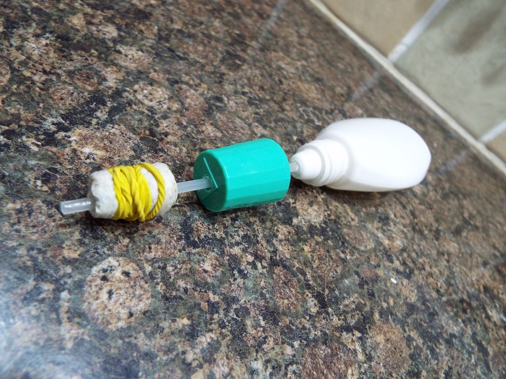

                                                As a slight digression – I always buy the fluids in bulk liquid format not in a pressurised aerosol can.
                                                I find that to get the right quantity where I want it and not everywhere I don't is to modify an old Vicks nasal spray.
                                                Take the top off and pry out the insert which holds the dip tube, pull out the dip tube then drill out the insert from above slightly undersized to the dip tube and force it in to prevent leakage. Then drill the top oversized to allow the dip tube to pass through – fill the bottle with your preferred lubricant then hey presto a droplet control dispenser.
                                                I hope these photos show it better than I have described it. I find a kitchen roll sheet rolled up and wrapped around the dip tube keeps everything dry and clean. I have been using this for years and it works a treat.

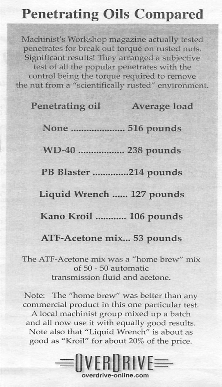

                                                      Just found this photo online and thought this thread would be the most appropriate place for it.
                                                      Rob
