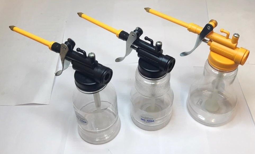

                                        I have a couple of these, no leaks so far wink
                                        The 'nipple' end fits nicely in the bearing type oil points, although you do have to make sure its seated properly or oil sqirts out usually where you don't want it to !!

                                          I bought a couple of the type posted by Steve Neighbour, and find them very good, especially with button oilers. They have good pressure. They have had semi synthetic 5W40 and slideway oil in them for nearly a year now and the plastic still seems oil proof. One has a bendy spout.
