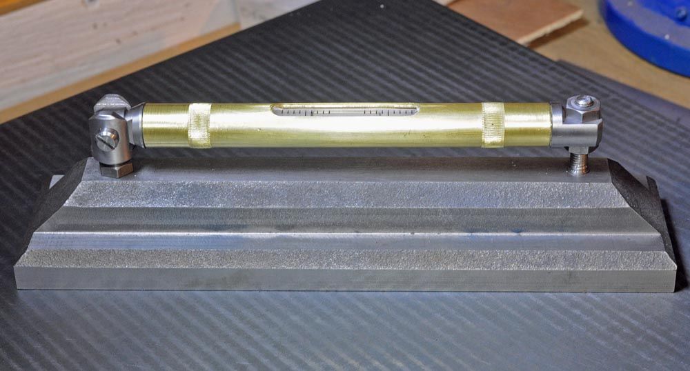

      Hi
      I am about to embark on a surface grinder restoration project and I’m trying to get the right tools for it.
      So I can scrape the ways coplanar I reckon I need a precision level. It would also be useful for my other machines, but particularly the surface grinder as I really want to get it as accurate as I can.
      Some time ago I bought a little Rabone level, which looks like a precision level but isn’t. There are loads of similar “engineers” levels on eBay but very few of them have any info about the sensitivity. I guess I need 0.02mm/m or 0.05 mm/m or ideally the imperial equivalent. There are some Starrett master levels available but they are too expensive.
      I could get a new one from RDG but I am a sucker for vintage stuff if I can get it.
      How can Identify an appropriate level? Is there a model number / size that guarantees I get the right one?
      thanks
      Steve

          There are 150mm long levels and 250mm long levels, graduated in 0.02mm/m
          I have the 150mm long one and wish that I had got the 250 mm long version. The shorter on is more sensitive because it is short. Either one needs to be meticulously clean on the under side of the level and the surface it is placed on. Having said that, I have had a few occasion that the 250 would not have fitted inside the areas that I was checking. The Starrett one I have has no information on the graduations of the bubble , but one whole division is more than the full range of the 150mm precision level. I have a peices of fag paper in the box, and use that under each end, to see if the underlying surface is the issue or not. I don't use blue under my levels to check for high spots either. Having a 150mm flat reference definitely helps when scraping and bluing out a surface.

            Could just replace the vial in your Rabone level?

                      Posted by Pete Cordell on 27/08/2022 03:10:11:
                      I think, with a sensitive vial, you will need some sort of adjustment on the level like this:
                      Rod

                        Good morning, Steve,
                        Some time ago I replaced the vial in my Rabone 18" engineer's level. I described the process with photos in a thread on this forum – I had a quick search before coming to this post but I wasn't able to find it.
                        Here are a few observations in case you, or anyone else, decides to fit a new vial:
                        I bought the new vial from Level Developments. Some people thought that their price was expensive but I thought it fair considering that the vial is a precision component. I wouldn't like to try making them for that price!
                        The word at the time was that Level Developments make that sort of vial in batches and they aren't necessarily always in stock. But Level Developments themselves are, of course, the best source of information on that aspect.
                        There was a warning to be careful to protect the 'pip' on the end of the vial when back-filling the tube with plaster of Paris. I found this easy, my method is shown in the photos on the thread that I now can't find!!!
                        I do confess that I made a boo-boo – I should have painted the back of the new vial with white paint before fitting it. I backed mine with a piece of stiff paper, folded concertina fashion, but it shows through the rear of the vial and looks rubbish.
                        The plugs in the ends of the metal tube that houses the vial are (on the Rabone level, at least ) a push fit but it is a VERY TIGHT push fit. I found them tricky to remove, there isn't an easy way to hold the inner metal tube.
                        On refitting, the plugs need to be refitted with their flats level when the face of the vial is uppermost. And they are STILL a tight push fit and now there's an expensive new vial within the not inflexible metal tube.
                        My preferred sequence would be:
                        Fit one plug to the inner metal tube, taking care that the orientation of its flat extension aligns with the window in the metal tube,
                        Fit the outer metal tube and the two little leaf springs over the inner tube,
                        Fit the remaining plug, enuring that its flat extension aligns with the flat extension of the first plug and with the window in the inner metal tube,
                        Check your bench-top to ensure that you have no parts left over!
                        Refit the vial & tube assembly to the cast iron base of the level.
