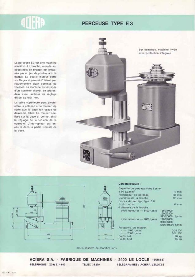

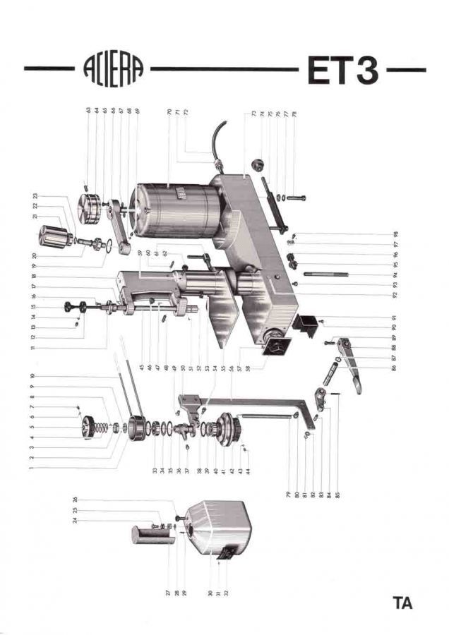

                                        One small step for Man …
                                        The SwissMachines website seems to be giving up the ghost, but the French pages still work, and I managed to grab a couple of images. [see Album]
                                        E3 is the Drill
                                        ET3  is the Tapping Machine
                                        Edited By Michael Gilligan on 05/10/2012 20:10:24

                                          Reading the question attached to the ebay item, and looking at Michael's pictures seems to indicate that this is the tapping version of this machine (complete with one stuck in the chuck, apparently), and in that case, the belt switcher makes a bit more sense.
                                          Although all things considered, I'm going to stick with my Tapmatic…

                                            Although I am perfectly happy with the direction that this thread has taken; I am surprised that no-one has commented upon what originally attracted my respect.
                                            It's like the proverbial "brick outbuilding" … but built to a very high precision.
                                            Check the capacity; then look at the proportions, the size and weight.
                                            Compare and contrast with typical modern "model engineering" kit.

                                              Here are some pictures of the Drill version [E3] with the spindle speeds clearly shown.
                                              By comparison, the Tapping Machine runs at a top speed of only 1750 rpm.
                                              Edited By Michael Gilligan on 06/10/2012 09:08:19
