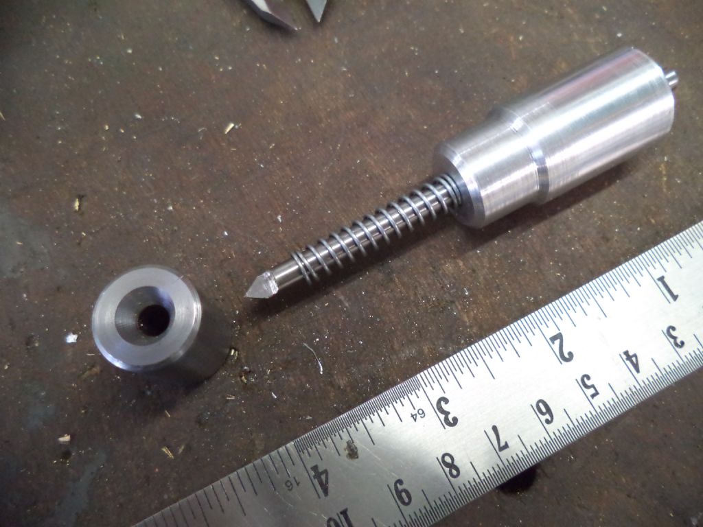

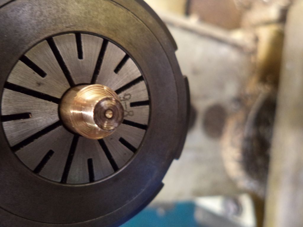

      I been having problems getting the small holes to run true for injector cones from this post it seems like I'm not the only one to have problems **LINK**

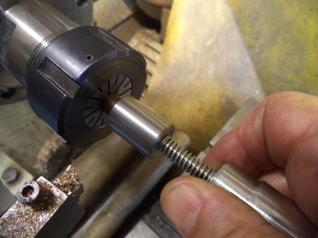

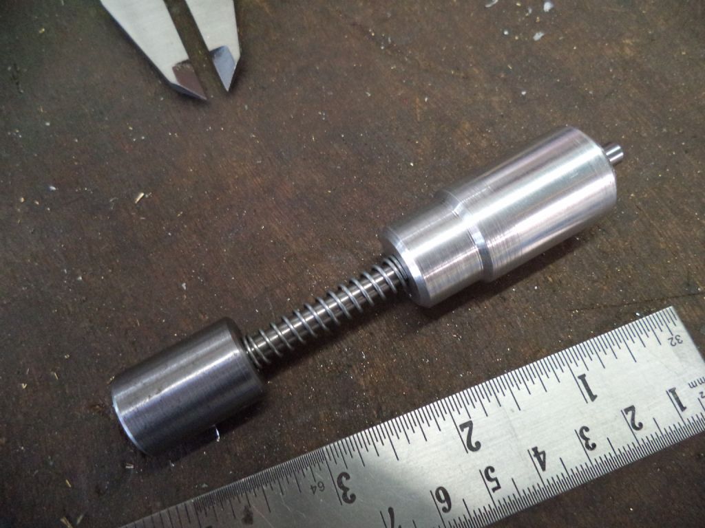

      Have come up with this idea its probably bin done before its so obvious and it seem to work well basically its a piece of 5mm HSS with a 60 deg point ground concentric on the end and sectioned like a D bit this is held in a handle then a light spring and a cone with sliding fit 5mm hole. the cone keeps the tool centred on the bar and you simply compress the spring and the tool cut a nice centre perfectly in the middle of the bar.
