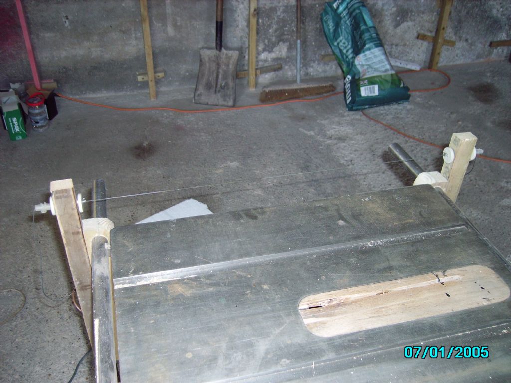

                I used to make big polystyrene cutters for the industry. We used single phase arc welders as the power source and stainless steel mig wire as the cutting wire.

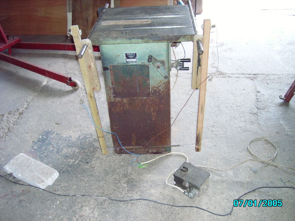

                        I have been doing some testing using my Arc Welder as suggested and a "H" frame. I started with a 2mm copper wire of 150mm length with The Welder set at 30Amps, result it would stick to the polystyrene but not cut, I increased to 50 Amps and it cut slowly but still sticking a bit. I then tried 60 Amps and that was just right the Voltage at 60 Amps was 0.23 volts.
                        I then tried 2mm Brazing rod 150mm length, it cut sticky at 30 Amps and cut right at 50 Amps and Voltage 0.24 Volts.
                        I then tried a steel Bicycle spoke of 2.5mm 150mm length. it cut right at 30 Amps (my lowest available setting) and the Voltage was 1.3 Volts.
                        I then tried 2mm NiChrome wire 150mm length, it cut possibly too well at 30 Amps the Voltage was 1.7 Volts and after several seconds started glowing red!
                        I have been modifying a Transformer from a 4 Amp 12 Volt battery charger,I had ealier tried to remove the laminations from a larger Transformer but they were stuck too fast and I turned to the Battery charger. I have removed the laminations and the secondry coil and intend to wind 2 turns of a heavy guage wire to it. as demonstrated on a web site, I am trying to obtain some fiberglass sleeving. I thought I must make some sort of report back before you all loose interest, I will report on my final result when finished.

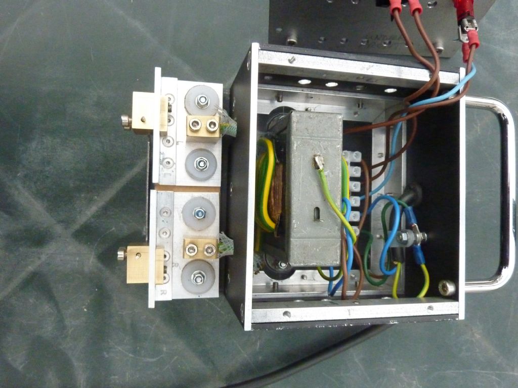

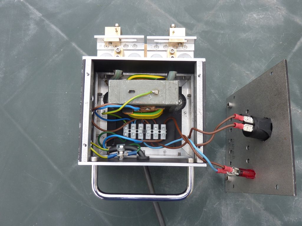

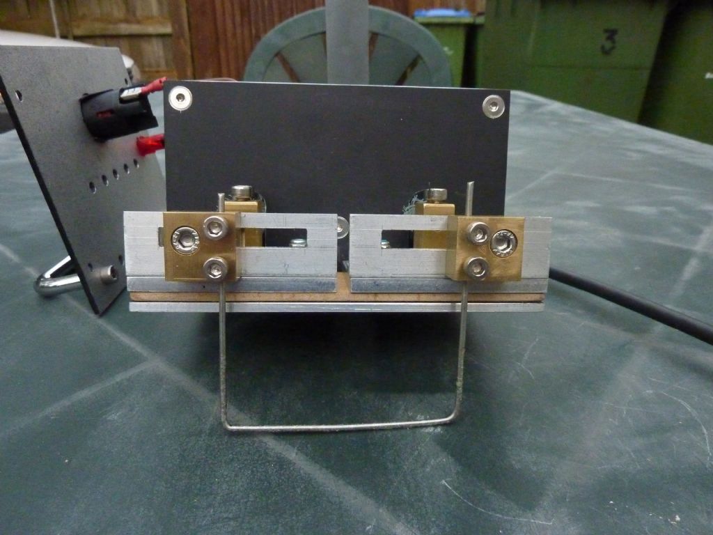

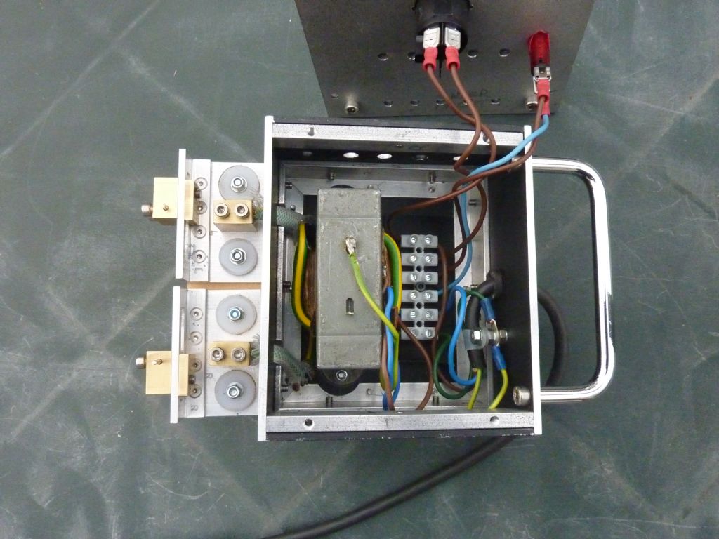

                                          p1060995.jpgp1060996.jpgp1060997.jpgp1060998.jpgp1060999.jpgDear All,
                                          I have finished my Polystyrene cutter and tested it on some scrap pieces, The building extension has been postponed until the spring of 2018 so it has not done any proper jobs as yet.
                                          It has two handed operation to ensure accuracy of cuts and arm fatigue, the thumb of either hand can hold down the ON button, it heats and cools very quickly, there is a red neon to show when it is heating, the width and depth of cut is adjustable, it has two cutting wires one for the fitting of conduit and the other for the box for the sockets.
                                          The Voltage output is 1.4 volts, the cutting wire is 14 guage Ni-Chrome, I found this the best for cleaning after using, the residue scraped off with a finger nail, other metals required the use of a tool. The secondry winding was eventually 7 turns of 60mm square wire that is normally used as earth cabling ie green/yellow.
                                          A Tip is that after dismantling the original TX secondry windings and reassembled the laminations it is possible to feed and wrap the new wire round the former, this makes it easy to experiment with different turns and you can get more on.
                                          Hopefully some pictures will now appear!
