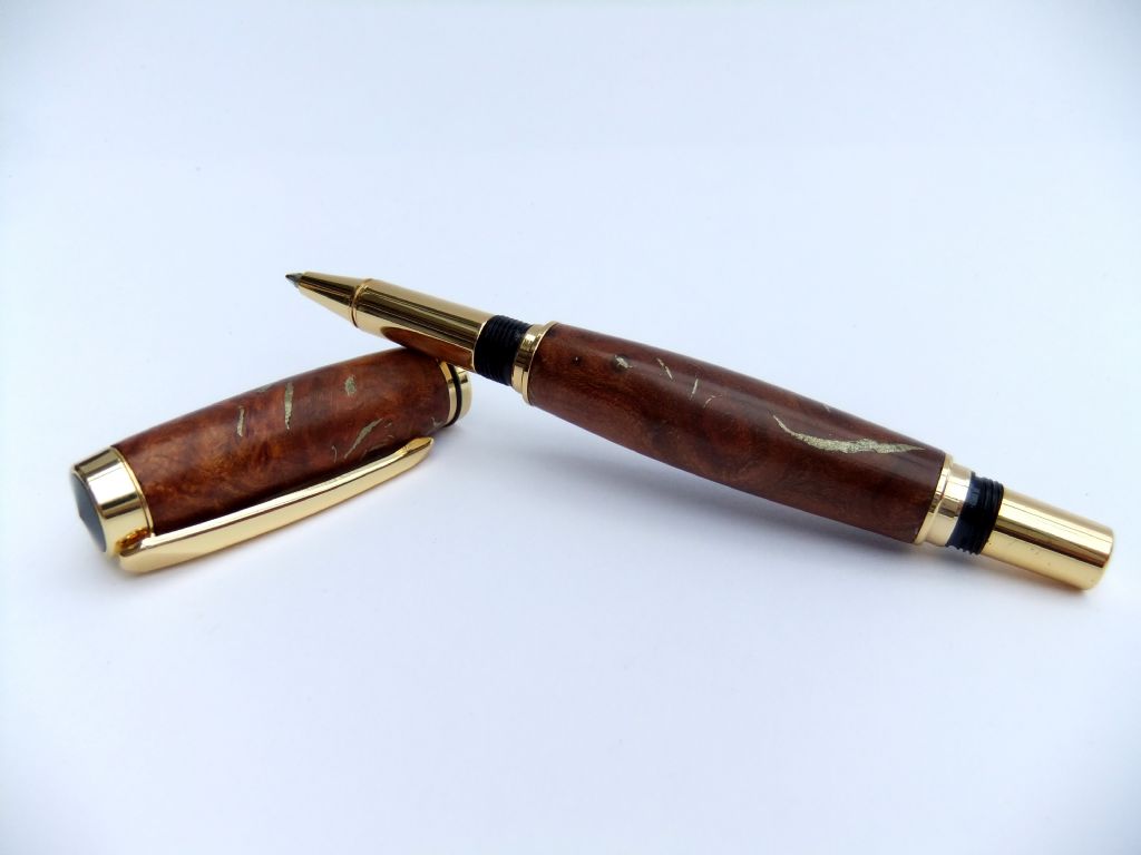

            Dalboy
              @dalboy
              I have used ali, copper and brass powder in epoxy as in this pen. How cast iron will react with the epoxy I do not know so best to try mixing a small amount and just let it set before using it on the casting.
              brass infill pen

                  As a long-time wood turner I'm used to filling (made) grooves with an epoxy/metal powder mix using copper, brass and aluminium to simulate metal inlays and should have thought of this as probably the best solution. In my experience the metal powder needs to be as fine as possible else the polished finish can tend to look a little powdery and 'glittery' – and as Jason B says the epoxy needs to be as loaded as possible. I expect the cleaning up of the castings will give plenty of opportunity to produce fine powdered CI!

                    Dalboy – Nice looking pen.
