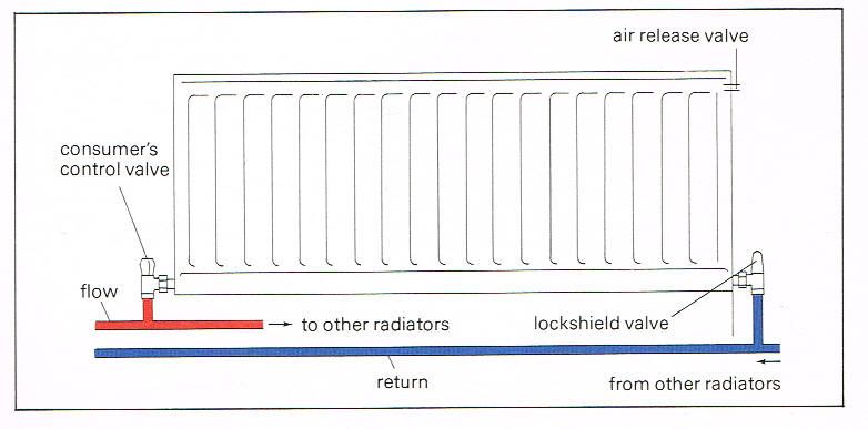

      Obviously a bit off-topic for this forum, but one of the strengths of this place is whatever you ask there is almost always someone who has been there and knows…
      A while back I had some plumbing done and asked the guy to take out a couple of radiators and leave tails terminated by isolation valves so I could fit new radiators myself. He's left one tail longer than the the other in both cases, At the time I thought 'Aha! this must be a convention, the current flows from the long tail to the short'. But now I'm ready to plumb in the new radiators I realise that was just an assumption with no rational basis. Just how I would do it!
      Does anyone know if there is any such convention and, if so, which way it goes?

          I ain't no plumber, but starting with cold pipes, ie heating off for a while, the pipe that heats up first should be the flow, and the still cold one the return. If using thermostatic valves on the radiator, most modern ones work on either flow or return. Or try asking the fella that did the job.

            If the pipes are side by side staggering the fittings is usually done to make it easier to do the nuts up and keep the runs the same distance apart
            As Said flow will warm up first, if you can't feel it due to being along leg then plumb a temporary loop and open the isolating valves and see which pipe gets hot first.
            I would actually say the opposite, it's the modern radiators that tend to be directional particularly designer vertical ones, run of the mill pressed rads can be plumbed either way but watch if using thermostatic valves as a lot of those can be one direction only

                    At one time their was a convention to put the flow on the top corner of the radiator and the return on the bottom diagonally opposite. Some thing to do with efficiency and thermal cycling as the cooling water will sink. I think it goes back to large bore pipe work and cast iron rads.

                                  In theory, the thermostatic valve should be on the flow side, but it will make very little difference in practice.

                                    OK, thanks. I had hoped against hope that there might be short leg / long leg convention as with LEDs!
                                    The dead legs are too long to feel any difference when the heating is on, so I shall have to plumb in a temporary loop as Jason suggests.
                                    I don't understand why it should matter which end the water goes in, but the installation instructions say:
                                    VERY IMPORTANT:
                                    PLEASE NOTE: WHEN CONNECTING THE PIPE-WORK TO THE RADIATOR, THE WATER MUST ENTER THE RADIATOR AT THE BOTTOM CORNER DIAGONALLY OPPOSITE THE AIR VENT AND EXIT AT THE BOTTOM CORNER BELOW THE AIR VENT.
                                    All those boldface caps and underlining make me fear that HELL WILL BREAK LOOSE  if I get it wrong. It would be good if they explained why it is so VERY IMPORTANT but they don't.

                                      As I said you mostly find the modern "designer" radiators have a specific direction, this is because they have baffles and blocked off passages so that the water is forced to follow a route that will heat all the pipes evenly rather than risk it taking a short cut and leaving cold spots. Even on basic pressed radiator sit is usual to have the entry bottom left as most have the vent top right.
                                      I have done some where you get an insert that is fitted from either side depending on where the flow is but only seen that on the more expensive rads from the likes of Bisque and Zehender but I suppose that's what you get when you spent £1000 on a radiator.

                                          Hi Robin, it's quite a few years since I've fitted a new radiator, so it would be best to follow fitting instructions that come with a new one. I have never actually heard or read of the importance of having the vent on the opposite side of the input flow and three out of five of my radiators have the vent on the same side as the input side and I've not had any problems. My central heating was installed about 15 years ago by a professional, but having said that, I found a drawing in a booklet from 1983 from Texas Homecare (remember them) in the scan below.
                                          The only reason I could see about this arrangement for a bog standard or non baffled radiators is that it may reduce the chances of air locks inside the radiators during initial filling. I have never had any problems myself, when for practical reasons for the pipework and access to the air vent, that the inflow has been on the same side below the air vent.

                                              Posted by Nicholas Farr on 15/03/2021 10:20:52:
                                              Regards Nick.
                                              Unless it's actually stated in text that the vent should be on the opposite side to the feed the drawing really isn't really conclusive unless there is another drawing with the vent on the other side marked up as WRONG. After all if you are going to draw the vent you have to put it on one side or the other. That said the general drift of air bubbles would be from the flow side upwards towards the return side however as the vents are not actually at the top of the header there is always going to be some air in the system so I think people are reading too much into the drawing.
                                              We do take drawings as gospel especially when we are unsure of the designers thinking (I'm not just talking about radiators here) when there are often no real reasons why we should not do it differently, changing threads comes to mind when specified taps are not available is one such instance.
                                              More important to have the valve where it will a. Fit and b. Be accessable.

                                                    Bleed valve should be as indicated in the diagram because, if the rad is hung perfectly level, the flow will tend to drag any air towards it.
