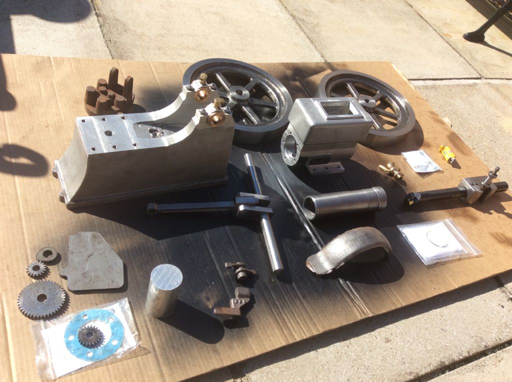

                            MalcB
                              @malcb52554
                              My kit with the bit of progress so far below. Gotta face liner to length, finish bore and hone. Will bring up bore to suit ring gapping when aiming for dead size and if it works out then machine piston to suit.
                              Jason – I do have in mind to do additions on piston to supplement oil transfer and thanks.
                              Henry – Not starting cylinder head yet and will order valve material then, but may well be 316 but will research a bit.

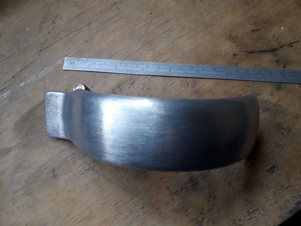

                              Henry Brown
                                @henrybrown95529
                                Looks good Malc! It took me ages to dress that crank guard…20.03.22 crank guard.jpg
