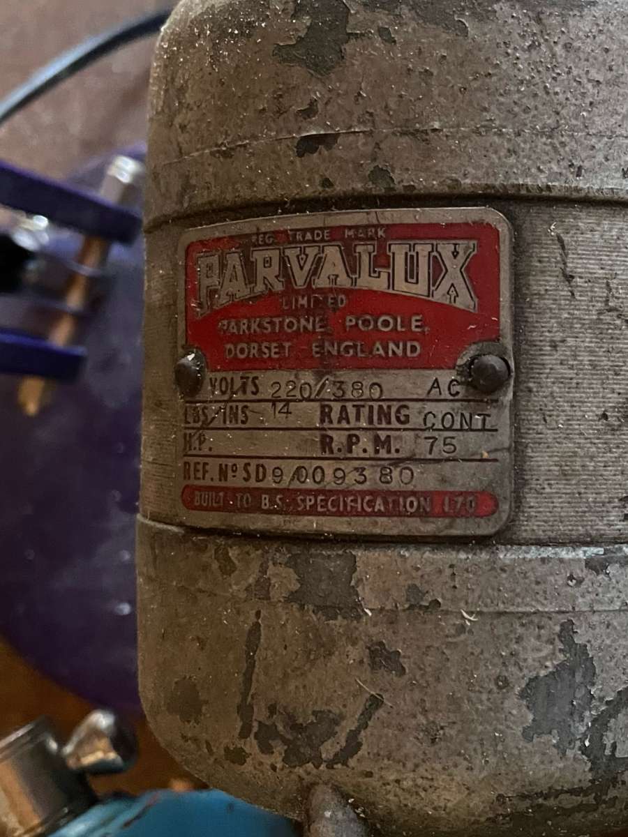

      Hi
      I have a Parvalux motor attached to my Marshall Watchmaker’s lathe, which bears a most uninformative specification plate.
      Surely this is not a 75rpm motor??
      ……..and there’s no fractional HP rating
      Does anyone else have a similarly useless plate on theirs?
      Or perhaps it is a Friday job…
      Mike

        Lots of parvalux motors were sold with a worm gearbox fitted, and the plate gives the output speed of the gearbox. Taking the gearbox off is dead easy, leaving a normal speed motor (probably 1500 rpm nominal) , which is what I had on my little perris lathe.

          I’m guessing it was originally fitted to one of their proprietary gearboxes, with a fixed reduction ratio, to give a 75rpm final output.

            I ‘m with the others, it is the output of the wormdrive box NOT the motor. I have a similar unit in the shed. Noel.

                  That Parvalux motor is also unusual in being wound (or rated for) 220 and 380VAC. Because of its current application driving a watchmakers lathe I presume it is single phase although it is possible that if it was part of some industrial equipment a transformer might have been incorporated. The plate then showing the system rating just like the speed and the torque value (too high to be the motor spindle).

                          1. I have an illustrated 1999 Parvalux catalogue which shows a 75rpm SD8  gearbox unit, which is rated at 35 watts. Wonder if the SD9 is a later iteration of this unit ?

                                  I think the plate seems peculiar because the motor was originally supplied with a reduction gearbox.  Therefore the plate tells us what the output shaft does:  75rpm with a Torque of 14 pounds per inch.   I don’t think the plate is a Friday job, it just relates to the motor/gearboxes original application, where the currency is torque, not power.
                                  14 lbf/in is about 2.5Nm (Newton Metres) and it was delivered at 75rpm.   This online calculator suggests that equates to an output power of about 20W, which seems low to me, but maybe the worm drive was exceptionally inefficient.   Assuming the worm was 50% efficient, then the motor output needed to turn it would be about 30W, roughly 36W input.   However, the motor is rated to deliver that torque through the gearbox continuously, so maybe double or triple the estimated motor power to perhaps 100W input, roughly ⅛HP, which seems reasonable for a watchmakers lathe.

                                    Why do you think the motor plate shows 220 and 380 volts, seems unusual for a such a small motor. The one on ebay seemed to have several capacitors with it, maybe it uses one as a capacitive dropper and another for phase shift.
                                    Maybe Mike will let us know how its wired or when Parvalux reply.
                                    Worm (we are assuming here) reduction gearing must be about 20:1 to get the 75rpm.

                                      The SD8 frame size motors are available in both single & 3 phase; the latter might well be marked as dual voltage.
                                      Single phase motors often have a capacitor as a permanent run, one of mind does; see the 2007 catalogue.
                                      Similarly a 3 phase motor can be made to run on single, with the addition of one or more capacitors, depending on the starting torque requirement.
                                      The presence of a capacitor may well be misleading, if a previous owner has re-purposed a 3 phase motor, wired as delta, and added a phase shift run capacitor across one of the windings.
                                      The clue might well be in the wiring colours, and/or the coil resistances.

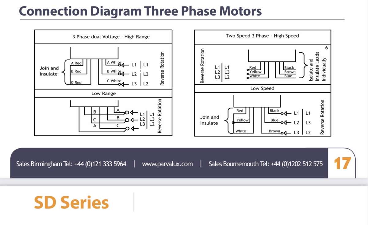

                                          I’m with peak 4, I reckon it’s a three phase motor with a Steinmetz connection to make it run off single phase. How to wire it up is covered in the workshop practice book on electric motors.
                                          It seems like a bodge, but I’ve successfully done it on a grinder. You can’t get full power, but not far off.
                                          #764605
                                            It will require a leap of Faith/Imagination, but as these are the only connection diagrams for the present range of 3-Phase SD motors, they might help Mike interpret his Spaghetti wiring:
                                            IMG_0287
                                            Ref.
                                            https://www.parvalux.com/app/uploads/2021/03/Parvalux_-_AC_Catalogue.pdf

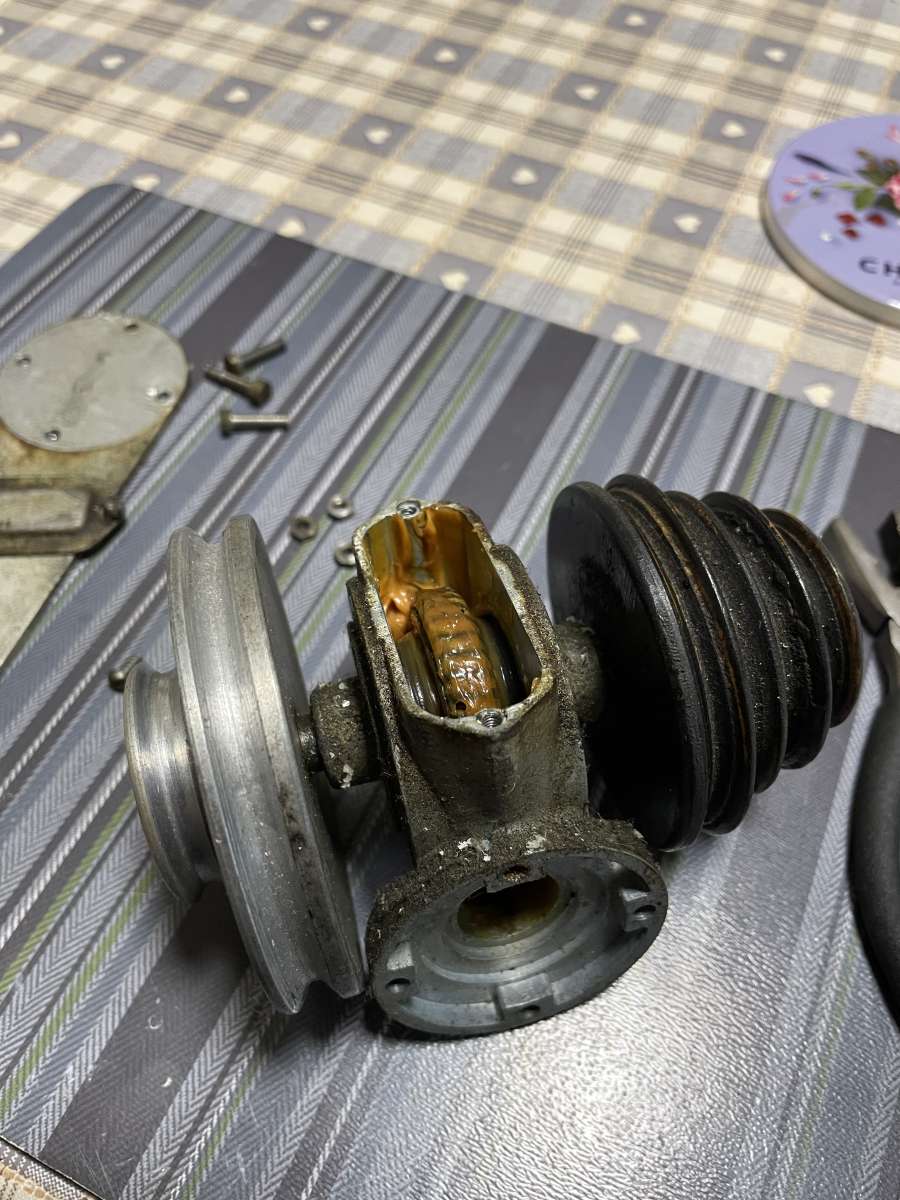

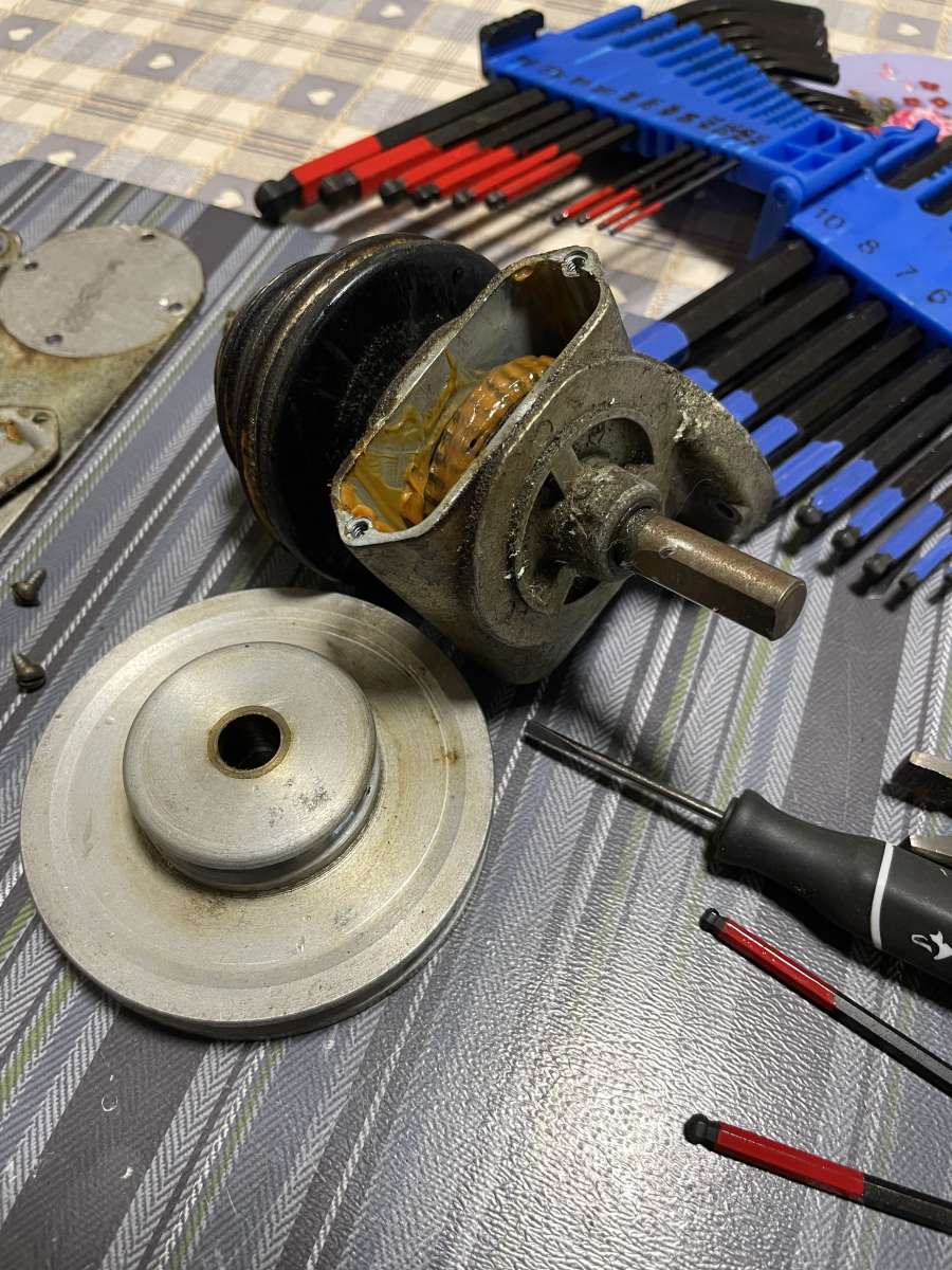

                                              I have made an interesting discovery today, when removing the countershaft from the back of the Marshall lathe.
                                              I’ve always suspected it was a DIY job, and the answer is that it has proved to be the original Parvalux worm gearbox converted into a countershaft!
                                              Somewhere in the scheme of things, the worm has been removed, and the wooden pulley cone has been fitted on to the gearbox shaft – not sure quite how. There are four ‘pins’ in the small end of the cone, so I appears that they are dowels of some kind. The bore at the end of that cone appears to in the order of 8.7mm – though I suspect it should be an Imperial size, as Marshall’s were made in the USA.
                                              The aluminium pulley has come off using a 1/8” Allen key, and itself has two very different diameter pulleys – 1 1/2” and 3”.
                                              Clever…. Or awkward, as it seemed to add more potential friction for the motor to overcome, especially in cold weather! Like now!
                                              Besides, the maximum diameter of metal I am likely to be using will be 1/4” or 6mm, or delicate castings of the wheels I will need to turn down to put steel tyres on, so I don;t think a countershaft will actually be needed.
                                              But those steel tyres will need to be turned with my form tool on the ML7
                                              Mike
