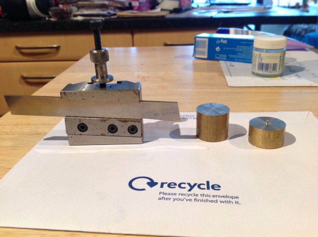

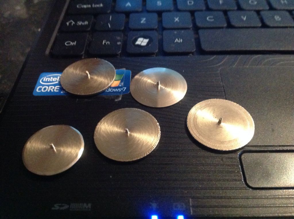

      image.jpgI'm in need of some help. I'm using a HSS parting off tool which is set at centre height with the centre tip of my revolving centre. I've tried parting using both the front and rear tool posts but get the same effect. I've also tried using various speeds with a slow feed rate but still have had no joy. As you can see from the photos I'm left with a small point which is slightly larger that the point of a tack. Can anyone point out the error of my ways?

          Edge of tool not square to the shank?

            just a hought..part snaps off before partoff reaches center..but partoff will face nicely?
            ..try sharpening part off blade like
            / rather than — or if you see what I mean…
            you will have a pip somewhere but you can choose which has it ..part or stock

              Expanding on Jasons advice the parted off piece snaps off when wobble, touching tool, rotation or whatever forces become too great for the tiny piece at the centre to support. Grinding the tool at a slight angle defines which part the main pip is left on. Generally, unless turning far too slowly the small end of the pip snaps near enough flush with the face.
              Make sure you are grinding off all the bevel provided on the blade for clamping purposes when sharpening the "top" (for a front mount tool) cutting face. Its easy to get into a minimal grind mindset and slip into not going down quite far enough. Went through a phase of that error a couple of years back and it took me ages to twig why parting off had got finickity. I grind mine flat on top but there is a school of thought advocating a touch of side rake. Back rake to my mind just wastes blade length and promotes tool pull in with front mounting. Not aproblem with the inverted rear mounting you use. Theoretically back rake provides side clearance behind the cutting area but I dont consider the actual clearance enough to make a difference. Especially not if using coolant or cutting oil.
              Its a common error, especially for those using smaller lathes, to run too slowly. Hand feeding at slow rpm to keep a nice thin chip which won't bind up is hard.

                Grind an angle on the front of the parting tool say about 15 degrees so that the disk / job parts off nice an clean first then carry on and face the pip off . Are parting from the front or back as you said it must be on the centre line Nobby

                  Parting tool is unstable because of too much overhang from tool holder or inadequate fixation .
                  You can see from pictures of parted off components that parting blade is deflecting both up and down and sideways .
                  There is evidence of simple deflection and of vibration in both cases .

                    1. You are parting off brass. It is best to use a back rake of about 7 deg. for steel but zero for brass. Your pictured tool has back rake.
                    2. Yes an angled tip can help decide which side the pip is left BUT it introduces a sideways force. Also the swarf is wider than the slot and can jam. Make sure the saddle and topslide are locked and that there is minimum overhang on the tool to make everything as rigid as possible.
                    3. G H Thomas always recommended grinding a slight "v" (convex) on the front face of the tool and a slight concave "v" on the top so that the swarf tends to curl in and become narrower than the cut. I have used that method for years. I still get a small pip on the work but not like yours.

                          However maybe in this case the material has broken before the tool got to the centre some materials fatigue and break off this way.

                            Looking at the photos the broken 'spigots' are more or less parallel. I think John is right and they are fatigue fractures.
                            Slightly less speed and a sharper tool may help, together with less aggressive feed towards the end, but I would be surprised to eliminate the wee spigot unless an angled tool (which I don't like as it bends) is used.
                            Clipping off with side cutters and filling the stump with a riffler file won't leave any worse than the parting tool has left on the rest of the disc.
                            The discs could also be temporarily superglued onto a short end and faced to a good finish if necessary.

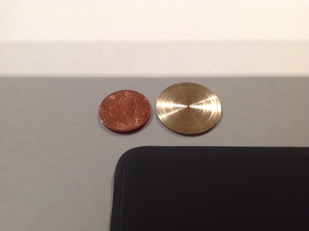

                              I've used a combination of less speed (a really slow feed rate) and an angle on the left side of the tool to overcome my problem. I am still left with a slight pip but it's nothing compared to what was getting.
