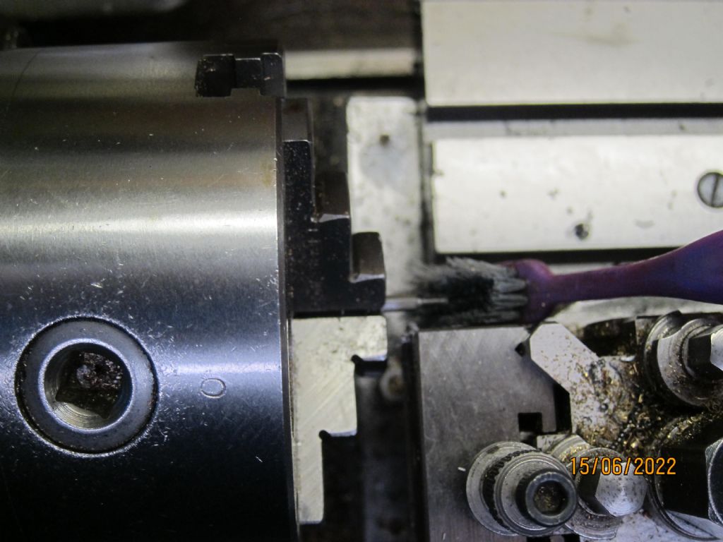

      In the process of making up a batch of 10BA screws I have discovered that in order to avoid the screws from being lost in the swarf it is quite effective to capture it using an old toothbrush. Nothing new under the sun of course but it works for me and it avoids meddlesome fingers near a rotating chuck.

                            With a small amount of cutting oil, the brush will also lubricate as it holds the small parts. I like the brushes with the extended front bristles , as they will reach into the groove being created.
