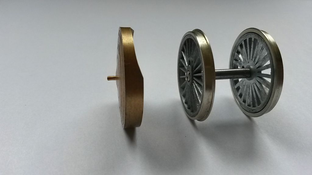

        Problems keeping a right angle cut with the parting off tool.
        #199396
          Thomas,
          Having no text; your post is rather cryptic.
          However; looking at your first picture, I would say that your parting tool is probably wrongly shaped, and not sharp.
          Please let us have some more detail, so that folks here can advise.

            As MG says looks like your tool is being deflected by the cutting tip angle. Or could be the tool is not set truly at 90 degrees to the workpiece.

              From personal experience, have you locked the lathe saddle?

                The tool should be flat topped, and SHARP, The cutting edge is probably best at right angles, and run the lathe fast, and wear a face mask because the chips fly.

                  I suspect it's a demo of how to get an elliptical curve in some part for a loco and that it has been parted off in a way that allows the front to be domed later.
                  Pity about the stub left because it broke off before being fully parted off – usually because the feed was too fast and is why I generally feed by hand. Using the narrowest available parting off blade helps too but in this case some size of pip breaking off is likely but this one looks a bit big. This area makes me wonder why 1/2in x 1/16in blades seem to have disappeared off the market.

                        As Emgee says your parting blade is probably not quite square to the lathes axis or is blunter on the right hand corner. Judging by the pip that is left the tool is ground straight across so that is unlikely to be the reason for deflection as an angled cutting edge can throw the tool off line.

                            But seriously bad drift, an angle is wrong somewhere, the saddle isn't locked and something else may be loose…

                                Parting off blade is too thin for the diameter of the work and set too low? I've seen that somewhere else blush

                                    I use the chuck to square up my parting of blades. This does assume that the face of the chuck is square with the axis of the lathe and doesn't account for the fact that lathes usually face concave. I just wind the saddle along while feeling for when the holder is flat on the chuck and then lock the tool post. I generally don't lock anything else but always have the slides on the compound set fairly tightly and most definitely not loose.
                                    The groove can be widened with the blade. The brave way involves flexing the blade back and forth very very slightly with the saddles rack feed. Really this is just a case of feeling slight resistance to movement via the saddle wheel so isn't as bad as it sounds. The other way is to take full width cuts with the blade itself or leaving a very narrow section. This way the depth the tool is into the "rigid" part of the work can be controlled.
                                    Some times it's just a case of having to leave a little bit of extra material to face off afterwards. Depends what it is.

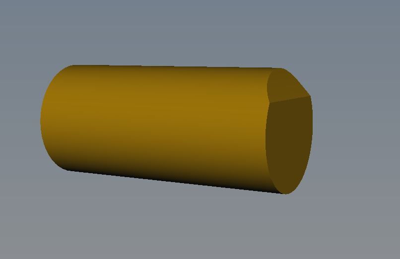

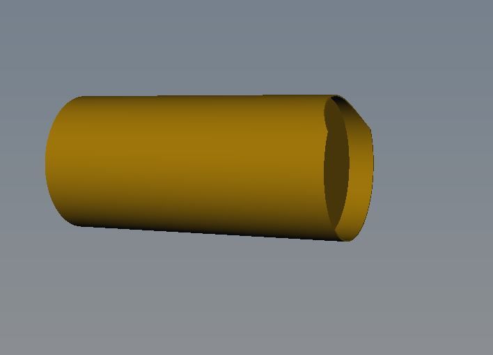

                                        Just thought it may not be the blade that is deflecting, the part could be quite thin and being pushed away from the cut, you can get this when cutting things like thin cooling fins on engine cylinders.
                                        If the "Disc" is as thin as the sides shown on the sketch then quite likely. Maybe we will never know.
                                        If that is the case then turn up a plug to go in the recess with a ctr drill hole and use that to support the work with tailstock pressure until the cut is almost complete then remove while you cut teh last bit

                                              The second image in the original post [note: I suspect they are presented in inverse order] appears to show a piece of bar, with a recess in the end … immediately prior to the parting-off operation.

                                                  Ian looking at this 3D "sketch" the wall thickness around the outside looks to be very thin, assuming that a similar thickness of metal was left to the right of the parting cut then the metal may have deformed rather than the blade deflect. Also in the photo it looks quite a dark yellow metal so could be a bronze rather than brass or at least a softer grade brass.
