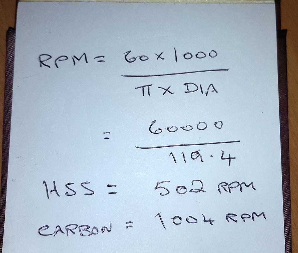

            It’s the speed and feed bit that I am very unsure about. When I run it after it does not sound right, to me and am scared of fing another tool.
            So would this formula work for the speed:
            RPM=SFMx(12/3.142)/work dia inches
            RPM=150×3.82/1.5 = 382rpm
            Edited By petro1head on 14/10/2018 22:25:41

              I have just found Neil’s post with the cutting chart.
              That suggest the SFM for Ali is 200. So that would be 509rpm
              It’s getting confusing
              Edited By petro1head on 14/10/2018 22:07:26

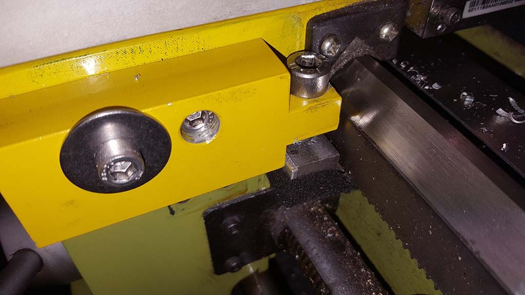

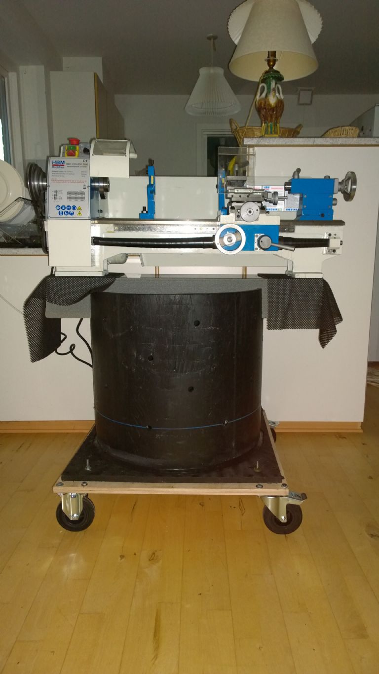

                I am owner of 2018 WM250 and 2011 WM280 lathes and both have a rather stupid compound slide system.
                It looks like something copied from austrian EMCOs.The made in millions 918 lathes has them as well and the first advice on all 918 pages is to scrap it.
                If You want better parting try making a better/stiffer/more direct force path from tool tip to lathe bed.
                Avoid the flex of compound slide and quick change toolholder for parting.
                My new 250 lathe with old floppy tool slide system.Lovely lathe apart frpm compound slide system
                Ny WM250 paa Hjul

                  Posted by petro1head on 14/10/2018 22:06:45:
                  That table is a bit useless without the text that went with it where you will see that David said" for Carbide I would double the shown speeds and industry would be 4-5 times faster".
                  Kind of brings us back to what I said on the first page of this thread 900-1000

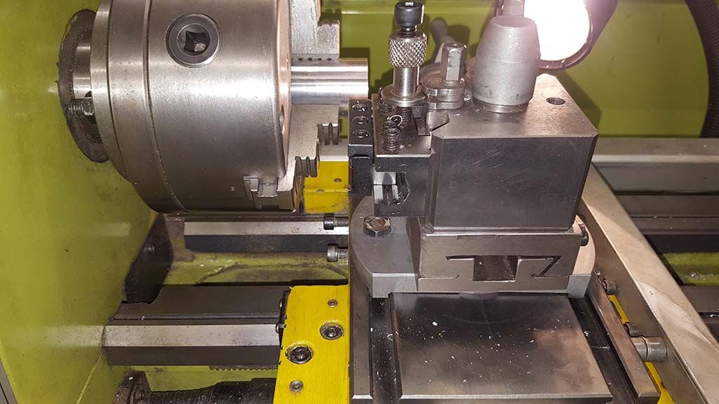

                    I did think the cut from your video looks a bit rough and inconsistant so quickly popped out to the shed for a quick video.
                    Speed is not such an issue and sometimes a bit slower can make things more relaxed and easier to keep up with the lube so did a bit a 600rpm and then some at 950rpm. Also using a slow power cross feed so tool is constantly loaded, the only time you hear a hint of chatter is when I stop the feed to move the camera and that is because tool is not being kept under a decent load.
                    Warco 280VF, Glanze 2mm holder, APT general purpose insert 6082 38mm dia ali, paraffin, 600 & 950rpm. Saddle and topslide locked, topslide well back.

                            Excellent video. This is what I have to aspire to
                            I have moved the tool post so is better located
                            I have added a lock on the saddle that I can access
                            I use the calculation to get the RPM
                            I make sure the work does not stick out too far from the chuck and also ensure the tool does not overhand too much.
                            Use paraffin as cutting compound
                            Make sure everything is locked down
                            Make sure the tool tip is centred and not above ctr and that it perpendicula to the work
