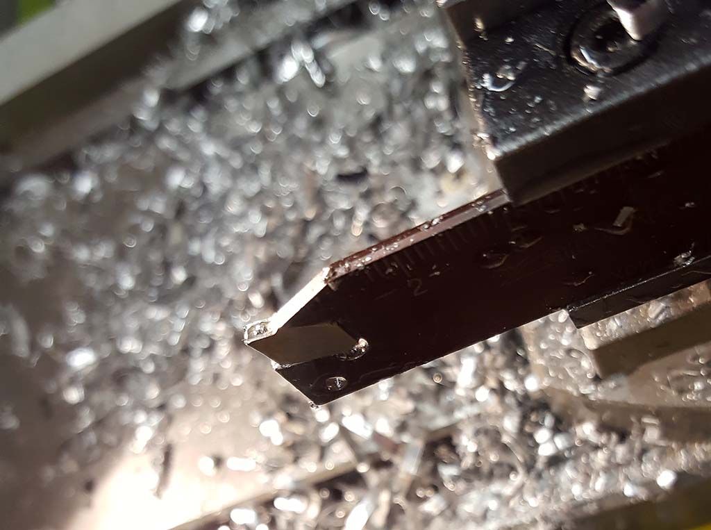

      I am still strugling with parting off.
      I make sure the tool is square to the work. I use cutting fluid.
      However the tool seems to deflect
      This is the tool I am using
      So any idea why its defecting, too thin a tool, its 2mm.
      Would I be better using a 3mm tool instead?

        #375443
        not done it yet
          @notdoneityet
          Do you lock the carriage and top slide?
          #375444
          Brian Sweeting 2
            @briansweeting2
            Reduce the amount of tool sticking out from toolpost may help a bit.

                #375447
                petro1head
                  @petro1head
                  Posted by Brian Sweeting on 11/10/2018 11:07:08:
                  Cant because its the right length for the work

                    #375451
                      On a deep cut you may find it better to set the tool projection so it will go half way and then set the tool further out of the holder to complete the cut.
                      A 2mm blade should be OK, thats what I use and don't get any deflection. If one corner of the tip has become damaged or worn that will also tend to push it sideways

                                        #375471
                                        Mick B1
                                          @mickb1
                                          My two penn'orth:
                                          Looking at you photo of the tool, I'm thinking I can see a tiny wedge of support on the lower edge of the insert location that suggests the insert is skewed rightwards. Can't tell if the insert is properly vertical or not, but if it isn't the right-hand side of the tool might be rubbing, unable to cut, and so forcing the left-hand side to dig in further and deflect the supporting blade that way.
                                          The fact that there's also a significant bit of the support projecting forward underneath the insert suggests to me that there's summat up with its location.
                                          #375473
                                            I also noticed that Mick, maybe the holder has been twisted in a previous lock up.
                                            If you are cutting 38mm ali then why do you have a good 35mm plus of tool sticking out? I can see the "2" showing part way along which indicates 20mm projection and that is enough to go through 38mm stock.
                                            Speed wise put it in the slower speed range but run towards max 900-1000 and feed briskly.

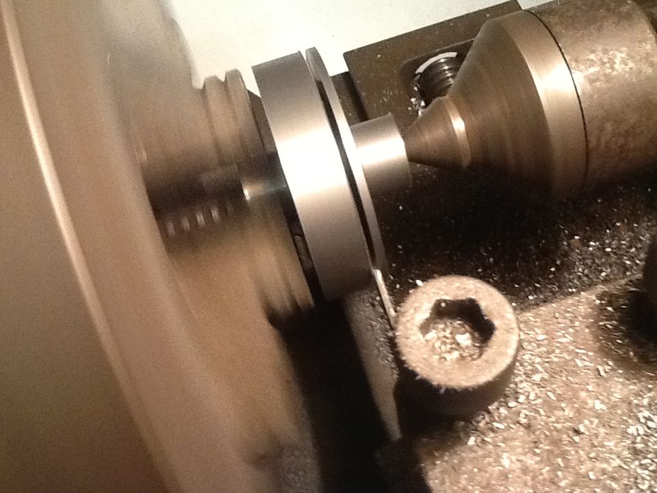

                                                  #375484
                                                    Posted by ega on 11/10/2018 12:30:27:
                                                    JasonB:
                                                    Did you use tailstock support and if so at what stage did you retract the centre?
                                                    In that case I did, if you look at the chuck jaws you will see that they are closed up on what is a fairly small chucking spigot hidden out of sight. I did not want to take any chances of the force from the parting cut pulling the work out of the chuck, probably removed the tailstock when I got down to about the diameter of the chucking spigot. This is someone else doing the same thing on the same engine part.
