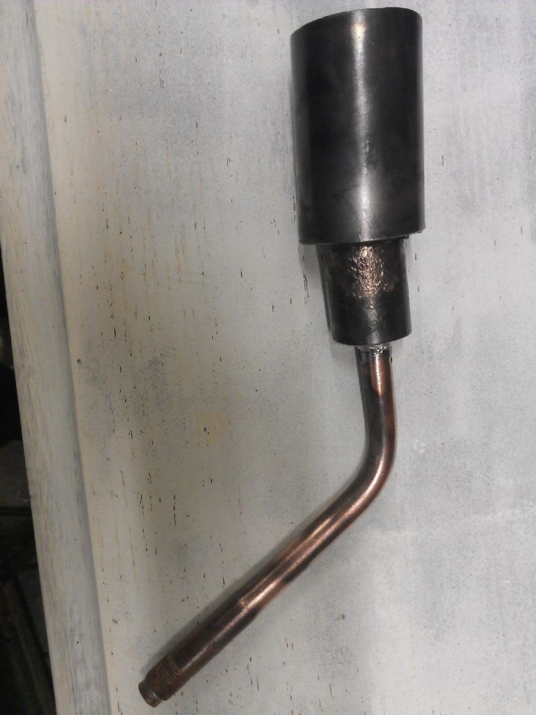

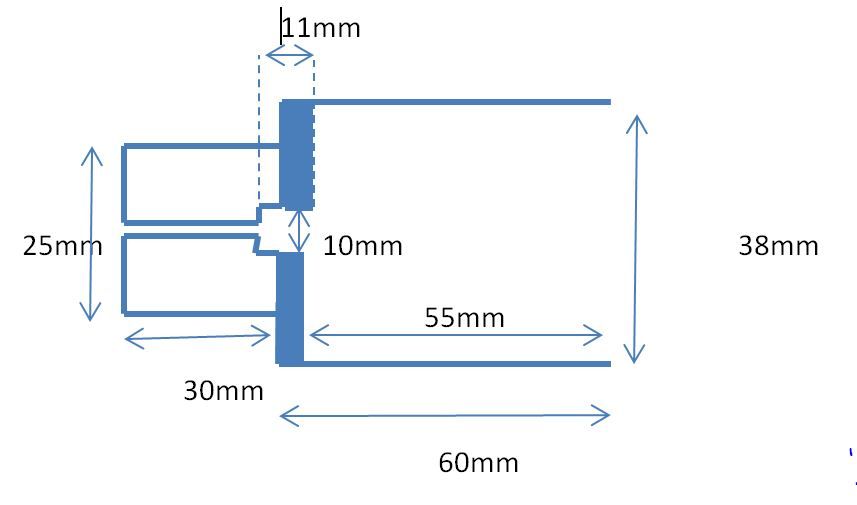

                          #410653
                          James A
                            @jamesalford67616
                            Posted by John Rutzen on 23/05/2019 08:17:11:
                            Hi James, that sounds very interesting, Please could you give me a link to the websites you found the information on. Thank you.
                            This is the page which set me thinking. https://sites.google.com/site/gypsytinker2012/how-to/make-a-mako
                            My first attempt worked well, but the flame was rather bushy and lack direction. My second attempt was much more effective. It had a longer, narrower tube and more slots. I experimented a lot with sheet rolled into a tube to slide up and down the base part to try and get the optimum length.
                            The details below are for the first version which I made. I shall post a picture of the later version if you wish.
                            I had a disused oxy-acetylene torch and made a new nozzle to fit onto a swan neck. The sketch below gives the main dimensions, none of which seems to be too critical.
                            I made my torch before I had my lathe working, so everything it rather loose and wonky. I brazed it all together and it works.
                            I connected the air line from the torch to the hose from a compressor and the gas line to the propane tank. I have blow-back arrestors in both hoses. I use the torch with the compressor and propane set to full.
                            The settings on the torch controls themselves is quite critical and needs careful setting. However, once the right combination of gas and air is found, the flame is quite compact, extremely hot and very noisy.
                            This short video shows the torch running. The flame is off-centre, mainly because the whole thing is a little wonky. **LINK**
                            Edited By James Alford on 23/05/2019 21:26:29
