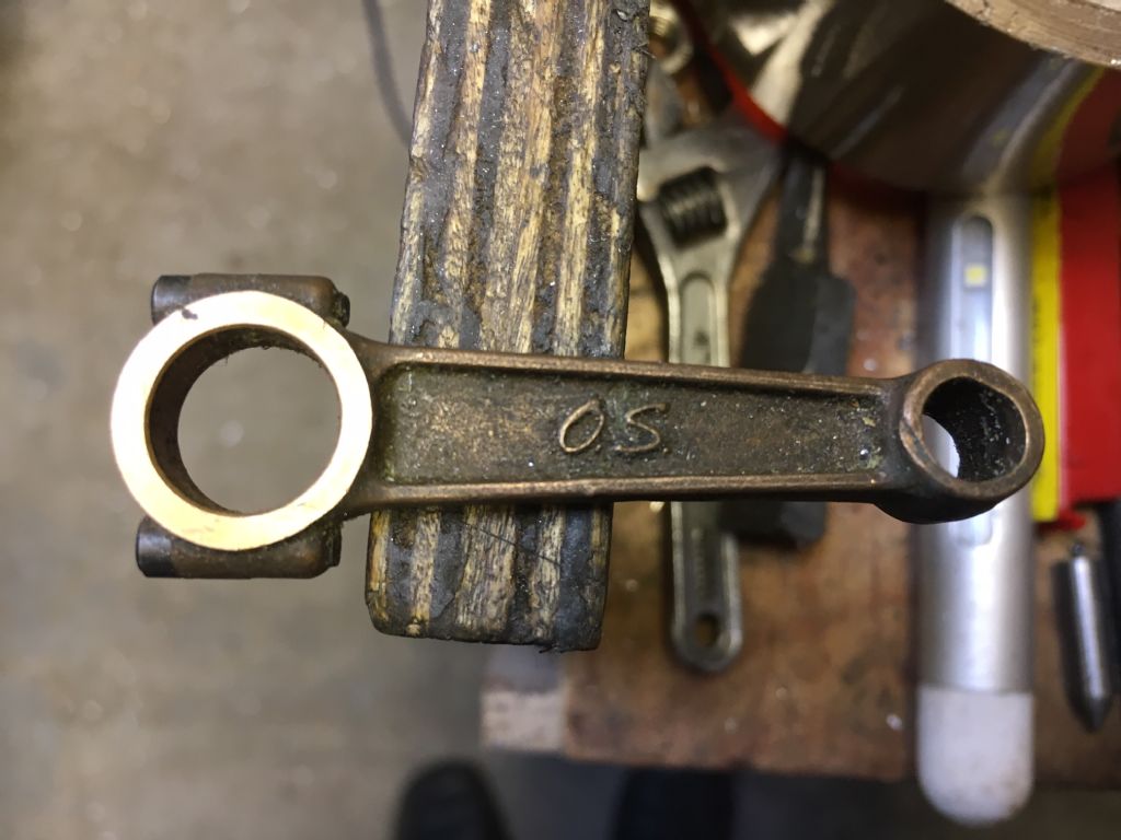

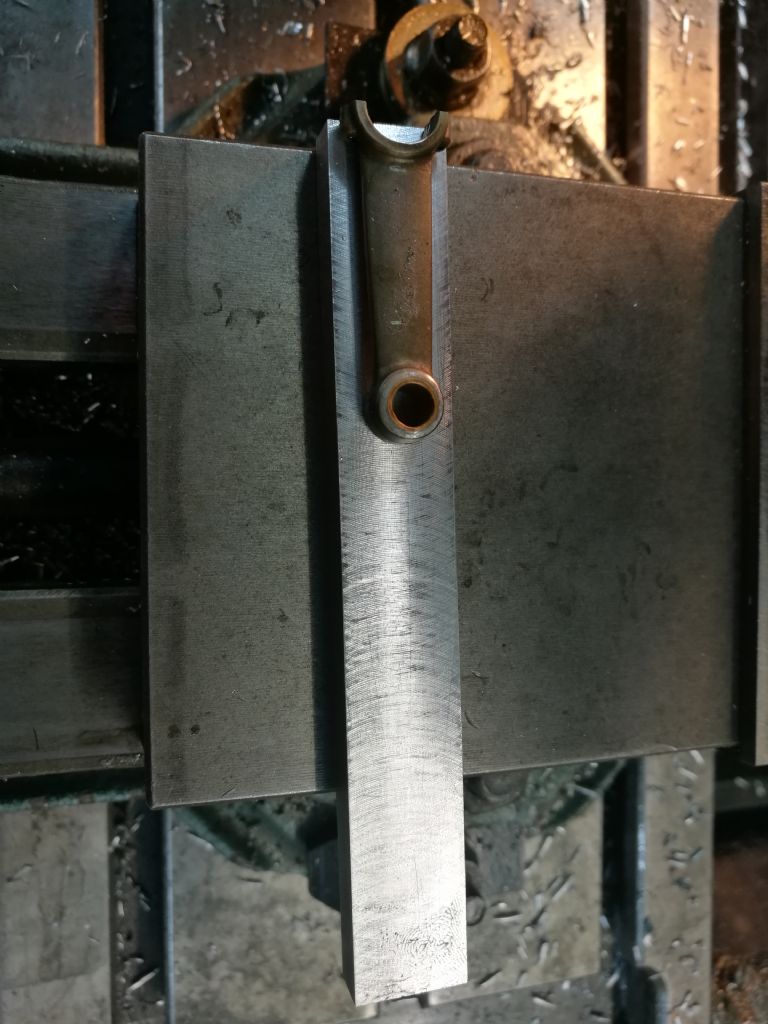

                            #308069
                            Bob Rodgerson
                              @bobrodgerson97362
                              Hi Mick,
                              I've just finished a session in the workshop but took time out to find the con rod. It was a little battered here and there with a bruise on one of the faces of the little end so I ran an adjustable reamer through it to clean that up.
                              Three are a couple of marks on it but it looks to be OK. I would gently smooth out these marks to prevent them becoming stress raisers.
                              Contact me via the message board and let me have your address and I will try to get it in the post on Friday, hopefully you will get it by Saturday, unless of course you live in the South Manchester area and you could always drop by and pick it up.
                              Here is a picture of it before I ran the reamer through the little end.
                              On the other side of the big end there are two reference marks 180 degrees apart on the face of it in line with the centre line of the con rod.

                                #308118
                                Bob Rodgerson
                                  @bobrodgerson97362
                                  Hi Mick,
                                  the newer rods are dimensionally identical to the original and are made from tougher bronze than the original type so there is no problem with conversion. I have sent you the old one I had and it will be with you tomorrow. I would recommend fitting the newer type, however, if you can't get them then at least you will have a matching pair of older type rods which will be OK.
                                  If I had to replace the rods I would make a new pair from Aluminium Bronze which is much tougher stuff than the old rods bronze that was originally used. A High Tensile Aluminium Alloy would be best but am not sure how it would affect balance/vibration

                                    #308139
                                    Bob Rodgerson
                                      @bobrodgerson97362
                                      Dean,
                                      it would be easiest if you were to copy the one I have sent to Mick if he wants to go down that route.
                                      #308140

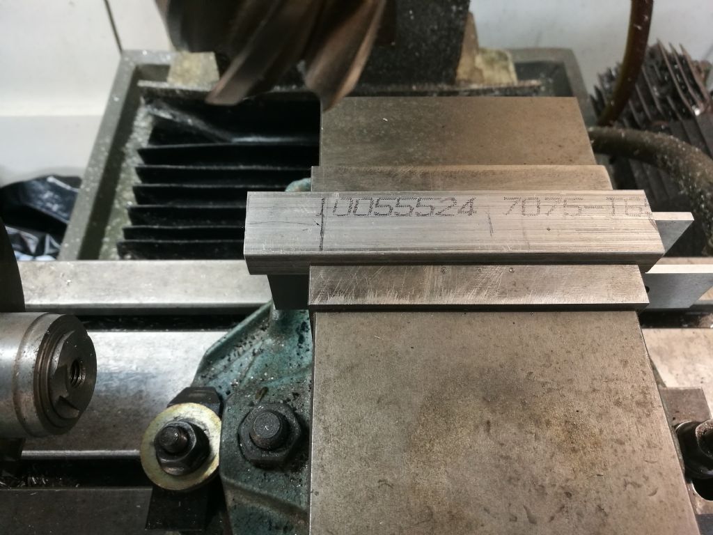

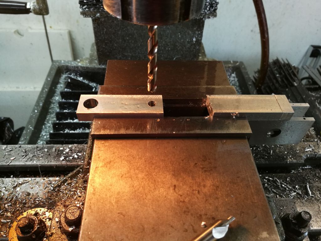

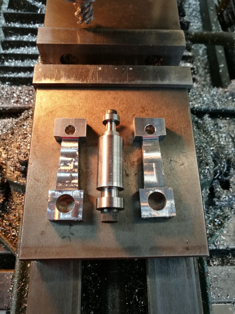

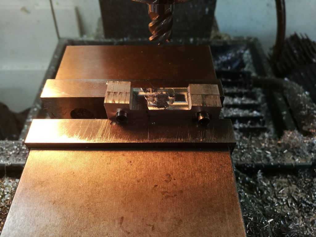

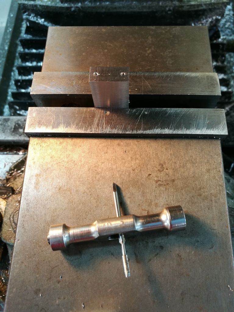

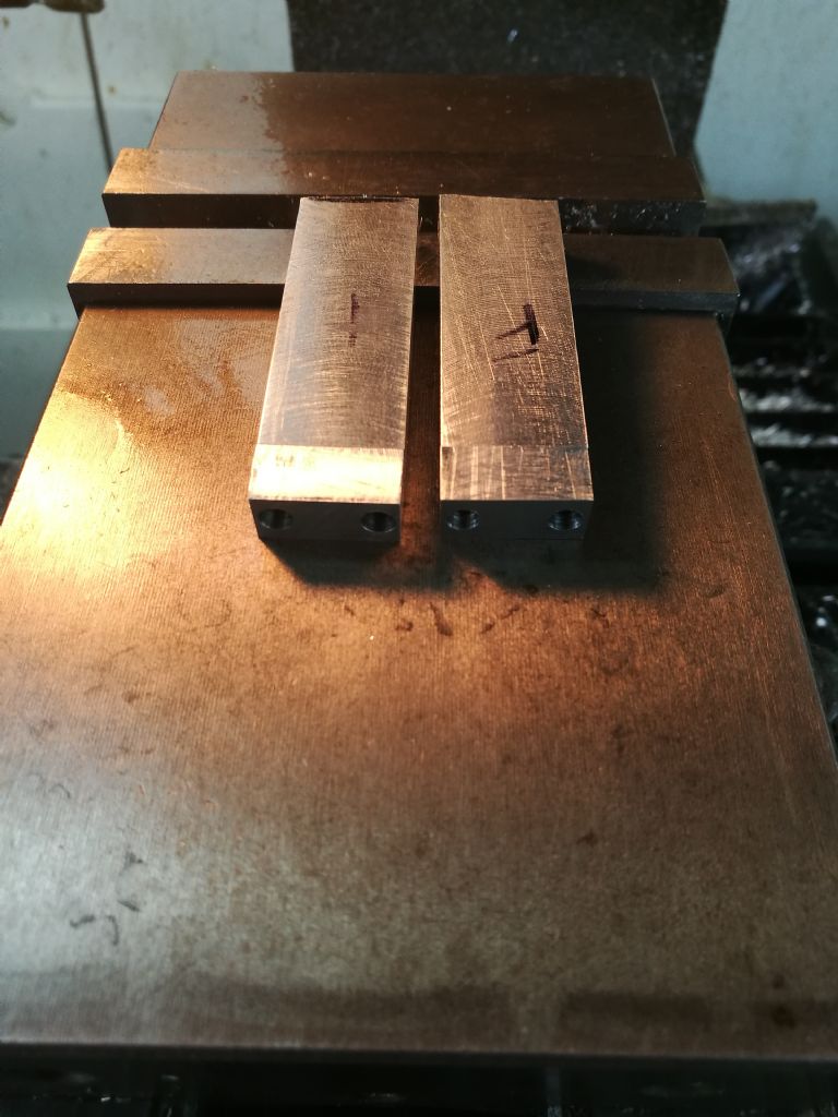

                                          #335657
                                          dean clarke 2
                                            @deanclarke2

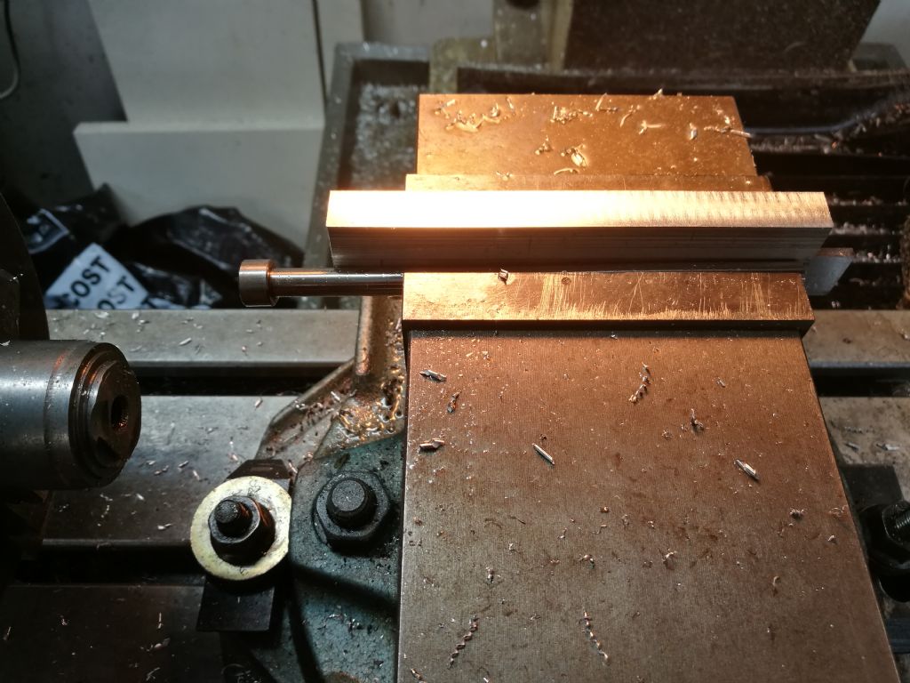

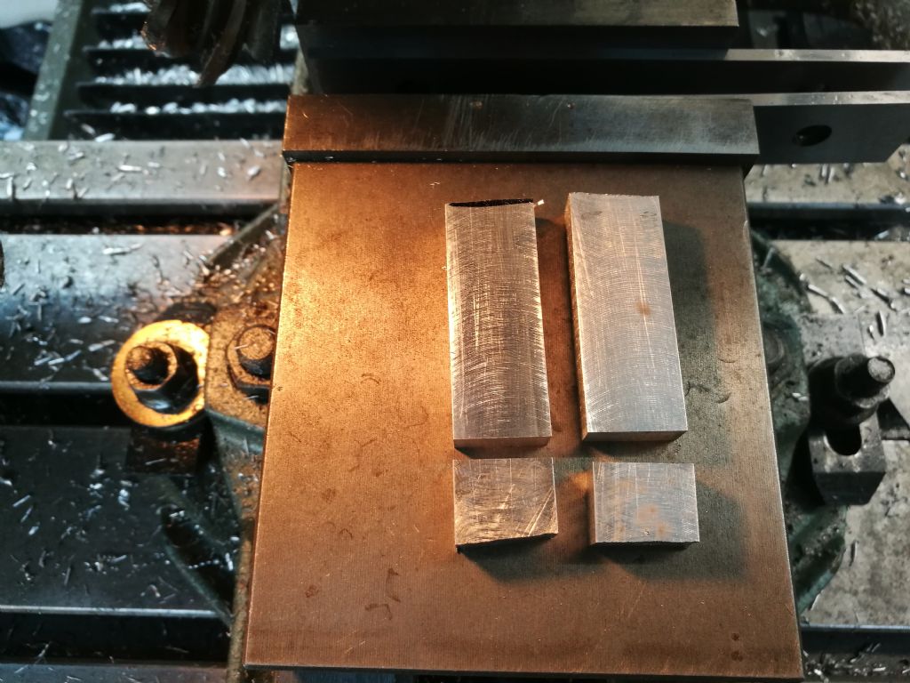

                                            Well I've finally found some spare time to get on with this help out project, here's some photos to show progress etc.
                                            conrod blanks square up
                                            conrod blanks square up2
                                            conrod blanks square up3
                                            conrod blanks ready to drill

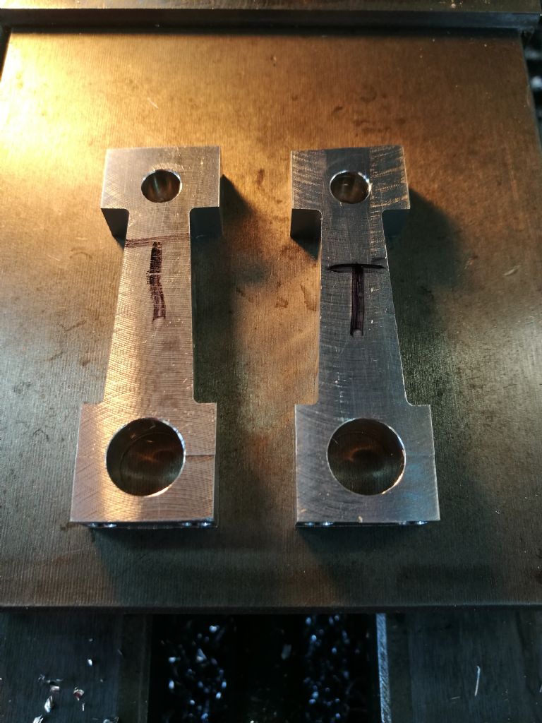

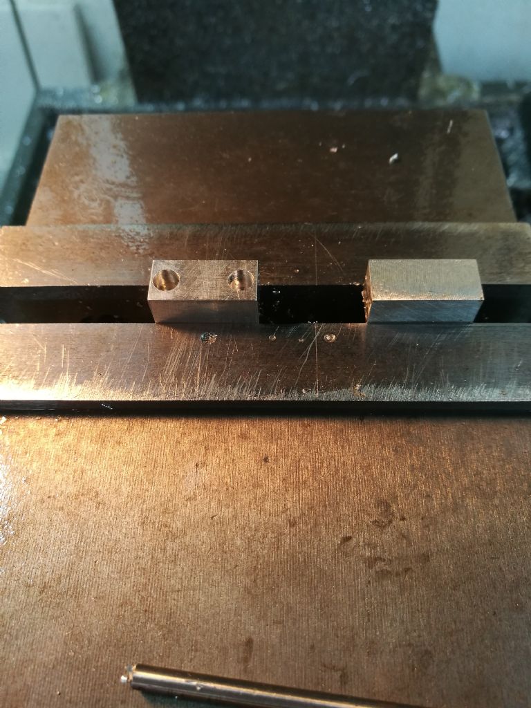

                                            Now for drill the big end caps etc
                                            conrod blanks drilling big end
                                            caps……..
                                            conrod blanks drilling big end2

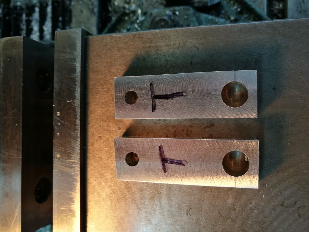

                                            conrod blanks ready to drill bearing holes
                                            Drilling and reaming the big and little ends
                                            drilling big and little ends

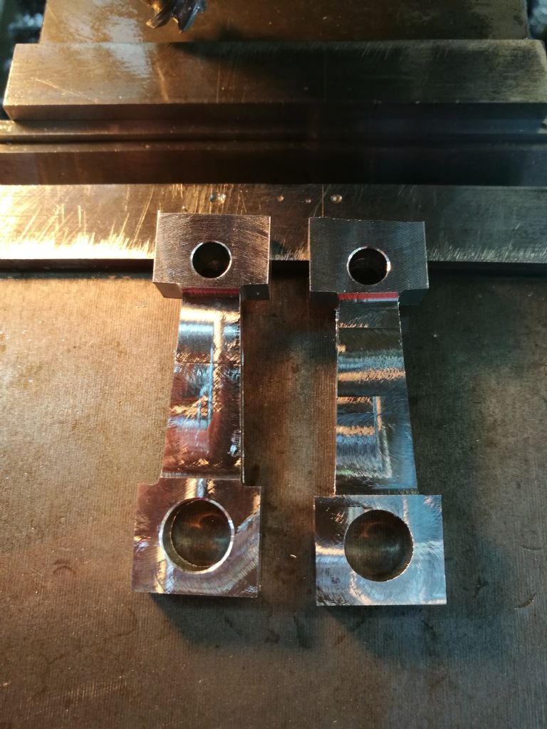

                                            Now we're already to profile the outside
                                            conrods ready to profile
                                            Now I better get back to the shed to finish these off for Mick
                                            cheers for now
                                            Dean

                                                @deanclarke2
                                                OK so on with the show………………. outside profiling under way
                                                next its onto radiusing the little end and the outside flanges of the big end, although as I have a few other conrods to get to this stage before taking the machine vise off it may be a few days before more swarf is made from these blanks.
                                                Cheers
                                                for now
                                                Dean
